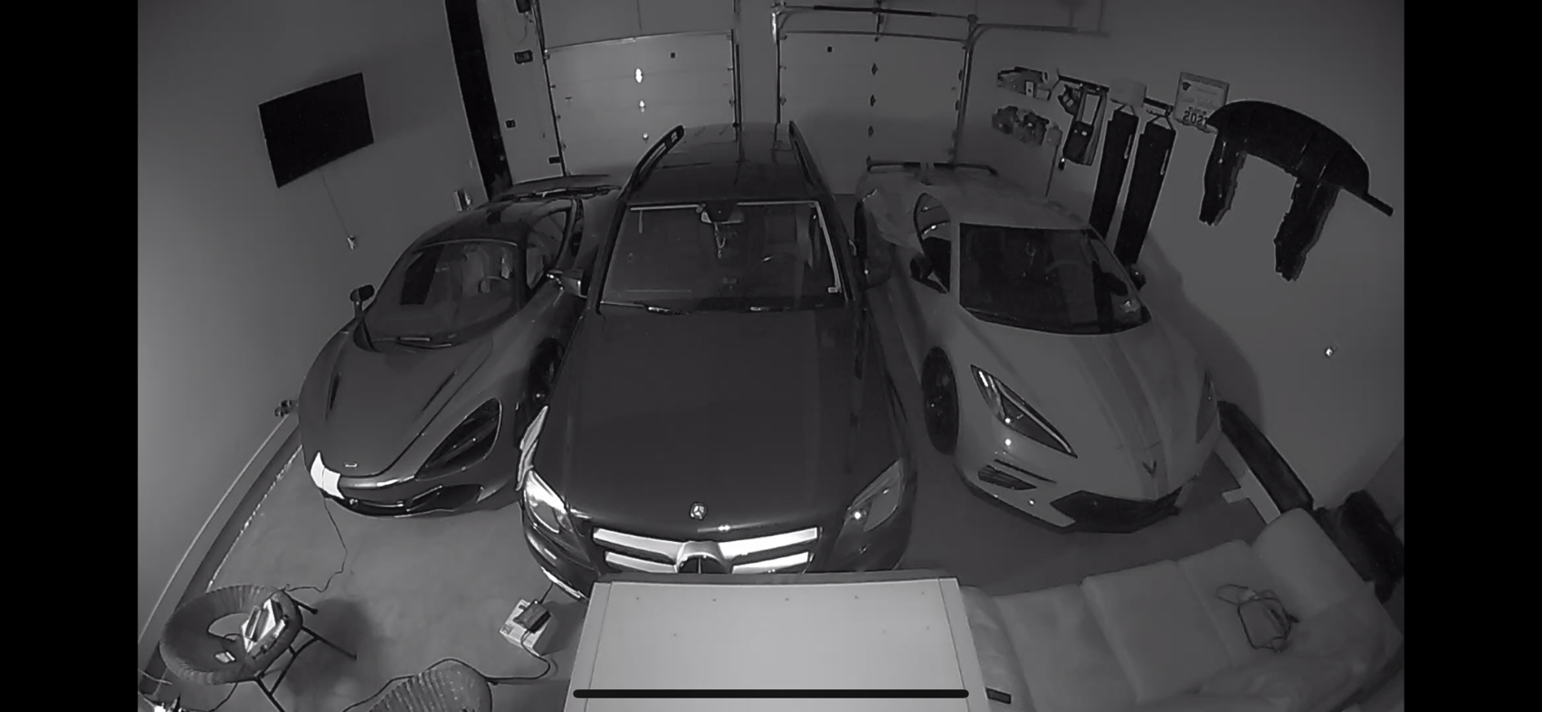

Since it's not my daily. Anybody tried a battery tender?Battery tender for GLK350?-photo888.jpg

I just looked at the photo, two of those cars have battery maintainers on them , one is a CTEK, the Vette has what looks like a CTEK on the couch. So why ask
I used an older model weather resistant battery tender and connected the negative and positive terminals to the battery. hopefully that should work. I have it installed in my garage queen 2013 range rover sport L320 HSELux and it worked. Unlike the other two vehicles, it has built in ports for battery tenders that's why the question was asked if it works with MB vehicles too?
