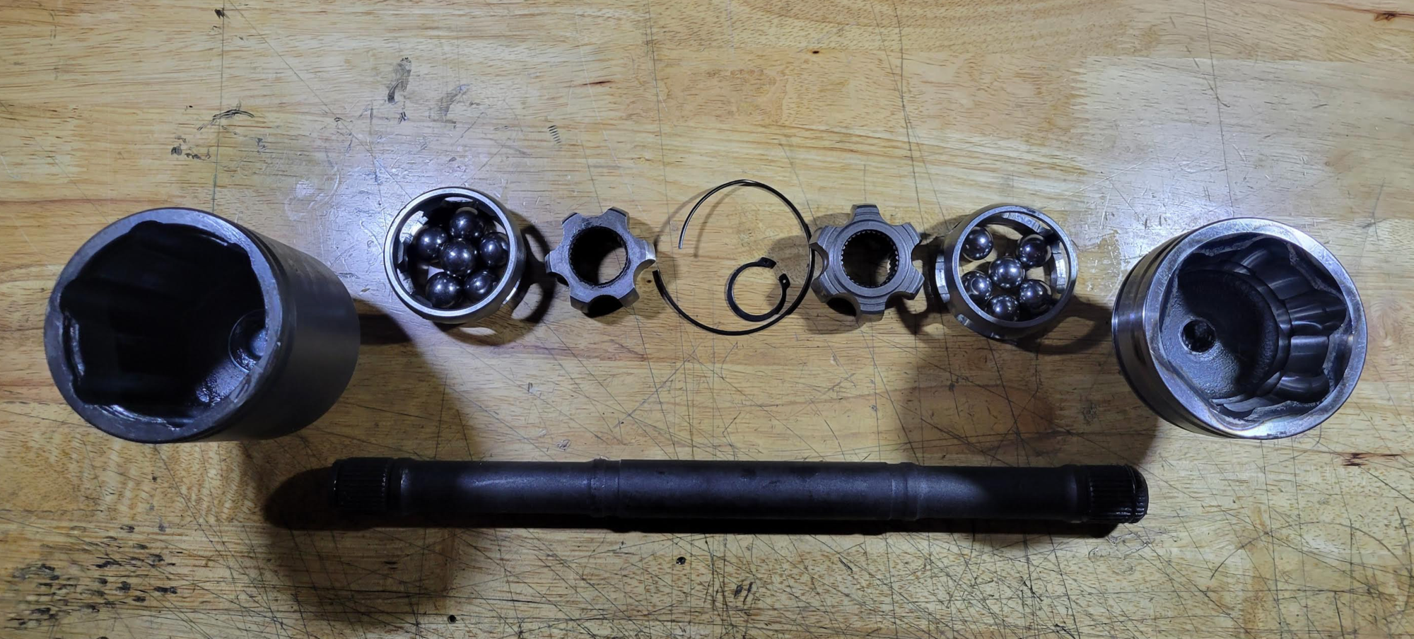

Here's the aftermarket axle. The inner joint is on the left in the pic. Almost looks like they tried to make it look like a tripod joint from the outside...since the cup/tulip looks exactly like the OEM cup. The ball bearings were less than smooth. Weird.

There’s no reason that couldn’t work — “iff” it was made right. From your experience and others, it clearly was junk thrown together to make a buck.
