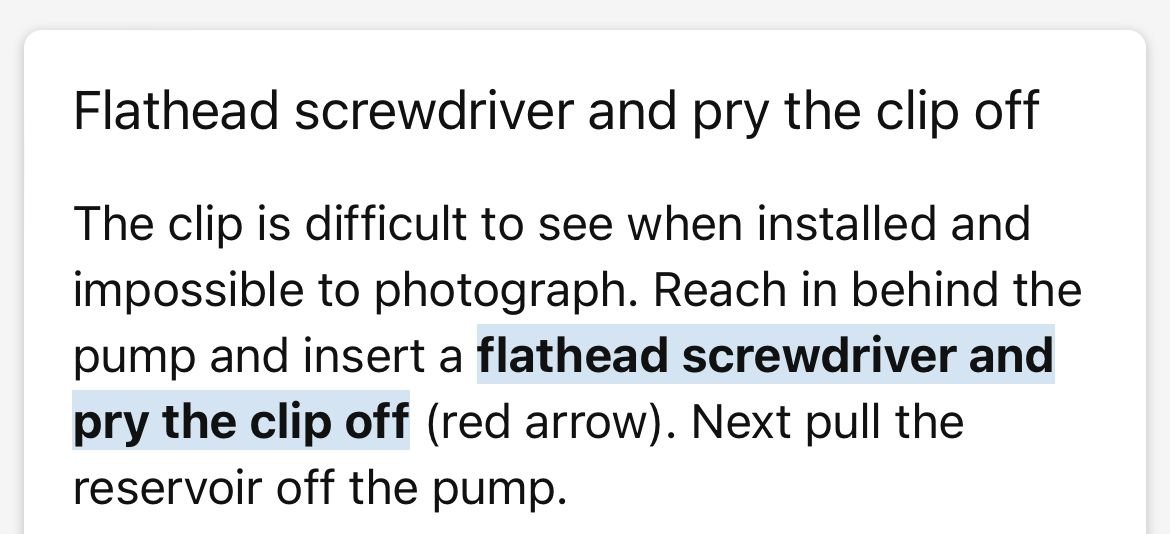

This is my issue
Anyone got a good idea on how to take the clip off the back. Tried for 2 hours, couldn’t find a suitable tool the get it removed, big hands and total lack of room. And I probably have every tool know to man LOL. I will probably make a tool tomorrow. Very frustrating, should be an easy job.
Thanks.

I did exactly what your picture said, just took a stubby flathead and pried it off.
