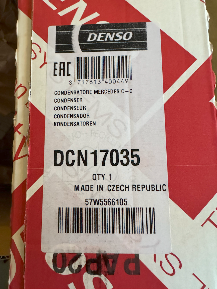

Aftermarket Denso HVAC Condensor does not include sensor

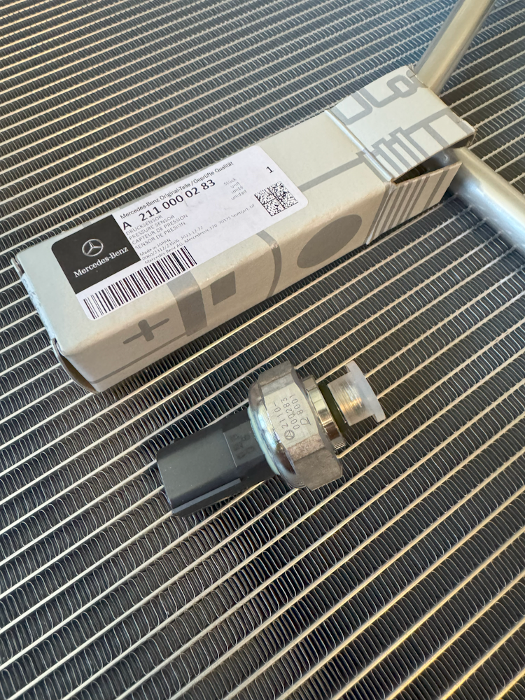

Discovered that none of the air conditioning condensors will include a presure sensor. The sensor itself is alumium alloy with a 27mm hex.

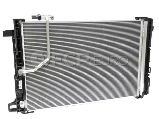

You will see some retailers have product pictures with the A2110000283 sensor attached. The sensor is still utilized on the majority of current production mercedes; so sourcing one is fairly easy and quick.

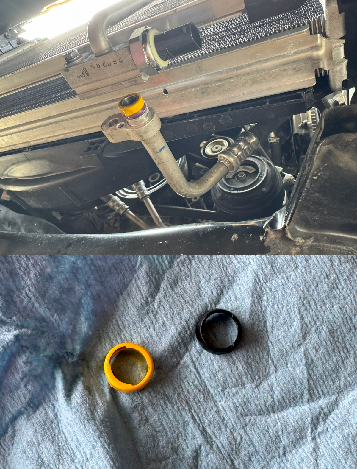

I got everything installed. Pretty easy once you have done the radiator. Took me just shy of one hour. I took it to my independant to get the refrigerant purged first.
