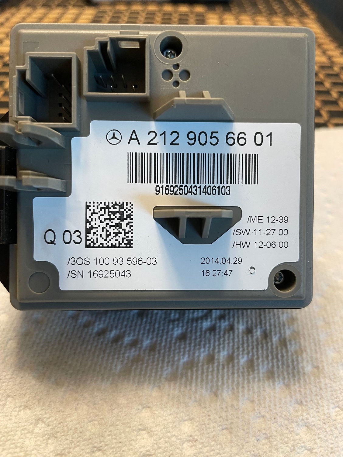

I found a bit of time to look into the issue. I tried several times to duplicate the issue by banging the dash near the ignition switch but the problem would not occur. I scanned for codes with my XTool D7S and found that I had error codes for driverès door lock actuator and rear hatch actuator. The number of codes seems to correlate to the number of times the car has shifted into park. There were no door or hatch open indications on the instrument cluster for any of these incidents. I decided to remove the EIS just to see if there was anything obvious and to at least clean it. It was way easier than I thought. Just remove the wood trim panels where the air vents are, then remove the plastic trim surrounding the instrument cluster. There is a hole below this trim where the EIS can be removed. The connectors are a bit hard to remove and reconnect but not crazy.
Again, I now think my problem is a door lock issue. The next time it occurs I will pull over and scan it immediately. I already cleared all the codes and they have not reappeared yet.
