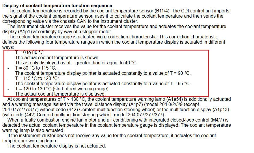

As we know these cars do not show actual coolant temp once it gets to operating temps. From 96c-116c the gauge will actually show 95c (mine seems to be around 90c), Mercedes reasoning is to not worry the driver about the car over heating.
To see if the thermostat is operating I will watch the temp gauge and look for it to hit 95c, then I will notice it drop down to 90c. To me this tells me the thermostat is opening.

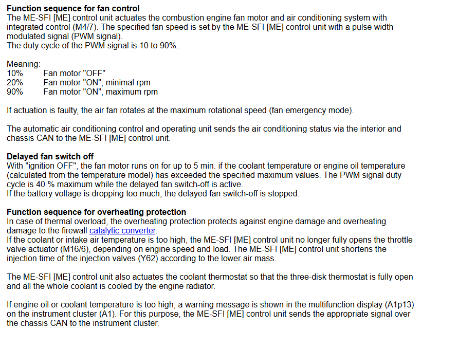

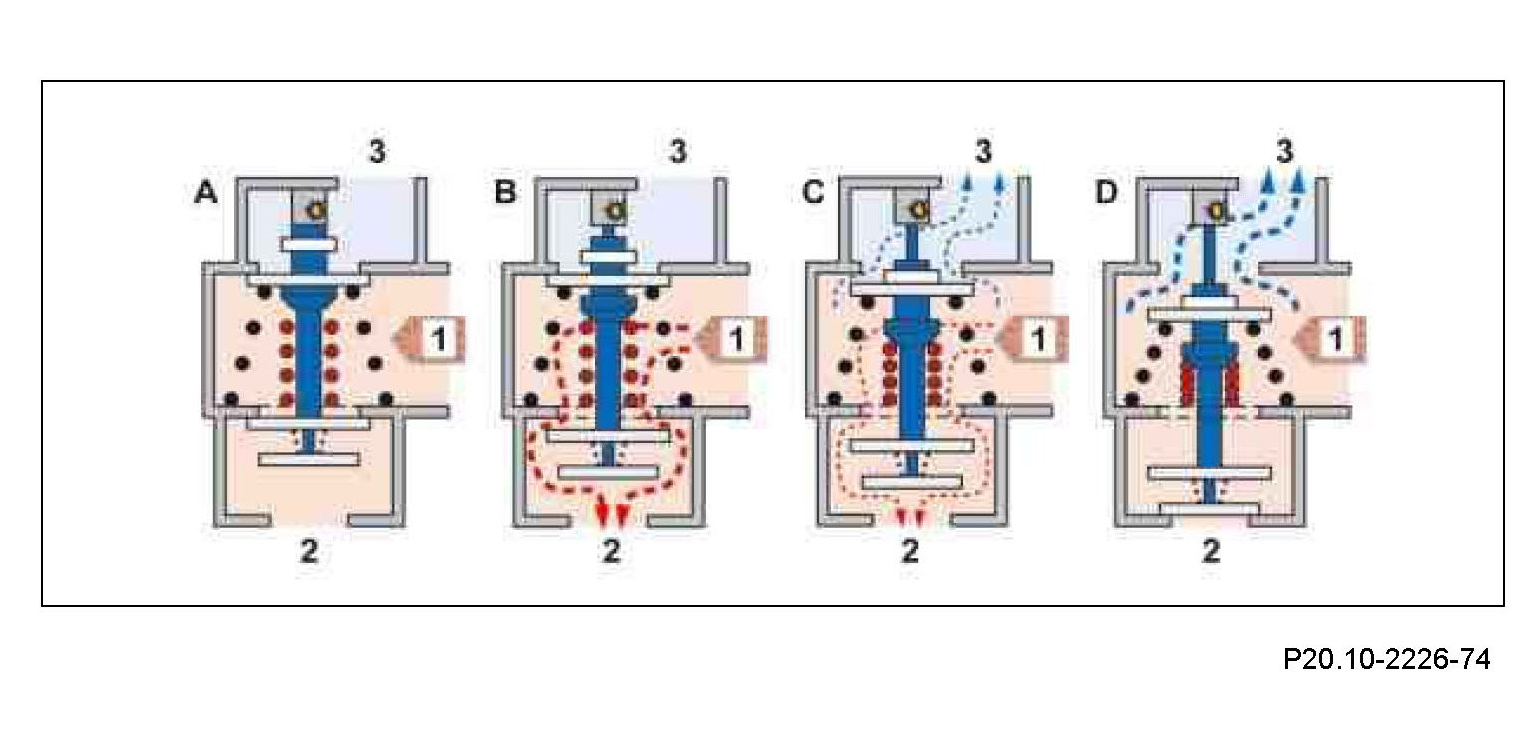

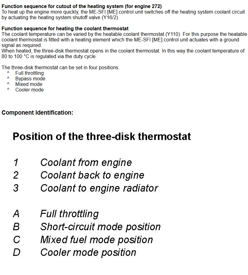

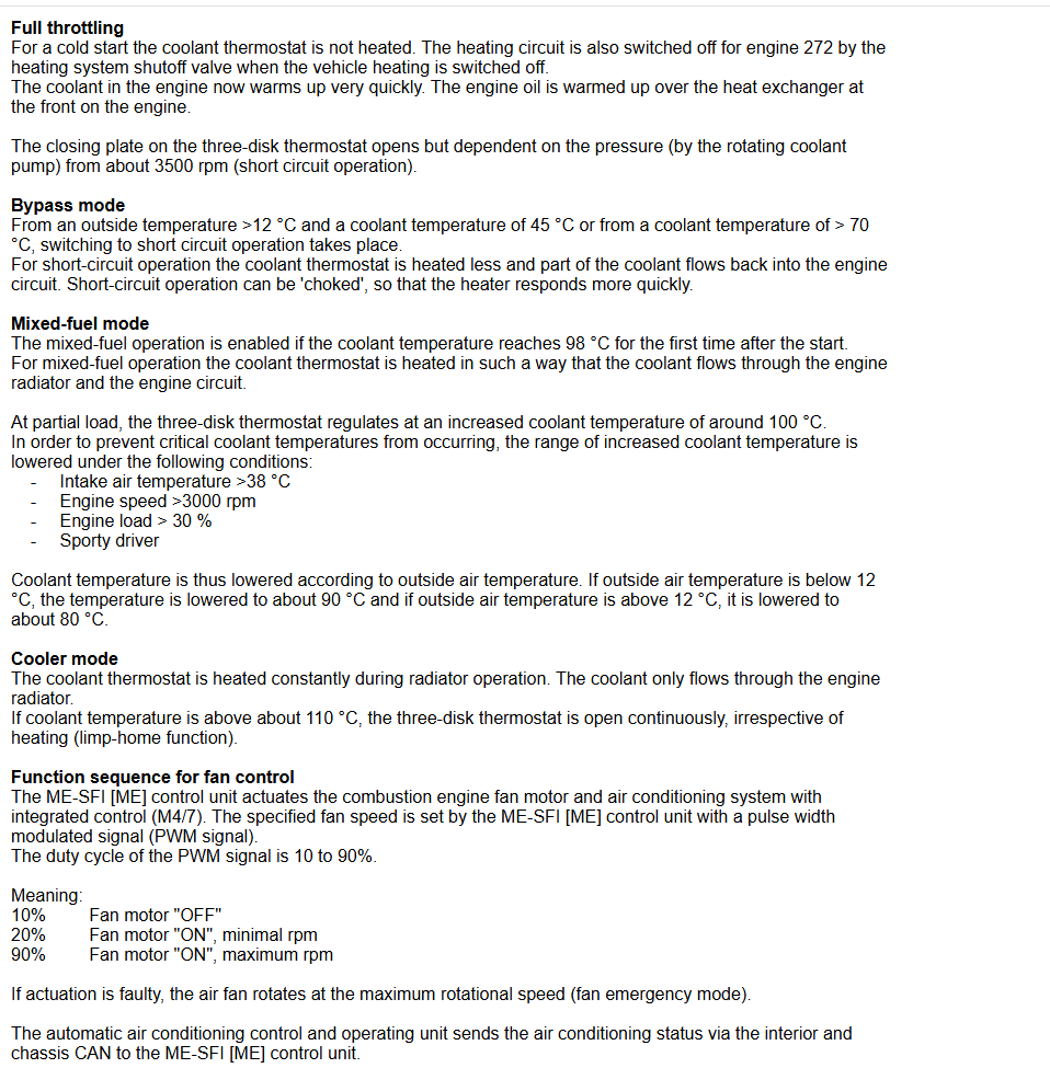

I like to read thru the manual to try and see how it is meant to function.
Found some info in Instrument panel, Gauges and Warning Indicators > Description and operation > Display Operating Conditions, Functions : https://charm.li/Mercedes%20Benz/201...d%20Diagnosis/
Found below under Powertrain Management > Description and Operation > Thermal Management, Function.
Below is under Engine, Cooling and exhaust > Cooling System > Thermostat.
