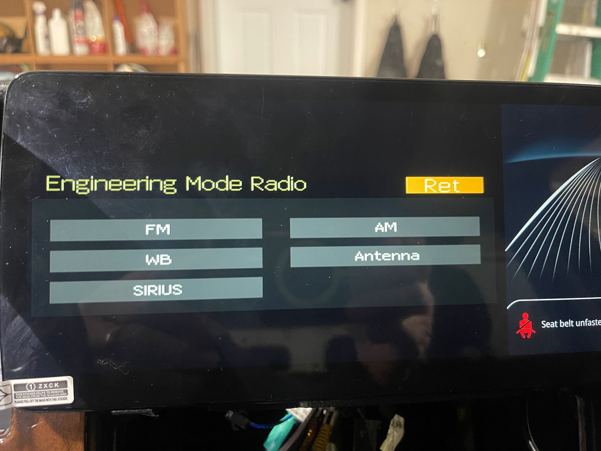

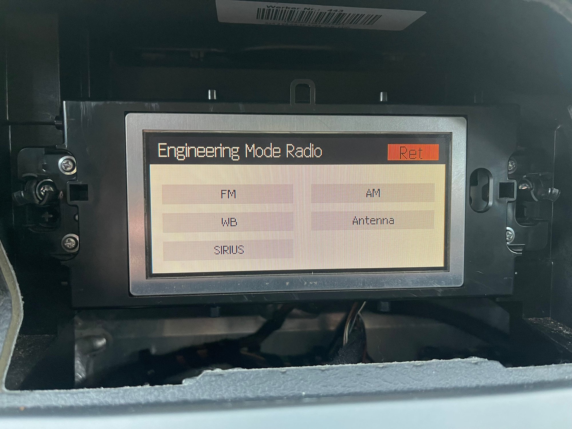

My engineering menu does’t have any greyed out parts of any kind. Here’s the display in the big screen, which matches what is displayed on the small screen.
My working theory is that these cars either came with the aux option, or Serious xm. Mine has the lifetime serious xm, which is nice to have, but the car is driven by my 16yo daughter who could not care less about anything other than streaming.
Best option may be a “ye old auction site” head unit.

Is that the menu when you press the hang up button, # button and 1 button simultaneously?

That screen is after entering the radio part of the engineering screen (hang up, #, 1). This is where others see the aux option.

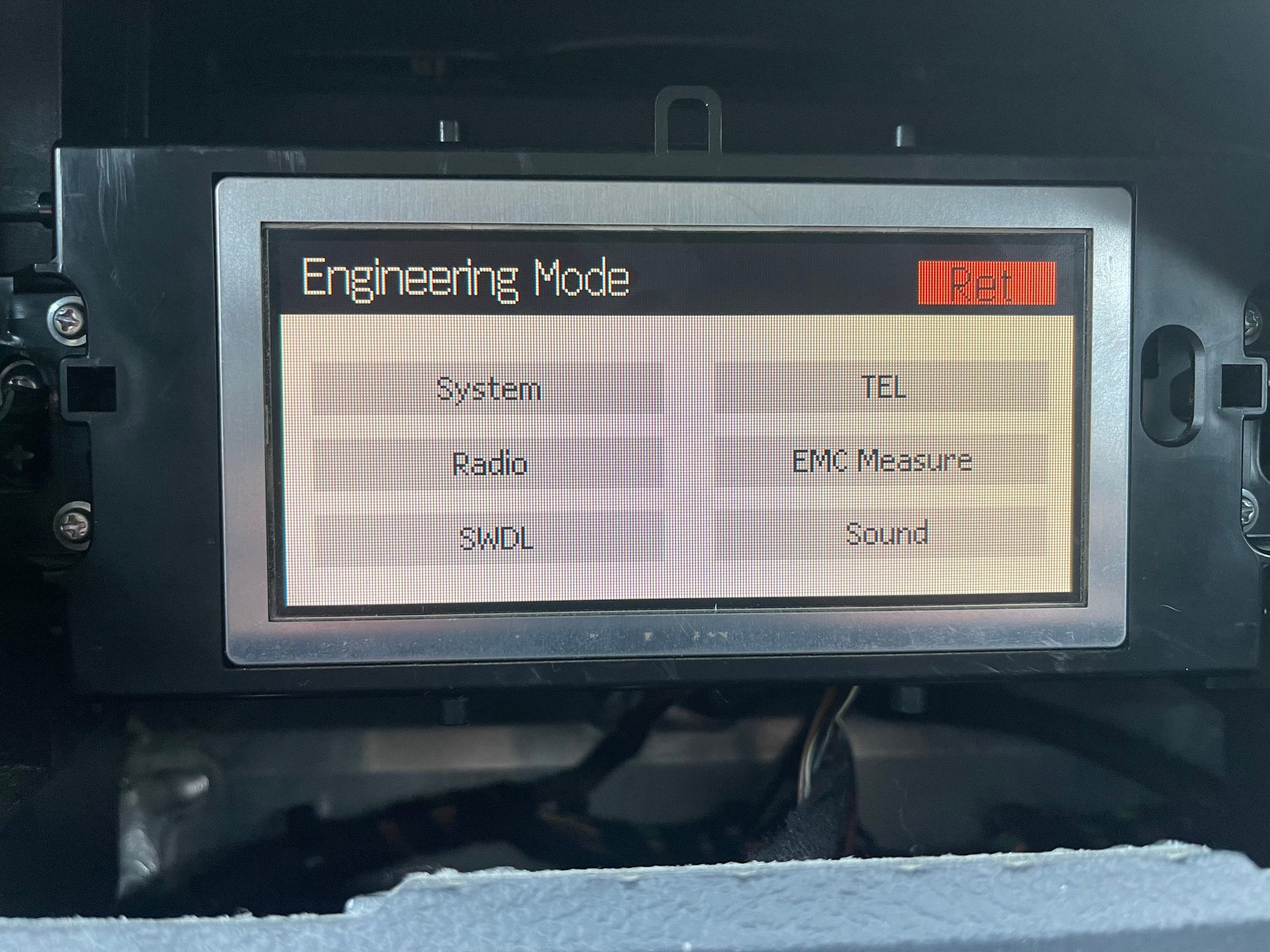

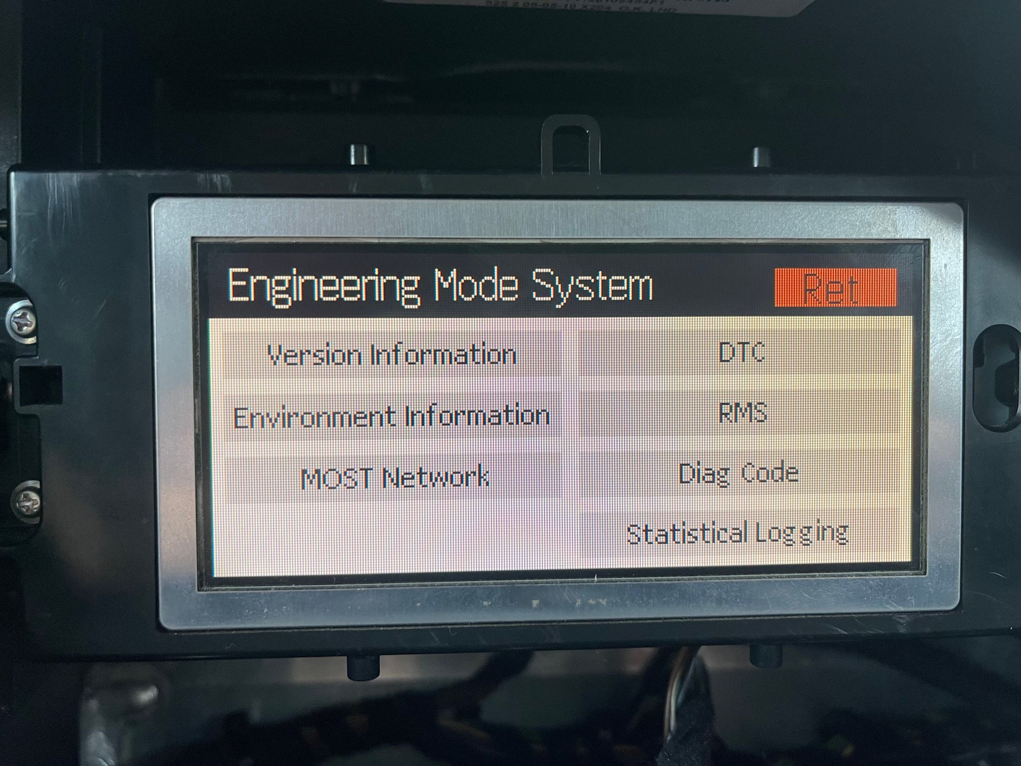

This is the small screen in engineering mode
I have a new head unit coming from fleabay, so I’ll find out soon enough if my theory is correct.

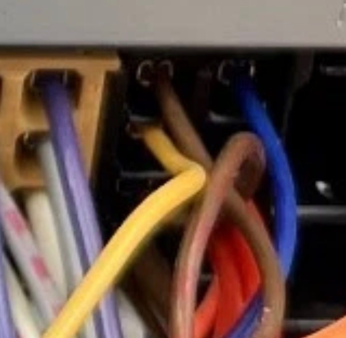

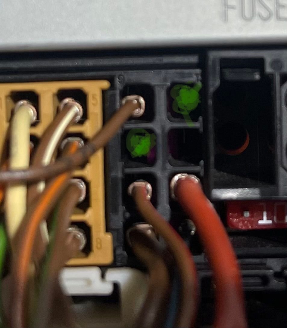

I received the used head unit and it was a bust. Like my original, did not have the aux option. It did however seem to have the free SiriusXM. This forced a deeper dive into the head units and wiring. I found a wiring diagram online and identified the aux R&L inputs. Sure enough my wiring harness had nothing in these positions. The first pic below shows the open positions (poorly highlighted), The second shows another harness with wires in the aux R&L input positions (blue and yellow)
Fortunately some scrappers just cut harnesses rather than disconnecting them at the head unit. I found another used unit on the auction site that had wires in those positions, and bought it. This unit should arrive today.

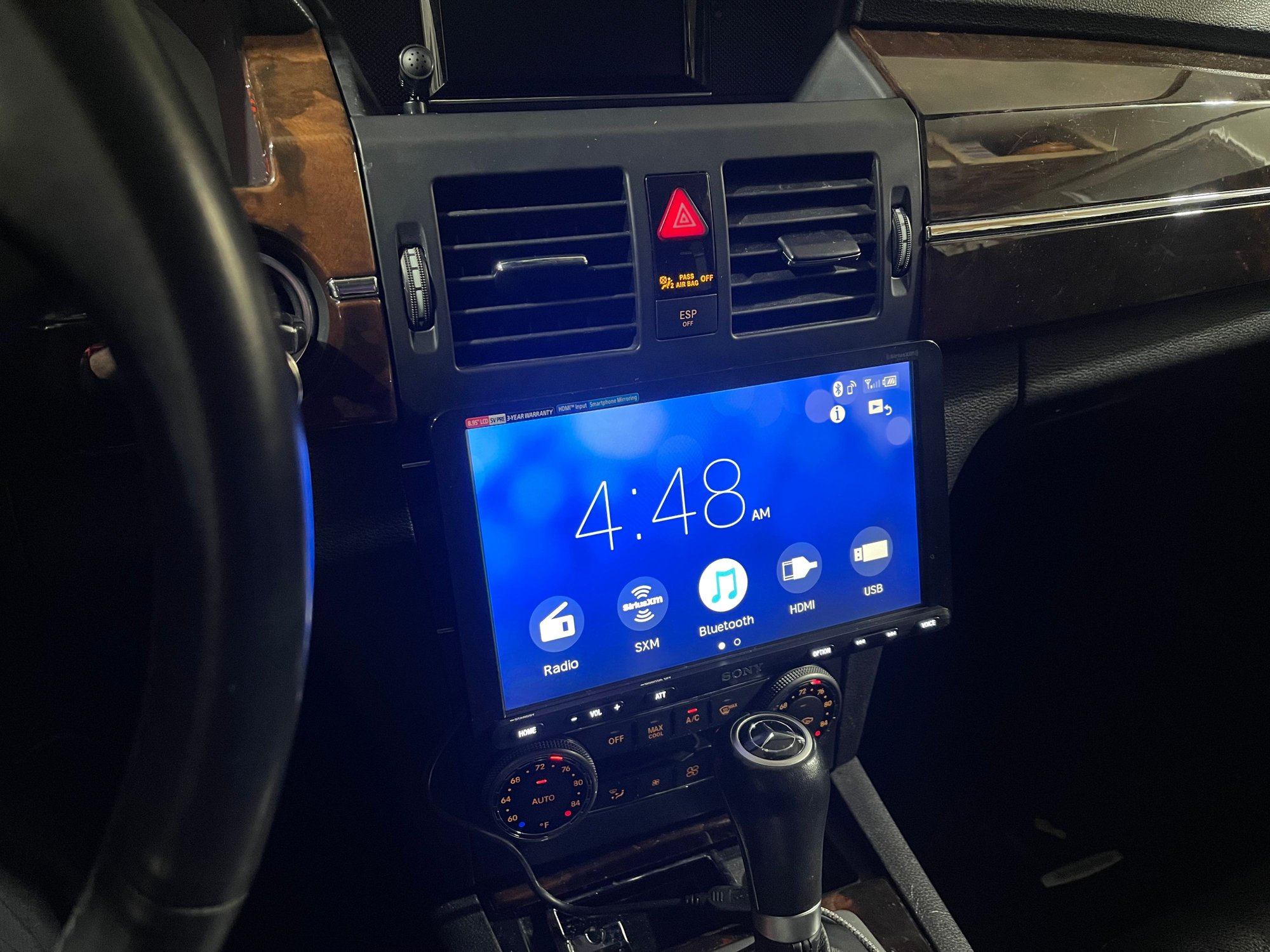

Well, I had to abandon the Android screen. I was not able to activate aux, even with a second new used head unit. I was mistaken on the aux wires that I previously posted. Basically, ignore much of my posts above.
Here’s how the external amp works: head unit sends digital signal to amplifier via fiber optics cable. Signal is amplified, then sent back to head unit and converted to analog, then out to speakers.
I bought a Sony head unit with a floating touch screen, and abandoned the NTG4.0 system. The Sony is a single DIN. I took all the guts out of the MB head unit, and put the Sony unit where the CD player was.
I wish I could get the android screen to work, but this is pretty cool too.
My 16yo daughter is happy, I’m happy, and that’s a win.
