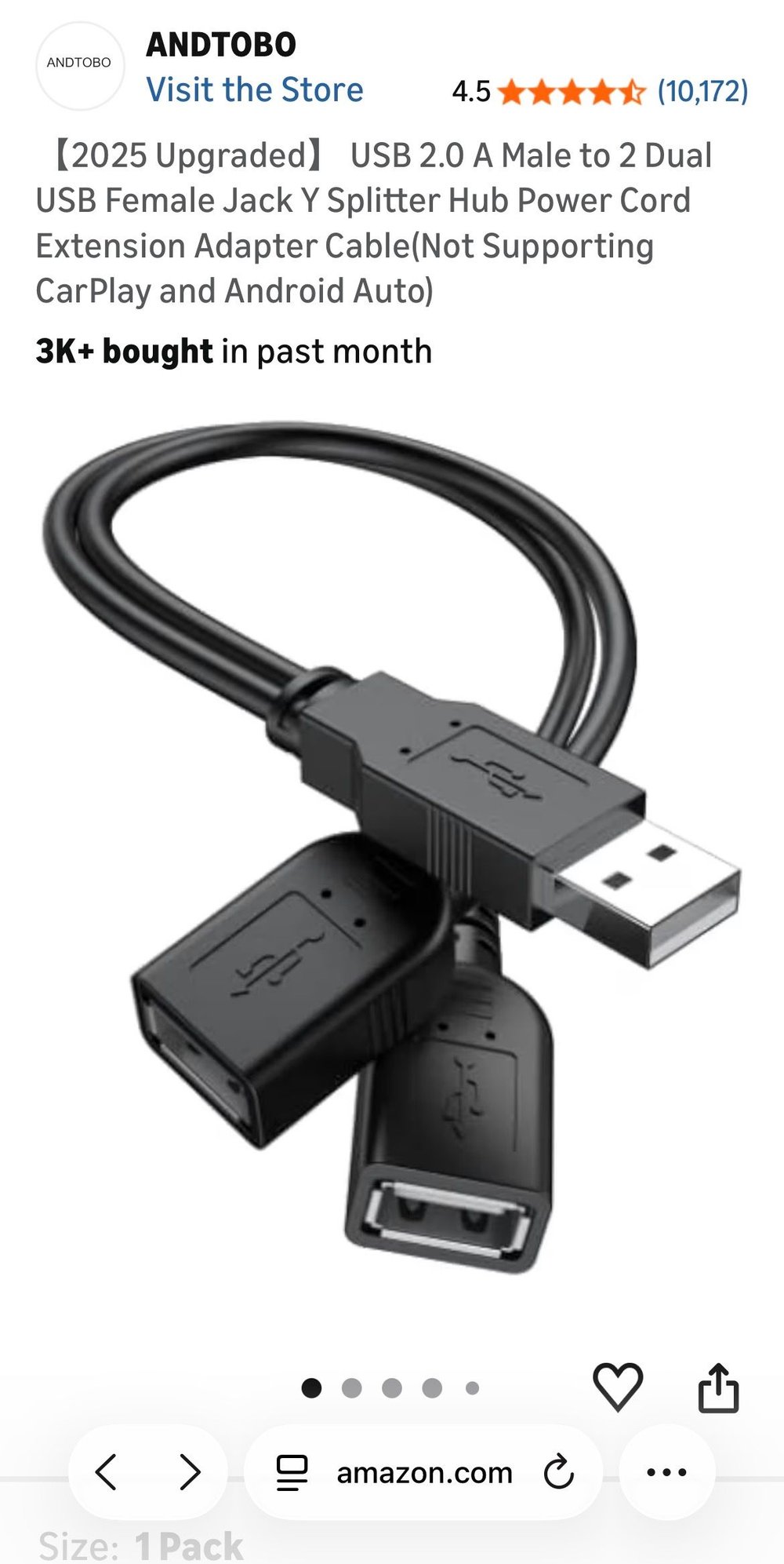

Question: can the entertainment system find the thumb drive with songs if I buy a two into one USB connection?
As you can see with the pictures below, I have the Mercedes-Benz connection which goes to 64 pin then to iPhone connection and it barely keeps up with charging. I bought an aftermarket cheapie on Amazon and it barely was any better. Could I purchase one of those adapters Male USB that goes into two female USB‘s and connect in the thumb drive picture below as well as a regular apple USB to fire wire connector and still be able to access the thumb drive as well as have a better charging rate instead of using that funky Mercedes-Benz only connector??
[img alt="To the far left standard USB thumb drive connection. To the right, the Mercedes-Benz connection going to adapter to the I
phone"]https://cimg3.ibsrv.net/gimg/www.mbworld.org-vbulletin/1560x2000/img_0725_31cbb3c1ceebf86e6185f6b06ac9c71ac54fc2ca. jpeg[/img]
To the far left standard USB thumb drive connection. To the right, the Mercedes-Benz connection going to adapter to the I phone

Again purpose is to get a better charging rate because that Mercedes-Benz only connector barely puts out any charge to the phone and if you’re running Maps or Twitter or anything that use a lot of phone power, the phone barely keeps up and in a long drive it loses power compared to a regular USB connector.

For some reason, it removed my first picture, which is the most important one again here’s what I’m dealing with.

The USB splitter cable shown in the OP's opening post is described as a power cord. It likely has no data conductors. You can charge 2 devices from a single USB port with it, but it's not going to couple 2 media devices into a media player.

Personally, I doubt that "charging" and "music transfer" can happen on a single USB sharing cable.
yeah, that’s exactly what I thought. I did find another one on Amazon where one line is listed as power only. And the other is listed as data and power. I guess I should rephrase a question is anybody else experiencing the same phenomenon where the Mercedes-Benz specific connection for iPhone or iPod does not charge fast enough. I’m assuming since I purchased a different chords for it one being the original Mercedes-Benz product and the aftermarket that this is just the way the connection is because it’s 64. It was designed to data transfer and power a iPod, whose power requirements are much less than a iPhone. Would that be a correct statement??

USB connections must meet specific standards. For USB1.0/2.0 it's (maximum) 5 volts and 500mA (2.5 Watts). Another complication is the device you're trying to charge has to "request" the maximum current and won't automatically receive it. Otherwise, it might only get 100mA. USB 3.0 can deliver a variety of current levels from 0.15 to 0.9mA (4.5 Watts).
Newer specs can deliver higher voltages and current.

You make an interesting point here. If the OP is using a 2 conductor cable (power only), there's no way for the attached device to request a higher charge current, so only the minimum is supplied. There are USB current test tools available (
Amazon Amazon
) that provide a way to check charging current.
