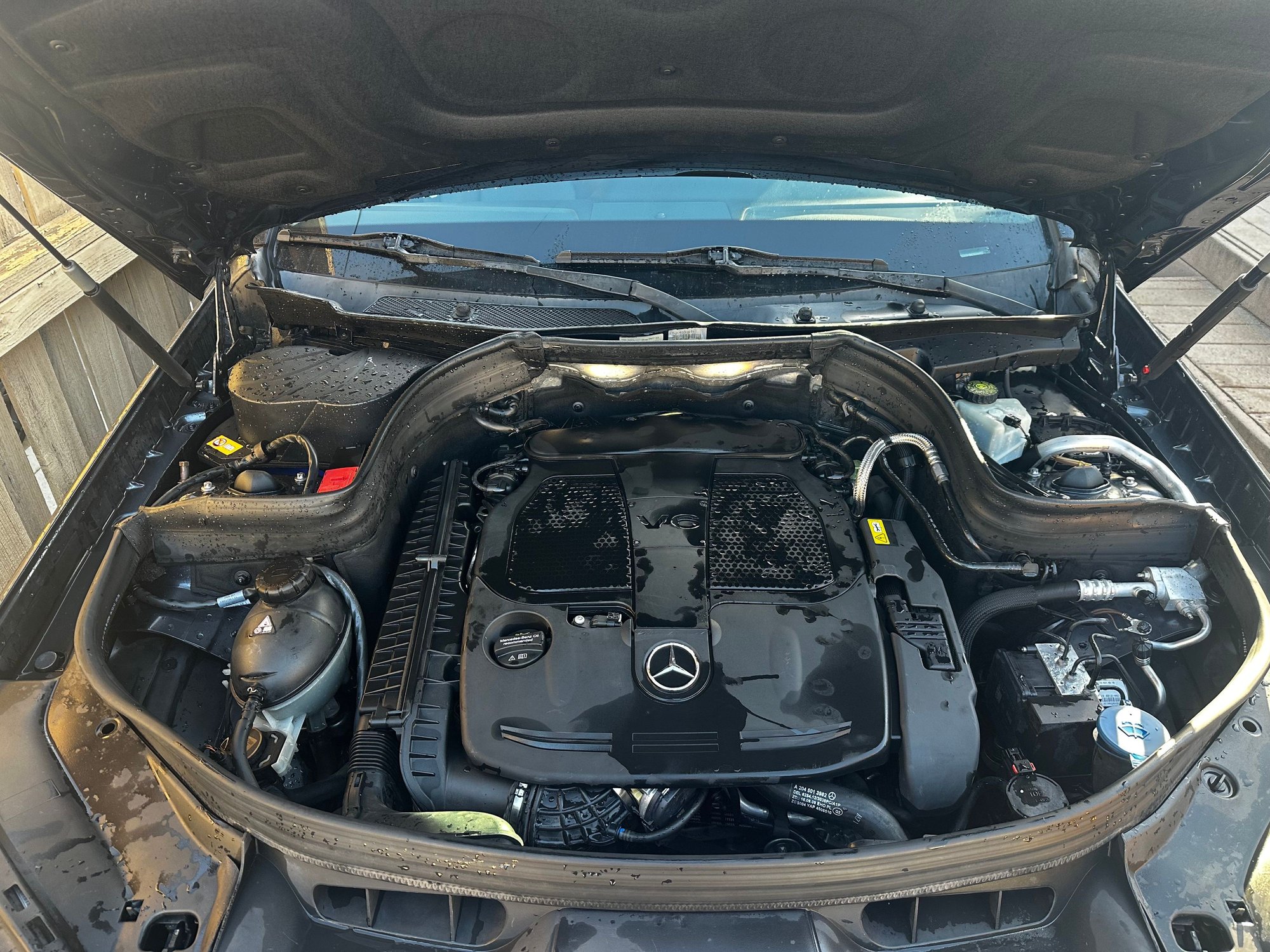

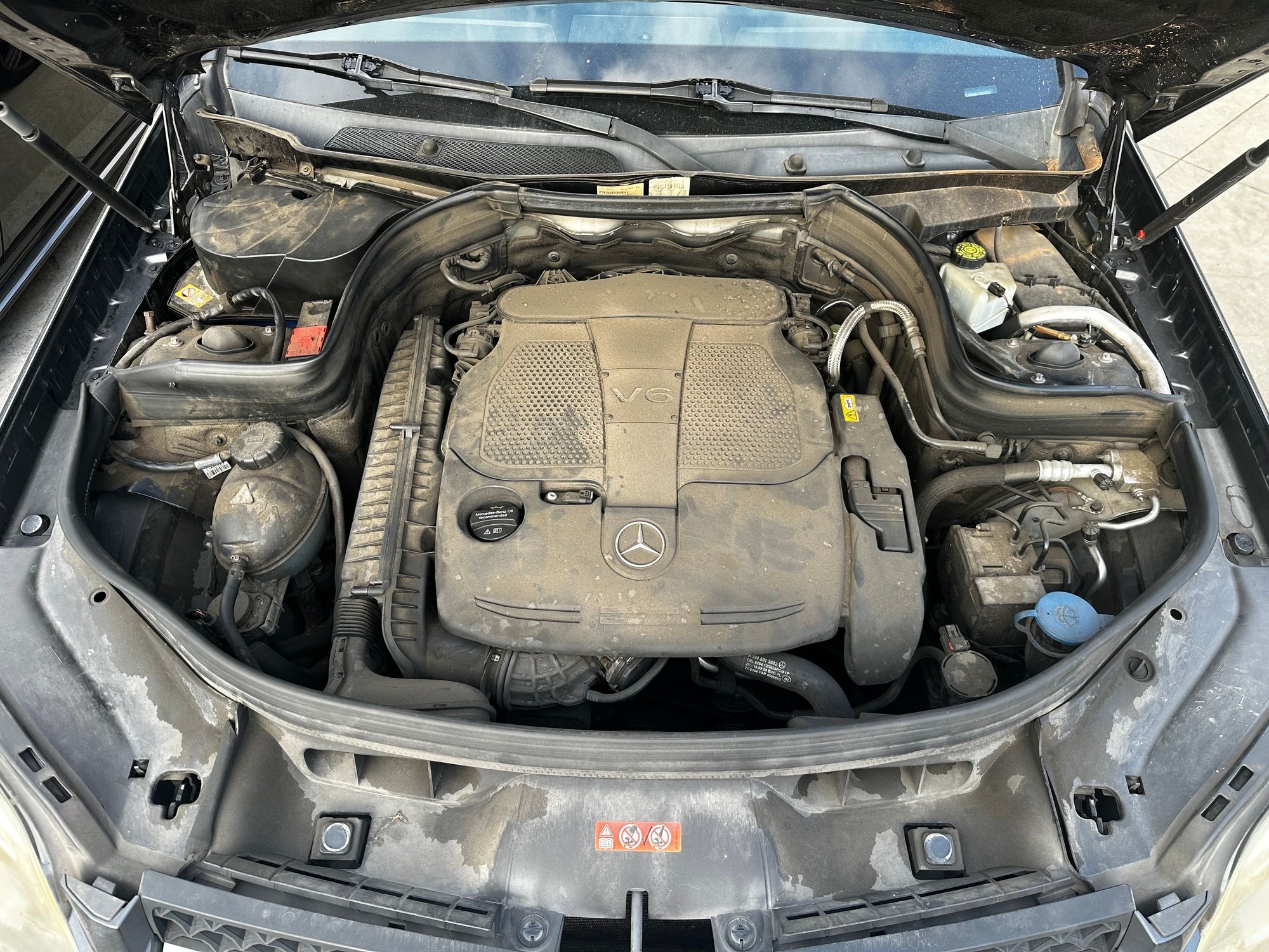

Also, the engine compartment had not been cleaned in several years, so I cleaned it VERY thoroughly with Sonax engine cleaner and a ton of elbow grease. Including the deep cleaning, I spent about nine hours over two days to complete this work.
Dont look too close, it is pretty gross in here.
Don't look too close, it is pretty gross in here.
Much better!
Much better!
