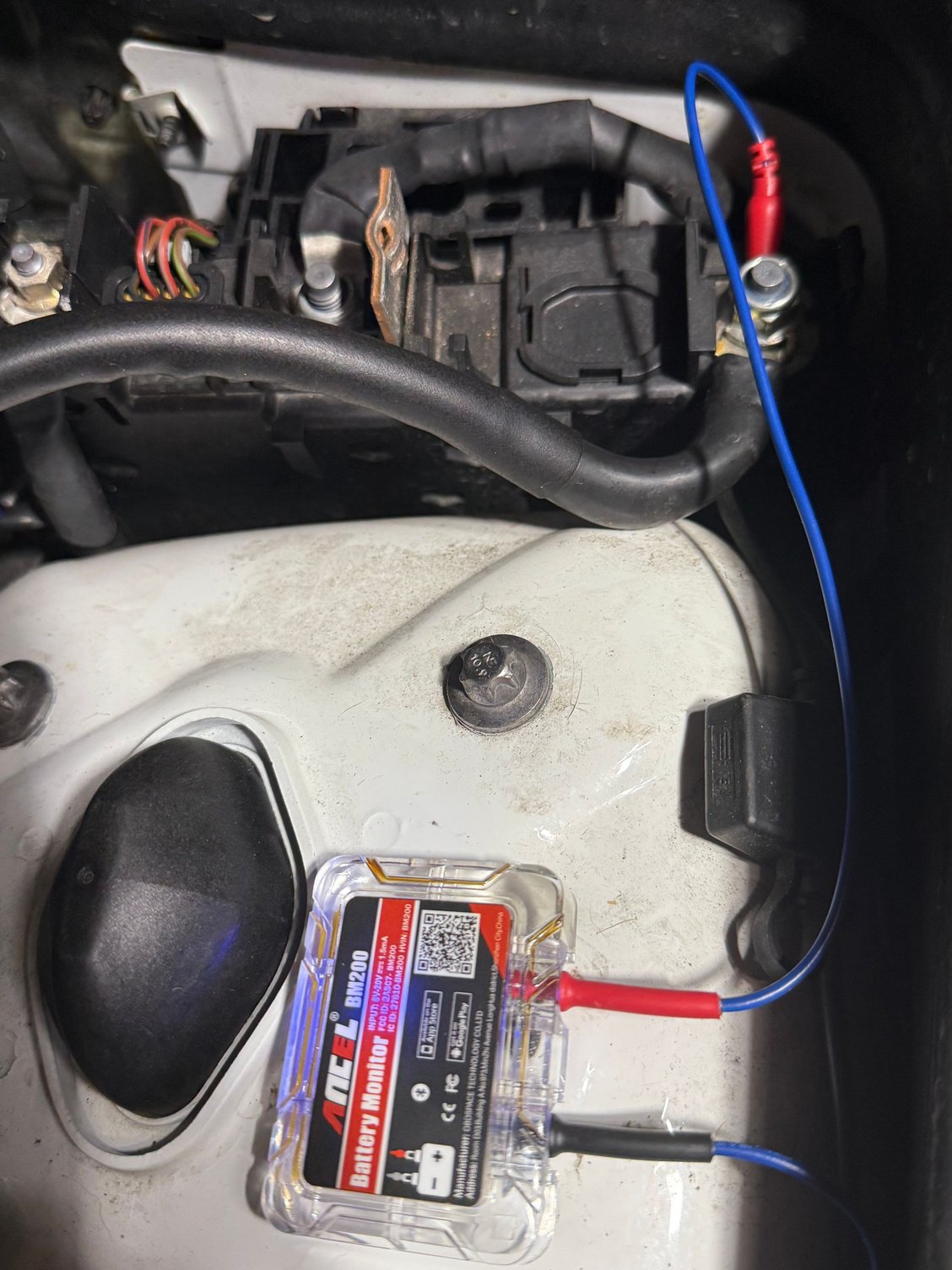

It works , easy instal on negative charge post and terminal block . range is almost zero with hood closed . But open and car in garage I can get a reading 40 ft away inside when standing next to window .

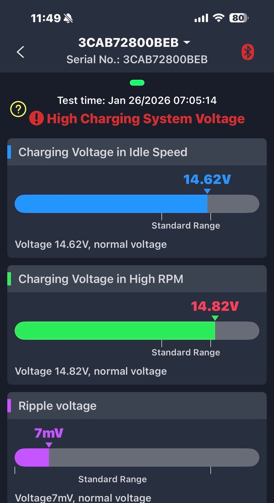

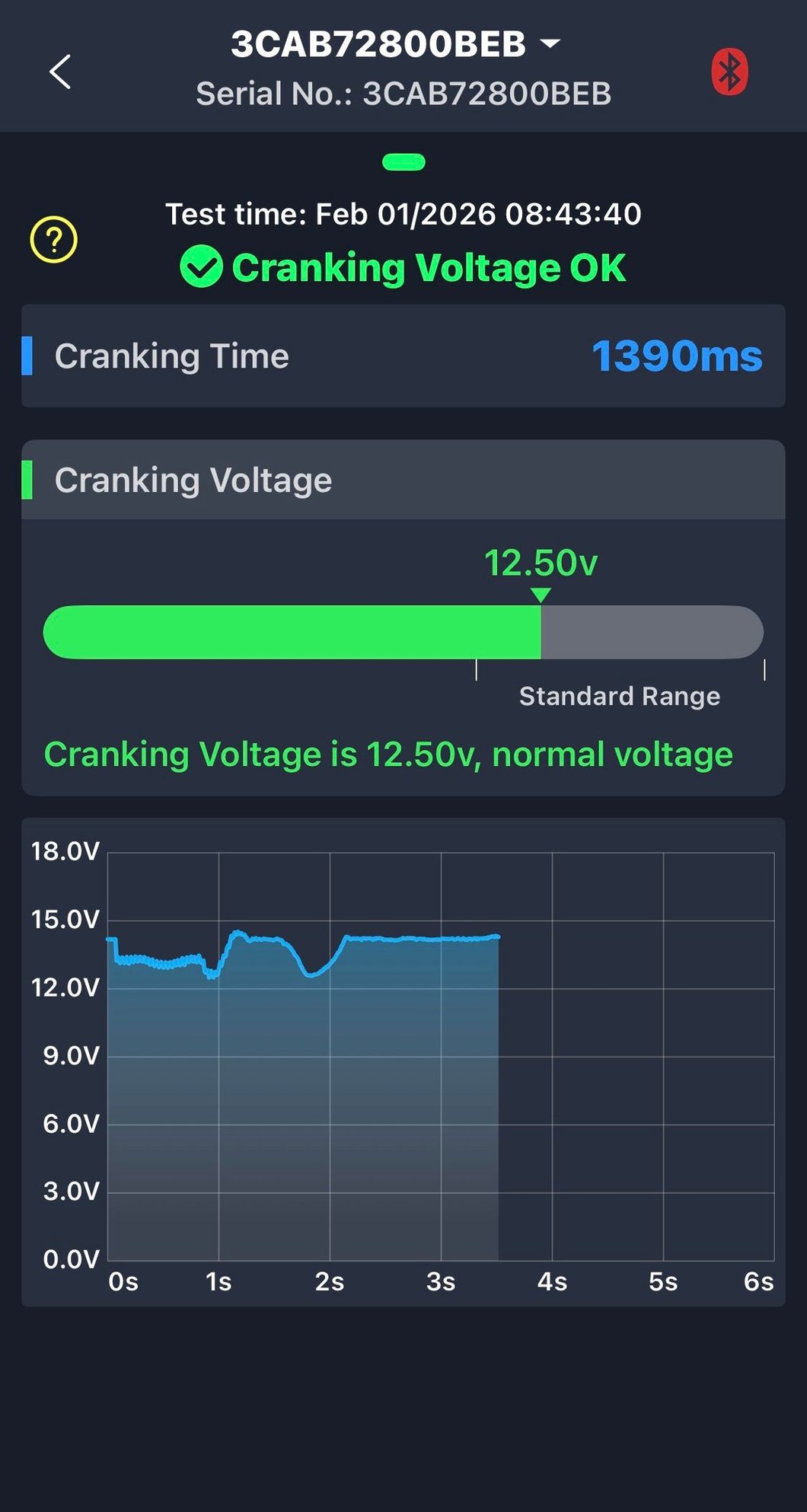

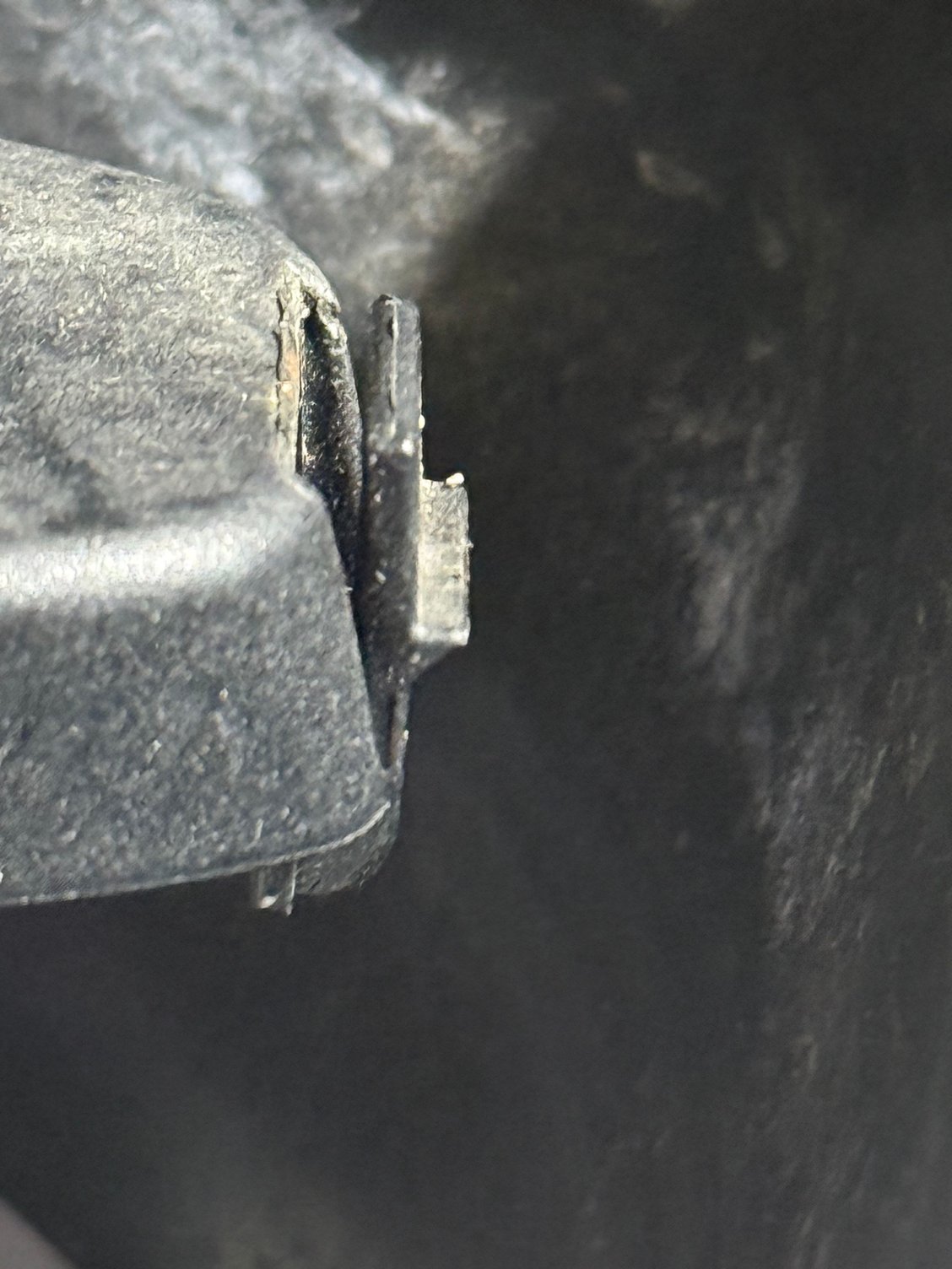

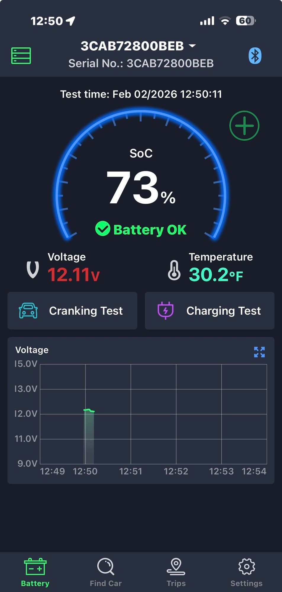

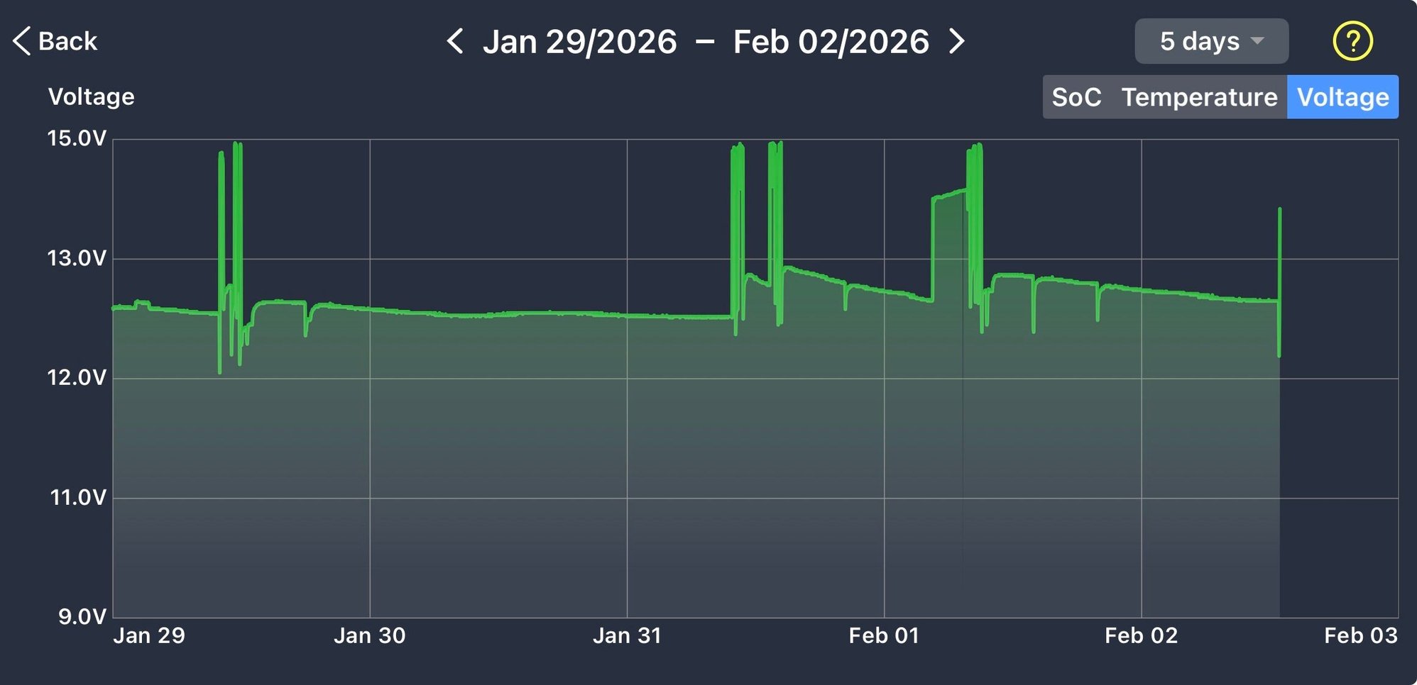

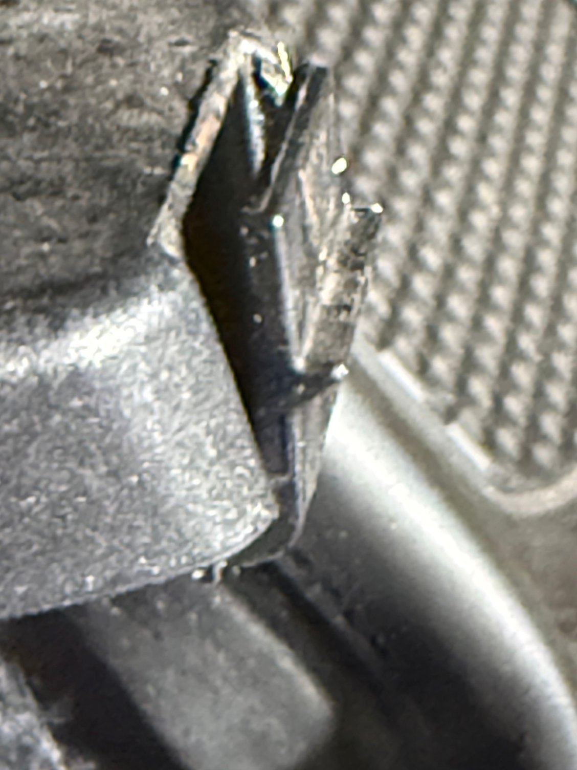

Ancel BM 200. It monitors voltage , SOC, the regulator Ripple, charge voltage , starter draw , . For 26$ you can’t go wrong . It’s easier to hook up on the negative charge post and inside the terminal block since wire are short and the battery is in back. My readings , and a photo of the charge block clip so you don’t break it trying to figure it out 😂
