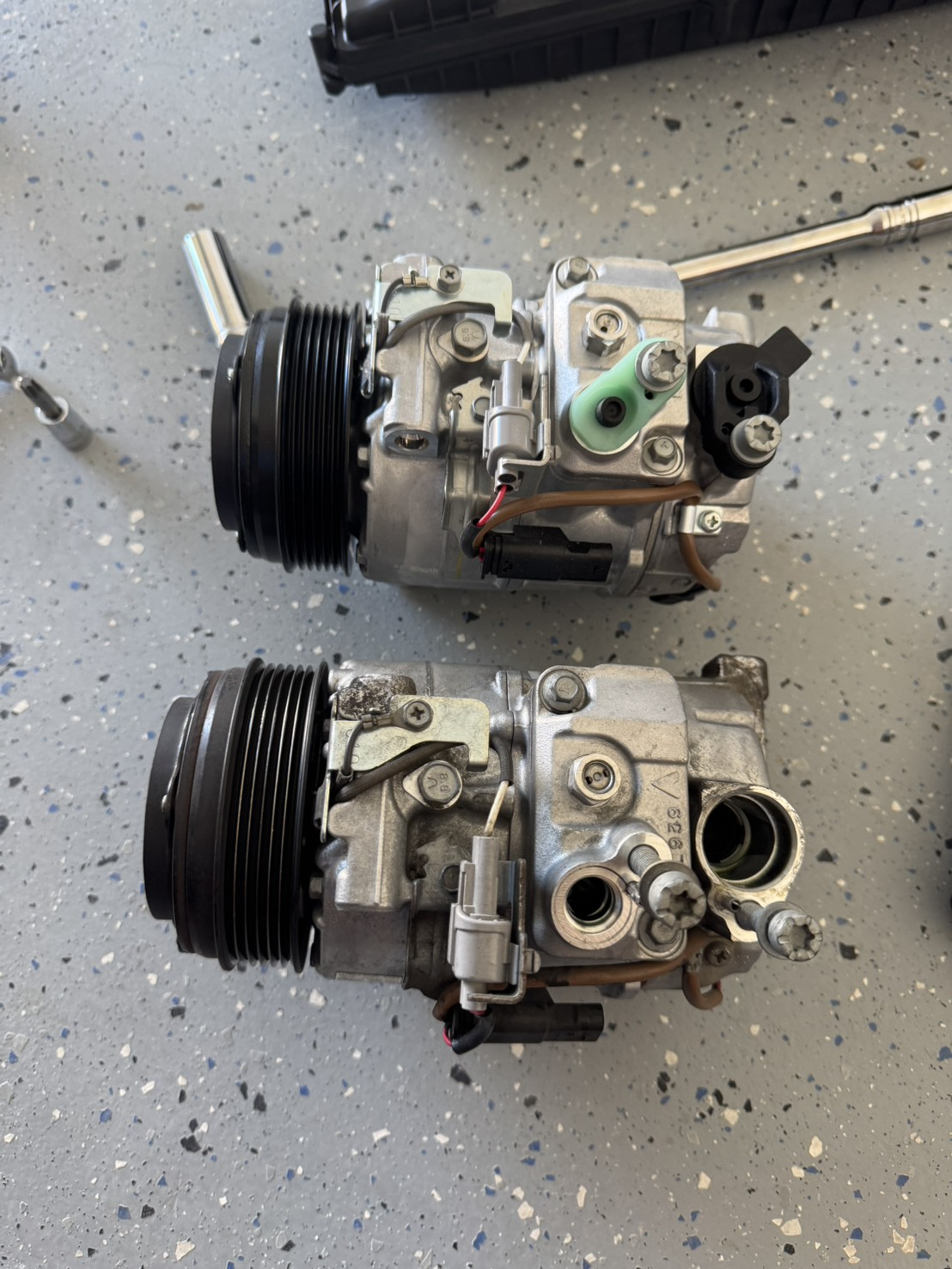

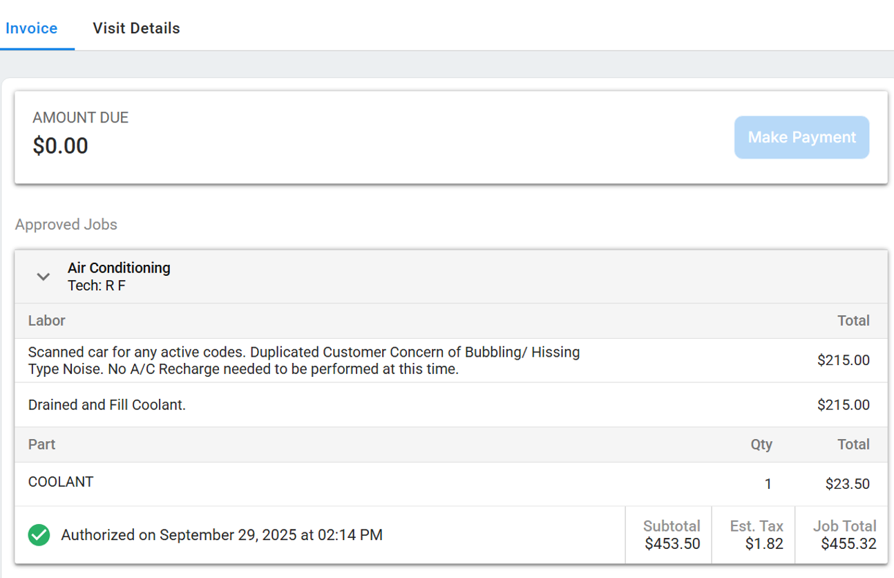

I had this problem develop last year and it was intermittent (hard to duplicate). Took it to two different repair shops and they couldn't replicate the noise.
I was living with the noise since it only appeared maybe twice a month. February 2026 I finally had the time to replace my aircon compressor 000-830-26-00 and it appears to resolved the noise issue. Current milage is 140,000 miles (225,300 kilometers). I had another shop discharge the refrigerant, I spent about 30 minutes removing the compressor myself, and finally went back to the shop to recharge properly.
