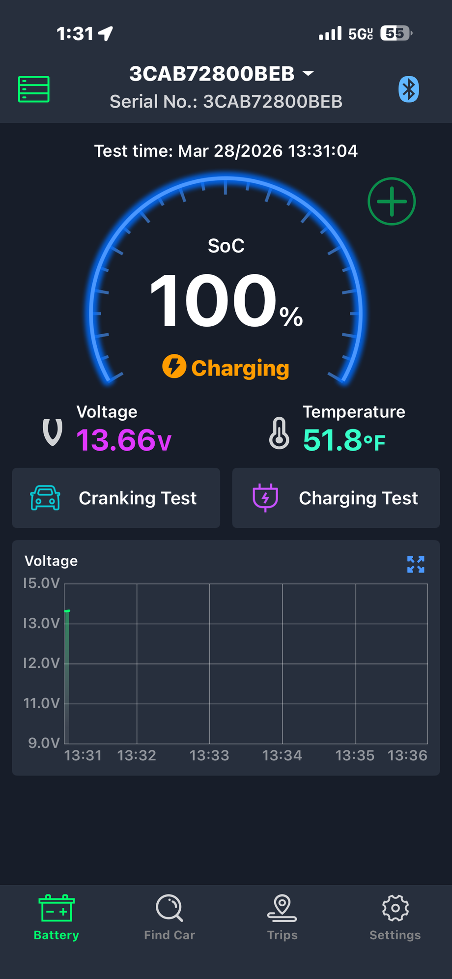

Is it a AGM or regular battery , non AGM will corrode the terminals in a year requiring removal of cables and cleaning connections. What’s voltage ? What is voltage went someone else cranks starter ?
an Ancel BM 200 for 25$ is a great add on for anyone , it will show you most everything on the phone app

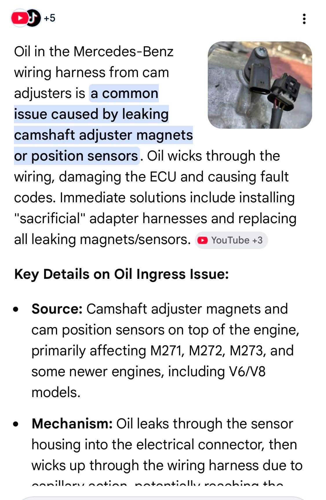

With the Ancel bm200 you will see constant charge voltage and battery state of charge and battery voltage at the same time . It might give advance notice of what’s about to happen . It could be alot of things . How many miles ? Check the plug connection to the cam adjusters for oil in the harness . I have it at 90000m it can and will ruin the computer . It’s a common mb issue on high mile mb .
