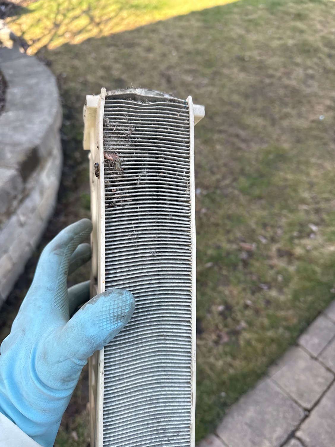

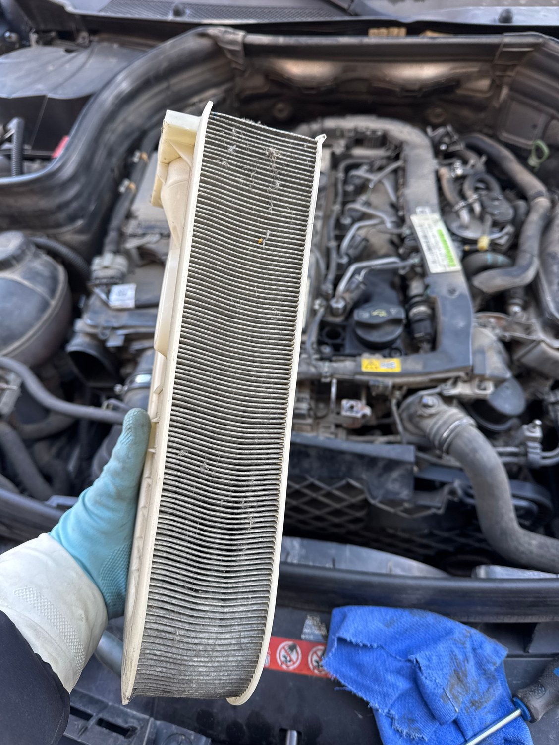

Check the Air box and found that the air filter was dirty dirtier than I like it. Could this be what’s causing the Matt and the bypass for the EGR here’s a picture thanks guys.

Old Apr 11, 2026 | 12:59 PM
kissdaring's Avatar
Joined: Apr 2026
Posts: 34

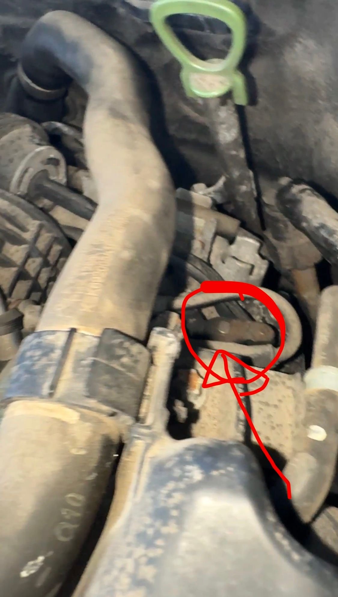

thanks. I removed the MAF from a friends glk while he had my MAF his was running fine without adaptions and mine with his same codes “ no change” so I don’t believe it’s an adaptation issue rather something else. I will run an adaptation later today however I suspect I will return with same results.
Additionally I did find a small bit of smoke here
wheee the egr intake actuator is. Not sure If it matters. It was really small amount coming out here that lever is.
