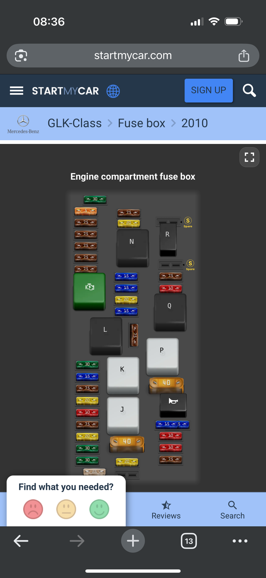

Okay guy long short story I have lose few of the relays when I was working on the car the letters that are in the relays that I have lose it’s L R and Q
please if someone one have glk220 from 2010 diesel and have the time to send me the oem numbers for the relays that I can go to buy them

I don't know if this will help. I have a 2014 GLK250. The panel looks the same as yours. The "L" position is empty, so maybe you didn't loose that one. "Q" is A 002 542 74 19 and "R" is A 002 542 8319
HTH
