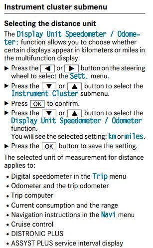

Try this:

Originally Posted by 350MH83
Try this:
Hi 350MH83
Dig speedo [mph] is to replace temp display only on the permanent display area (top and narrow zone, next to dig clock).
I just spoke to my dealer regarding my topic. I got feedback that it was not changeable for the multicountry purpose. Manufactory has to keep the both of km and mile display as possible in different counties. I understand that issue, in euro, Nth America, it is ok. But, it is useless here, Australia, one country on the one continent surround by water.
