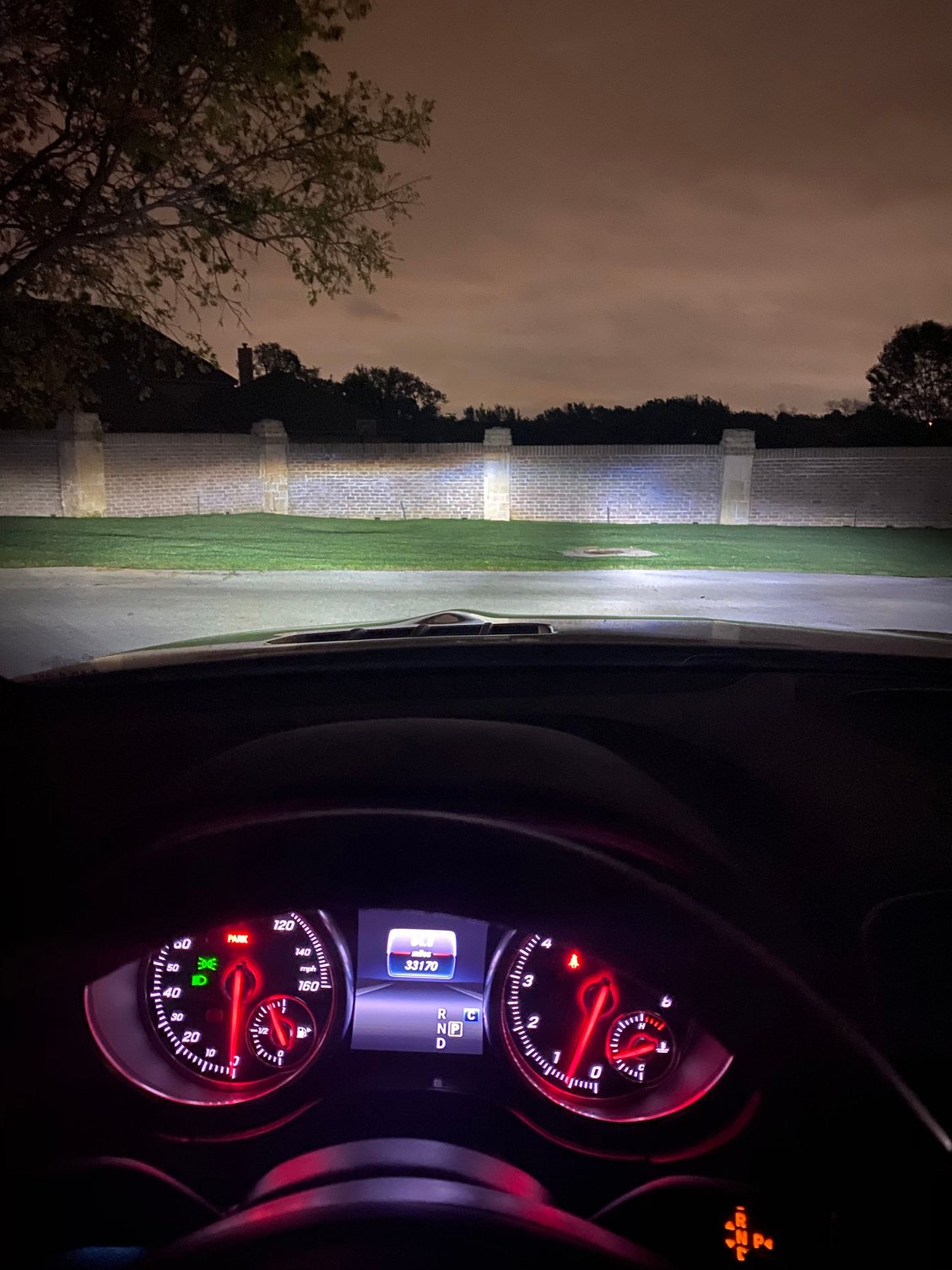

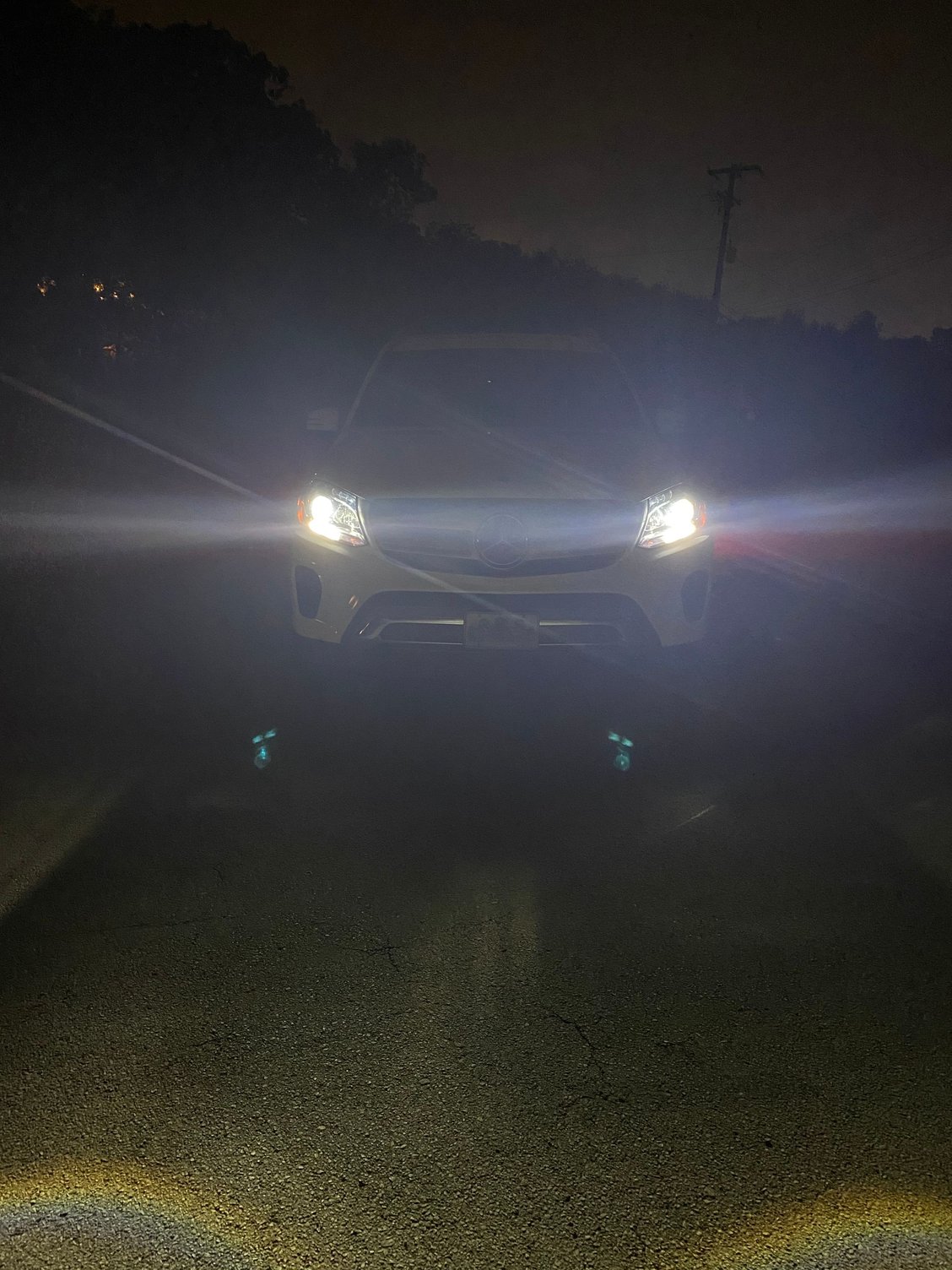

Hello all,
I recently bought a 2017 GLS450 without the lighting package. I was really unhappy about this so I started looking into replacements. I did not want to cut any wires or dust caps. I found LASFIT through their Youtube Channel. They advertise their MB-Pro2 kit for the GLE/GLS models. On the GLS they are plug and play, no cutting. The GLE requires dust cap modification. The LED's themselves fit perfectly with no bulb adapter and no error codes. They are 3800 Lumens per bulb and have a 6000K color that match the DRL really well. The beam pattern is really great too. I am looking for a plug and play high beam solution as it is a little more tricky, and I will let you all know as soon as I find one. But for now this is a really great low-beam solution.
