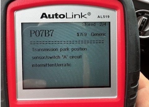

my 2018 GLS550 (63k) has started doing this. I've got CEL codes: P073E (Unable to engage reverse), and P07B7 (Transmission park position sensor/switch "A" circuit intermittent/erratic). After parking overnight, the CEL was gone. I brought the car to the dealer and an independent shop, who both could not replicate the issue.
a few drives later, it happened again. I noticed that it occurs when auto start/stop feature stops the engine at a stop. at that time, the car (in comfort mode) goes from D2, to N, and it does not allow me to switch back to D gear... unless i change into Sport Mode, then is changes to D3, and then only D3-D5 gears are only available.
