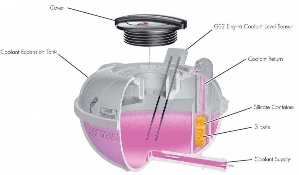

The silica gel bag in a Mercedes coolant jug helps maintain the level of silicate protection in the coolant. The bag is built into the jug and is a permanent part of the car.
above is what i found online. seems like common issue based on my research..

Wow, learn something new every day. There is no way the amount they put in there could clog a radiator or, at least, it doesn't make sense that they would put enough in there to clog one.
yeah if you google mercedes heat issue, it seems that some people are experiencing the silica gel issue. Thorough coolant flush might get them out and fix the issue. But dealer being dealer, they would just replace everything.

Maybe you can reverse flush the heater core.
It may be possible to plumb a filter in line with the heater core as a preventive measure. This one is 600 microns (0.02"). Should be enough to prevent clogging.

just an update on this: so i got the car back after water pump and some hoses were replaced. The shop also did multiple coolant flushes and i was told that they didnt see anything. While it was warmer than before we are also experiencing a cold snap here in southern ontario.
i am still not 100% convinced that the water pump is the issue. Will see if this is still an issue after a few days.
Old Oct 29, 2025 | 12:07 PM
nioero's Avatar
Joined: Jan 2025
Posts: 38
an update...the water pump replacement didn't do much to the heat....
just had another shop replace the coolant bottle and flush out the heater core really well....the heat is now back on before the winter!

Thanks for the update - so it sounds like the flush fixed the issue, however if you replaced the coolant bottle with a new silicate bag that comes with it ... are you concerned that it may happen again? Im wondering if I should just have my heater core and other components flushed and keep the current coolant bottle. Thoughts?

that is a good and valid concern. It might happen again 5-7 years down the road if i am on the wrong side of the statistics. If i still have the car at the time, i guess i will deal with it again.
