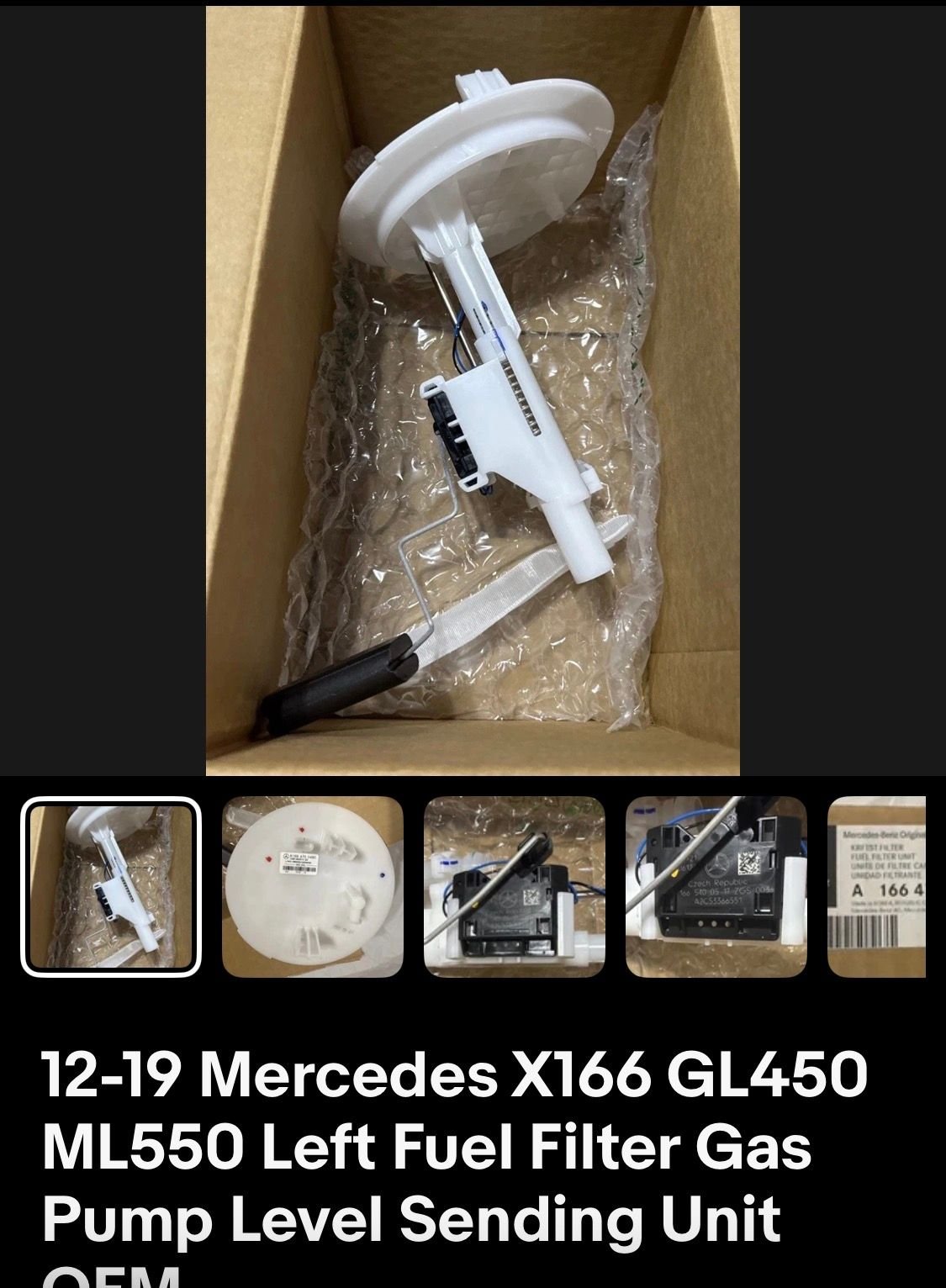

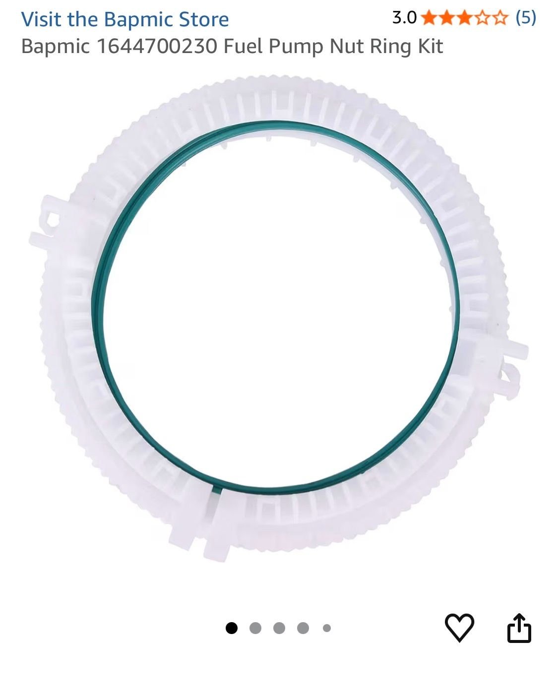

here is what i think happened,because the filter was never replaced the tube simply disconnected because it could not provide the pressure because of junk in the filter from all these years,got the new gasket,filter assembly and also got the bosch hpfp (p/n 0261520219) just in case,going to need to drop the exhaust and driveshaft to get to it,need a special wrench to open the tank
