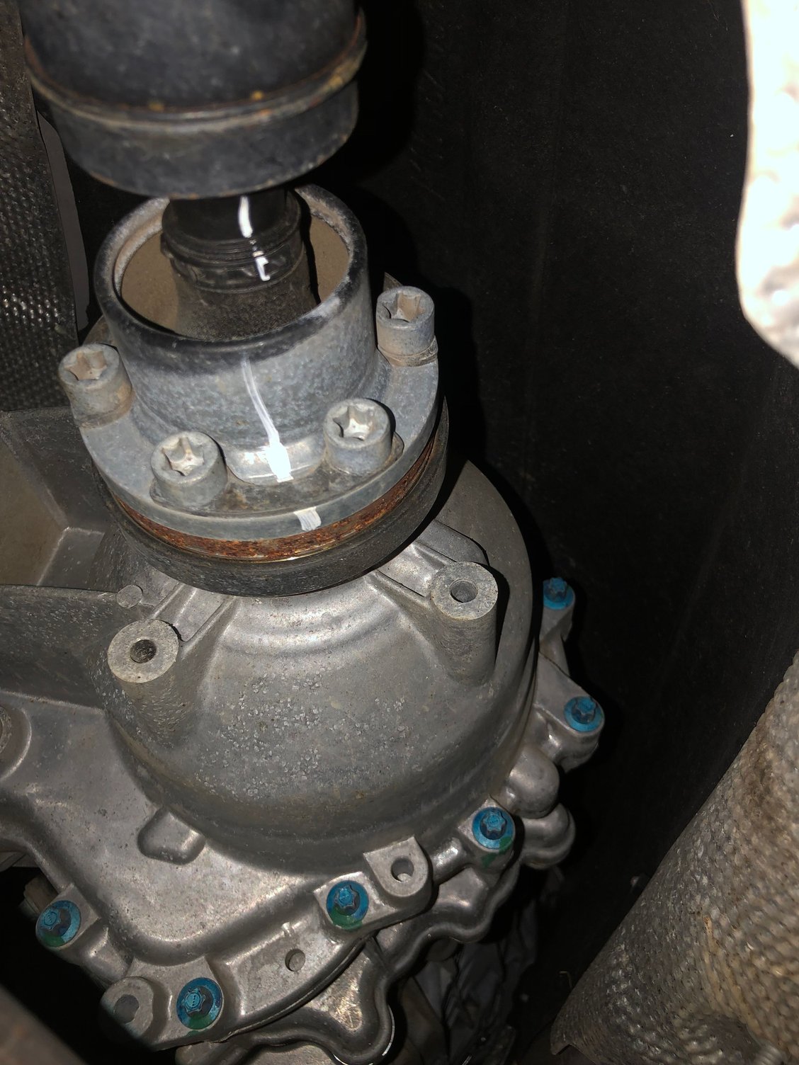

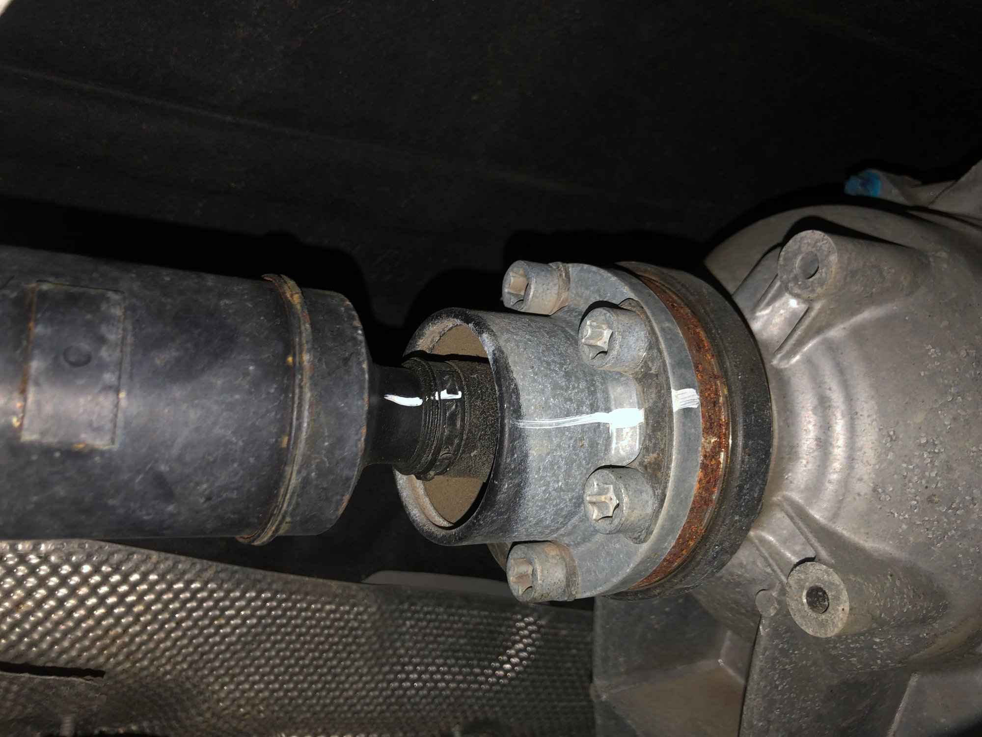

However, Moving forward, looks like someone had reason to use a green paint pen on the back of the transfer case and rear driveshaft output. (see images attached) Looks like someone may have disconnected the drive shaft at the transfer case and, as a minimum, had the rear cover off.
Last time I worked on a transfer case was on a '73 Jeep CJ years ago.
Looking at the white striping on the drive shaft, it does not look perfectly aligned, but can any conclusions be drawn from that? Does the Benz have equally spaced splines where one could reattach and be, say 10 degrees off? Is it somewhat keyed so it can only go on in maybe 90 degree increments? Looks more to me these were marked, "in case" they needed to be seperated with not much care. But wouldn't the appropriate thing to do be to separate at the mounting plate with the torx bolts?
Assuming someone was inside the transfer case, any thoughts as to what could be going on that would cause my vibration? There is no sound or noise coming from it. Is there something inside that could have been replaced incorrectly that is causing the imbalance? I'm kind of clueless at this point. Will need to do research to see if the transfer case is chain driven or gear driven, etc. Anyone know what model Tcase this is to do some general research?

Update. I went for a ride in the 3rd row with my wife to her doctor's appt. The 3rd row is squarely on top of the rear suspension. Perfectly smooth. I then rotated the front tires to the back as suggested earlier just to be sure, and again, perfectly smooth in the way back row. My wife confirmed the shake/vibration was still present when she was driving. It just so happens that if you look under the GLS, the transfer case and transmission mount align with the floorboards close to the front seat attachment points which would explain why this vibration is being felt in the front seats and could be misdiagnosed at rear tire/suspension issues.
At this point I am convinced it is related to the transfer case. Probably early signs of a stretching chain. Everything I see on youtube are examples of where the chain has stretched so much that it is skipping teeth on the sprocket. Mine is running quiet and smoothly below 60 mph. But probably flopping around a bit at high speeds.
As a first step I am going to drain and refill the case. Probably is the original 75K fluid. While I've got the plugs out, I will poke at the chain to see how much deflection there is. My guess is I will need to be replacing that chain. I'll update with what I find.
