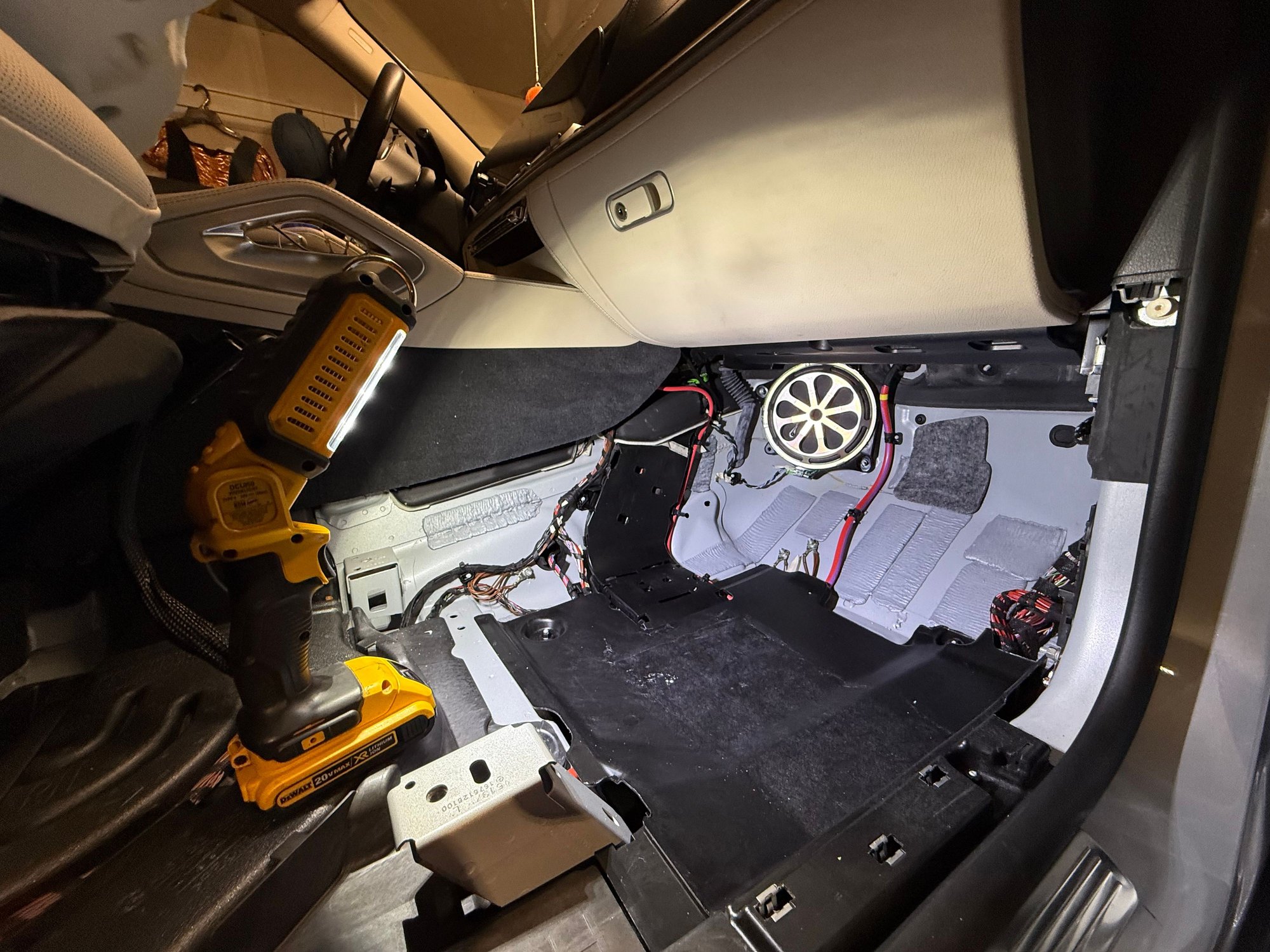

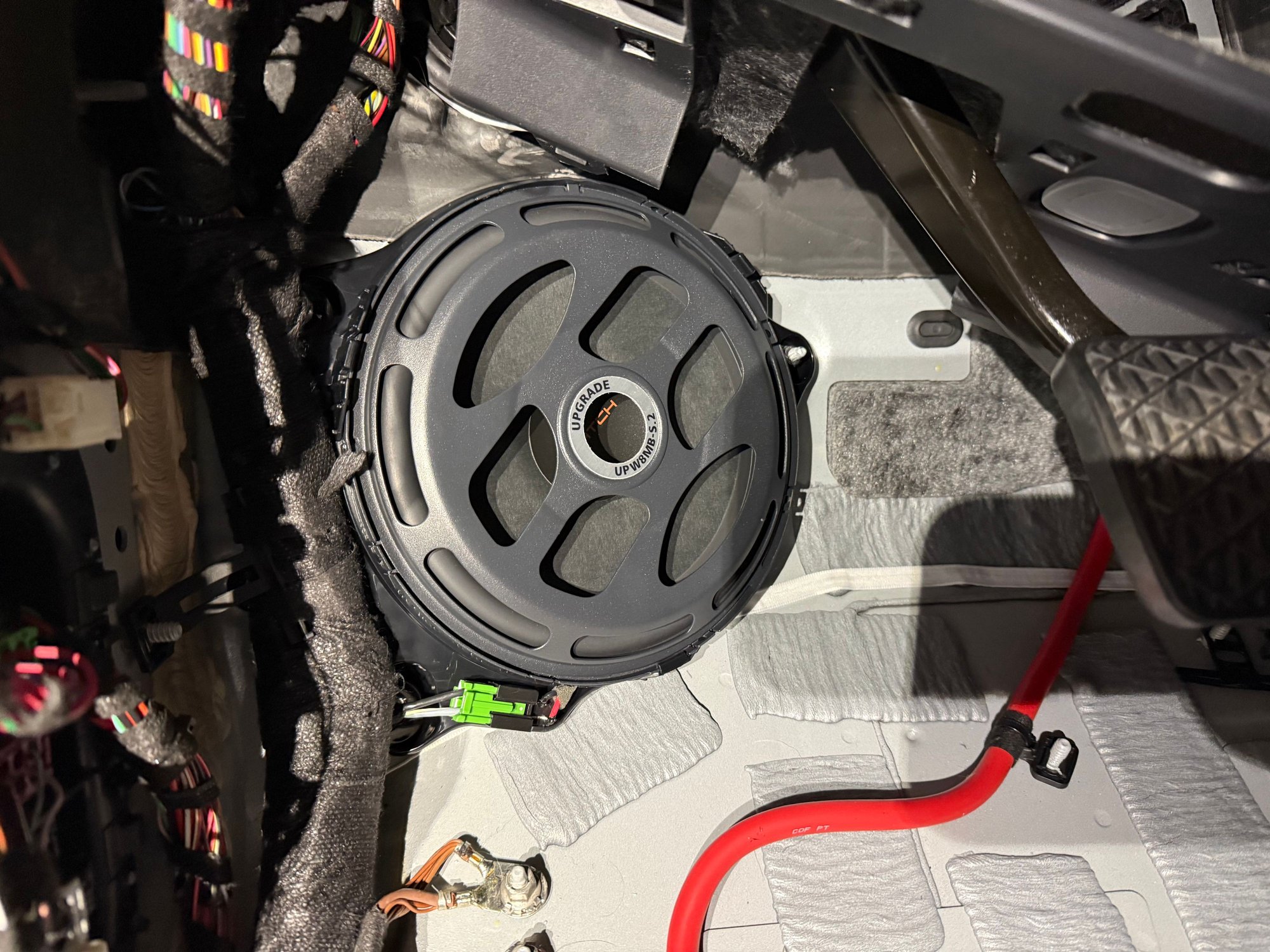

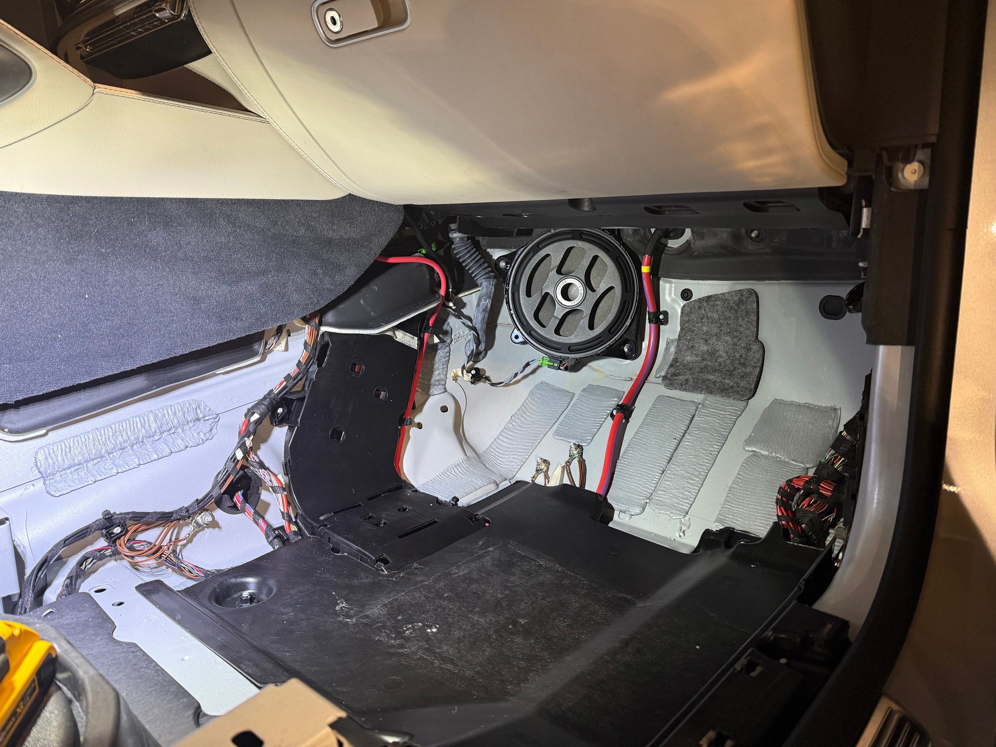

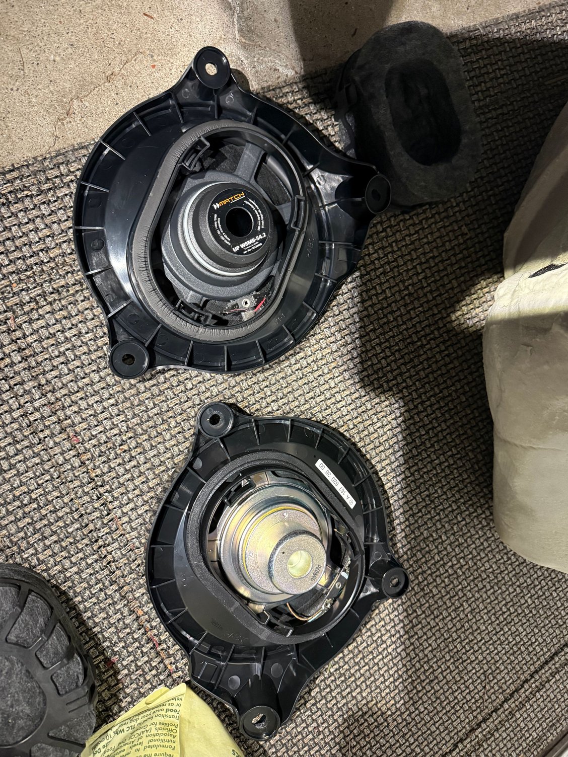

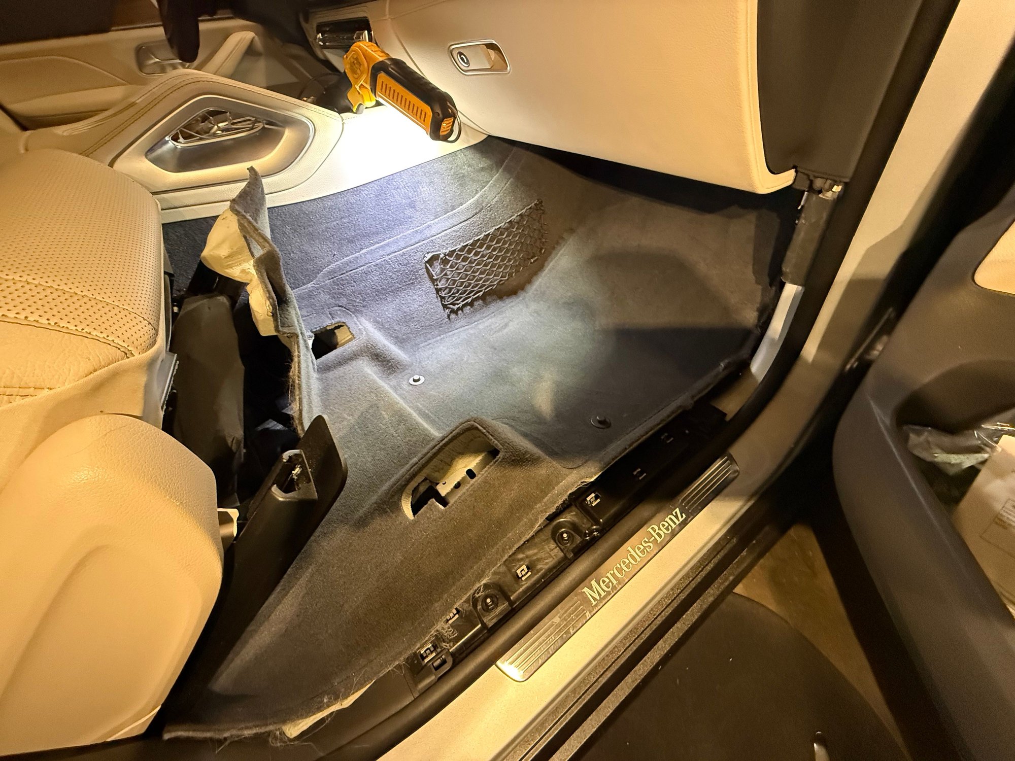

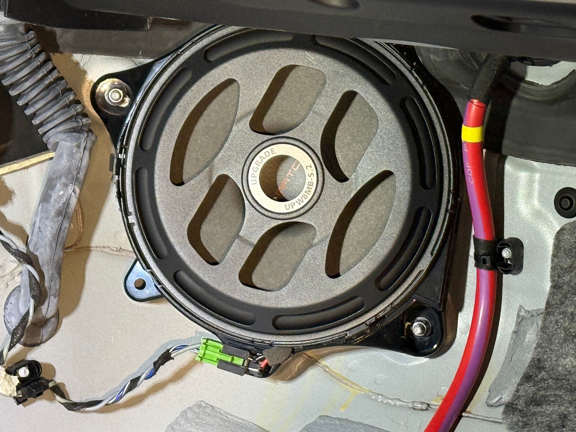

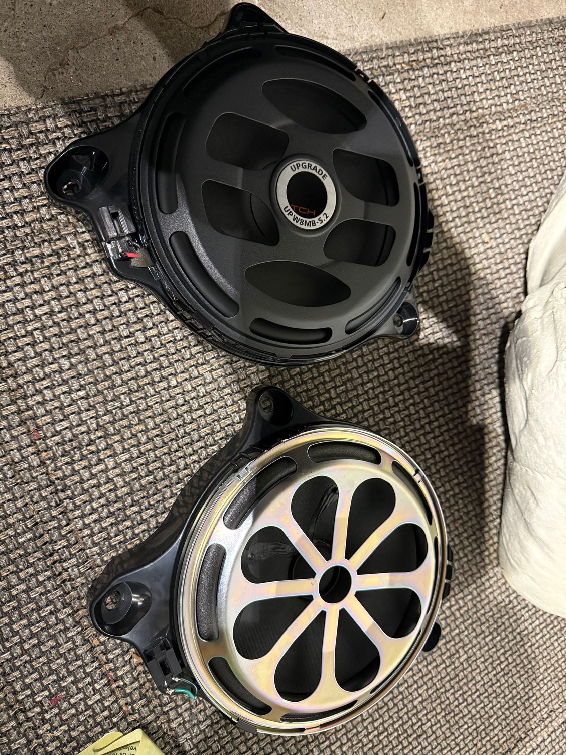

Hello everyone,
I wanted to share my recent experience with the audio system in my GLS450 X167. I've been driving it with the standard Burmeister audio, but I always felt that something was missing—especially in the bass department. Coming from an E350 with Harman/Kardon, I knew how good my favorite tunes could sound, and the lack of bass in my GLS was really noticeable.
After doing some research, I decided to upgrade just the bass speakers in the footwell compartment. I’m happy to report that the bass is back and sounds how it should! It’s made a significant difference in my listening experience.
Recently, I had the chance to drive the EQS and EQE models, both equipped with Burmeister 3D (standard, not High End), and the sound quality was amazing! I really wish my GLS could sound like that.
If you're feeling like your audio system is lacking, I highly recommend considering an upgrade to the bass speakers. It made a world of difference for me!
Cheers, everyone!

Also thinking of an upgrade.
Are those Match speakers?
Where did you source them, and did you have to modify any OE structures / parts?

I got them on eBay. Nobody sells these speakers in the US. Here is the specific part number for the GLE/GLS model: MATCH UP W8MB-S4.2 LHD.
There are no modifications needed; they are plug and play.

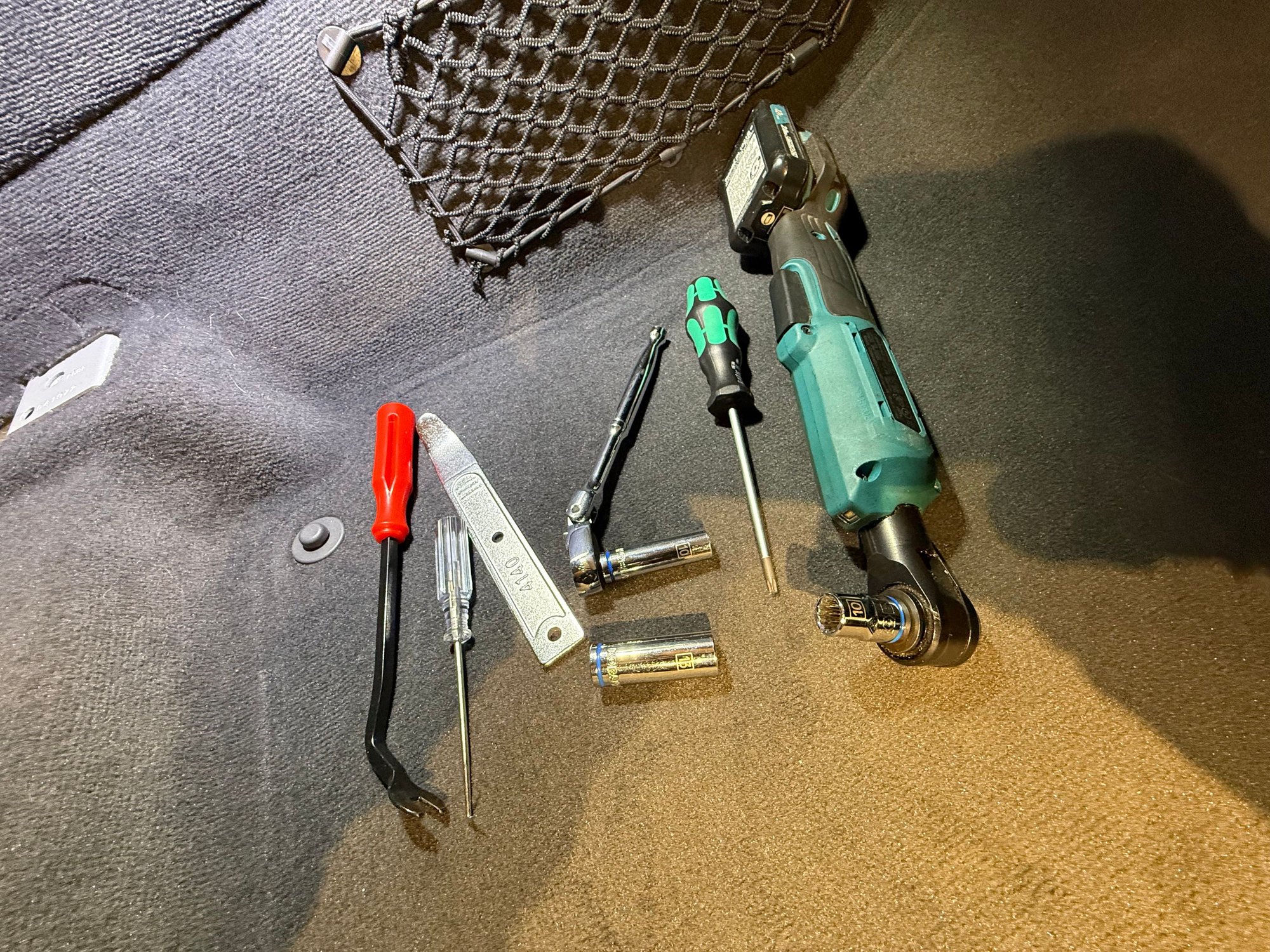

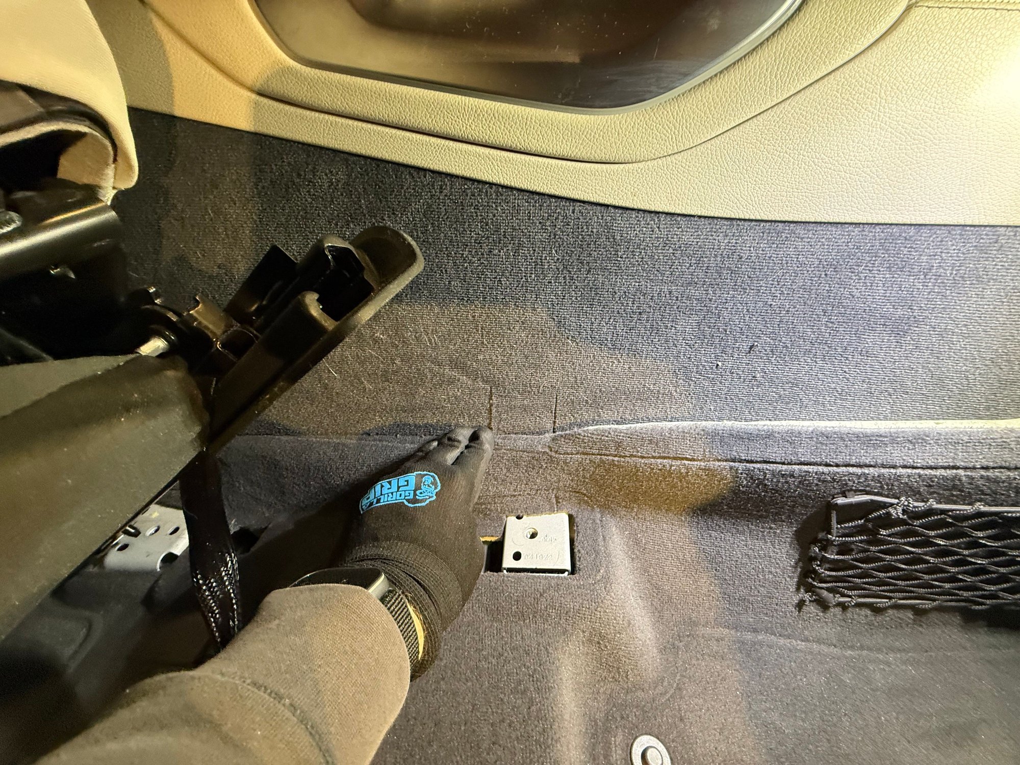

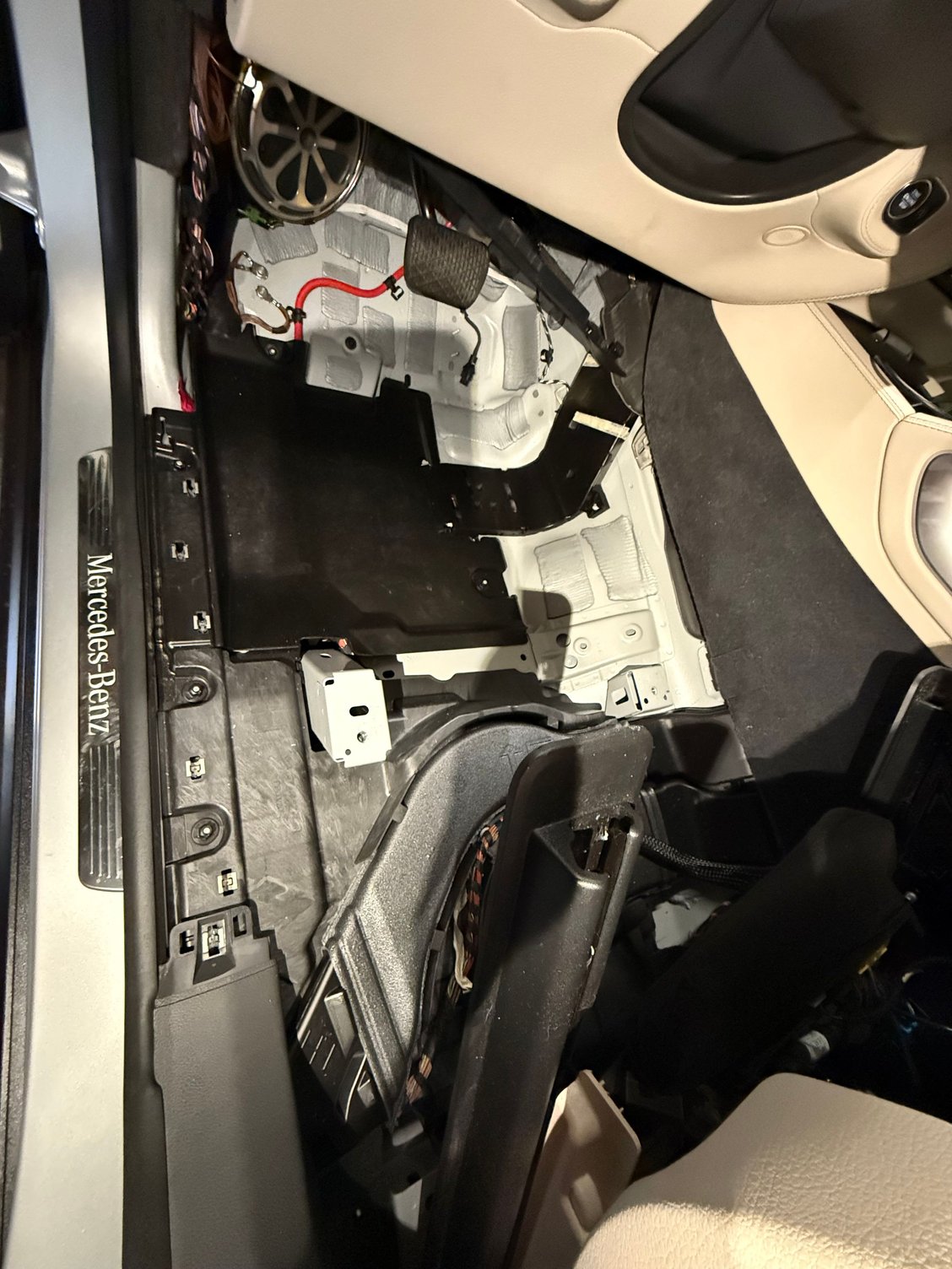

Thanks. Your picture showed a lot of disassembly. How long did it take, and did you need any special tools?
Crutchfield sells Match speakers, amps and DSPs.
I have a variety of components from Crutchfield. Good source and staff.
https://www.crutchfield.com/S-te9E9j...-Speakers.html

How's your German? This video shows a good overview about the depth in which it will take to access that speaker:
17min mark to 25min mark
EDIT: turn on auto translate to English by tapping on the cog wheel, subtitles, German, and then okay. Go back into that same setting and then "auto translate" will appear, select it and then English.

^^^ That was really useful, especially since I haven't looked behind and under trim.
I can use it later and maybe print some pics while I'm working.
Right now I'll use it in my dash cam installation.
