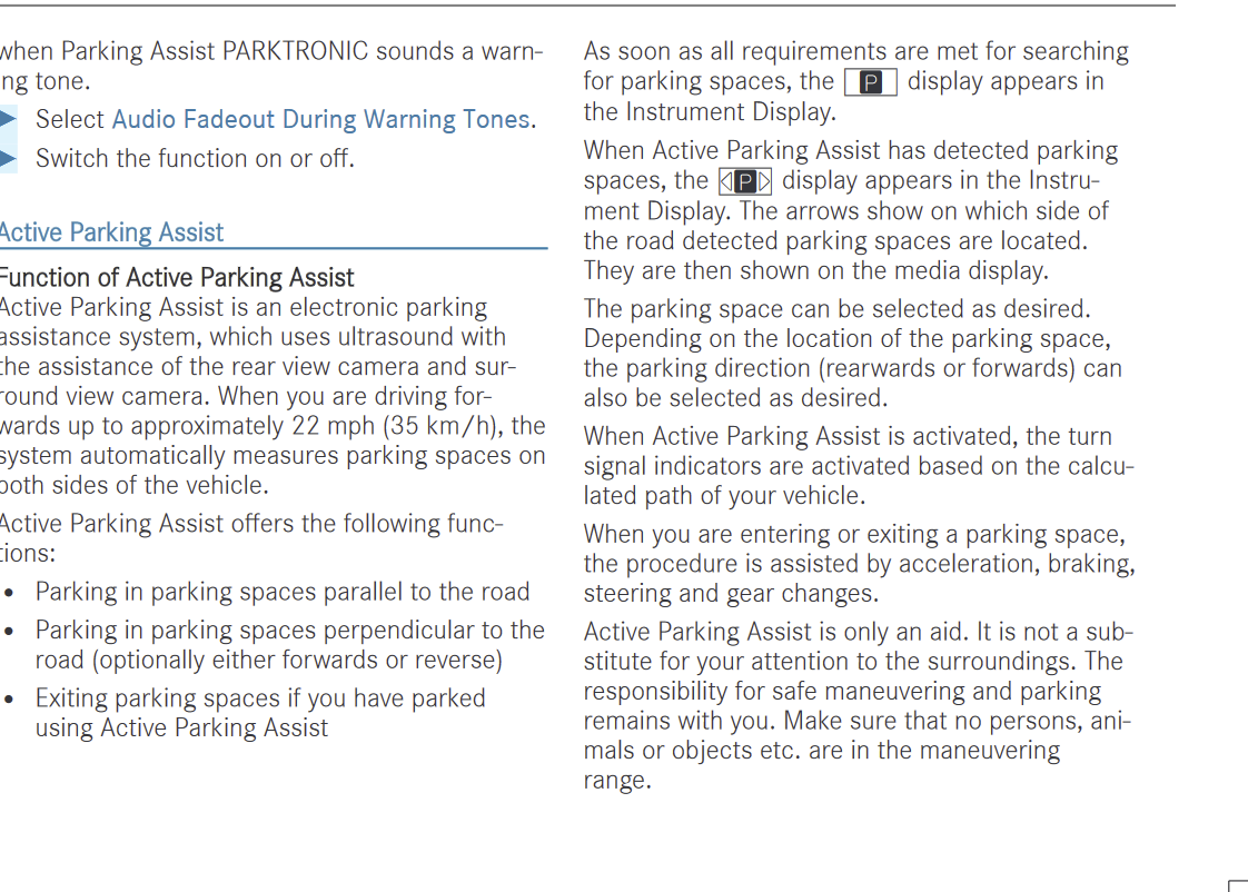

Can anyone tell me what this symbol is for in the instrument cluster? I have searched the manual but it is nowhere to be found.

That's showing that it is looking for parking spaces, and the arrow will indicate where it sees one it thinks is one.

Parking assist?

Ah Ha! Makes sense. Have never used that function. Thank you for helping me with the mercedes ovaltine decoder ring.
