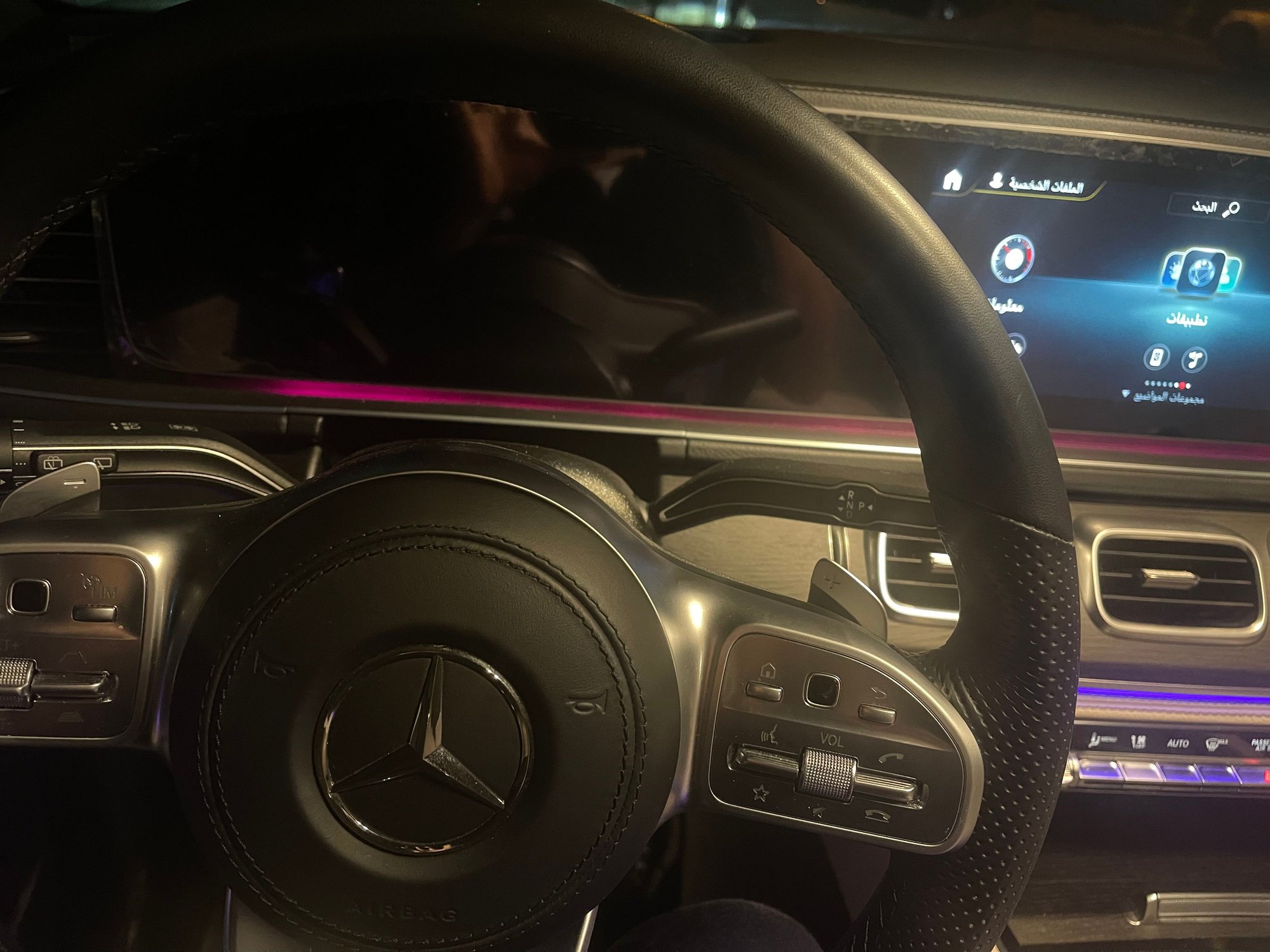

just got this morning my digital dash board and hud both completely not working without any reason.
i left my car last night and everything was fine, and just found it this morning like this, right MBUX is working normal just the driver dash board is the off only.

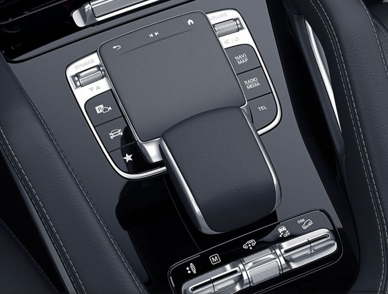

Try doing a reset on the mbux screen. If that doesn't work you will probably have to take it in.

That happened to me one time over a year ago. I was concerned that my odometer would be off, but I noticed on my phone app that the miles had updated. The next time I started the car, everything was fine again. Resetting the MBUX by pressing the volume button on the console for a few seconds might help as well. Hopefully it's just a one-time glitch.

hello guys, it got solved by itself
I used it all yesterday and i tried many times but not worked, at night i parked and been disappointed, this morning i get inside the car snd it worked normal, weird!!!
its fine now

There’s also a soft reset available by pressing and holding the * and “Tel” buttons on the centre console down together for about 5 seconds which can help when screens aren’t right. I’ve seen this work for the centre screen at least, haven’t seen the drivers one play up ever.
