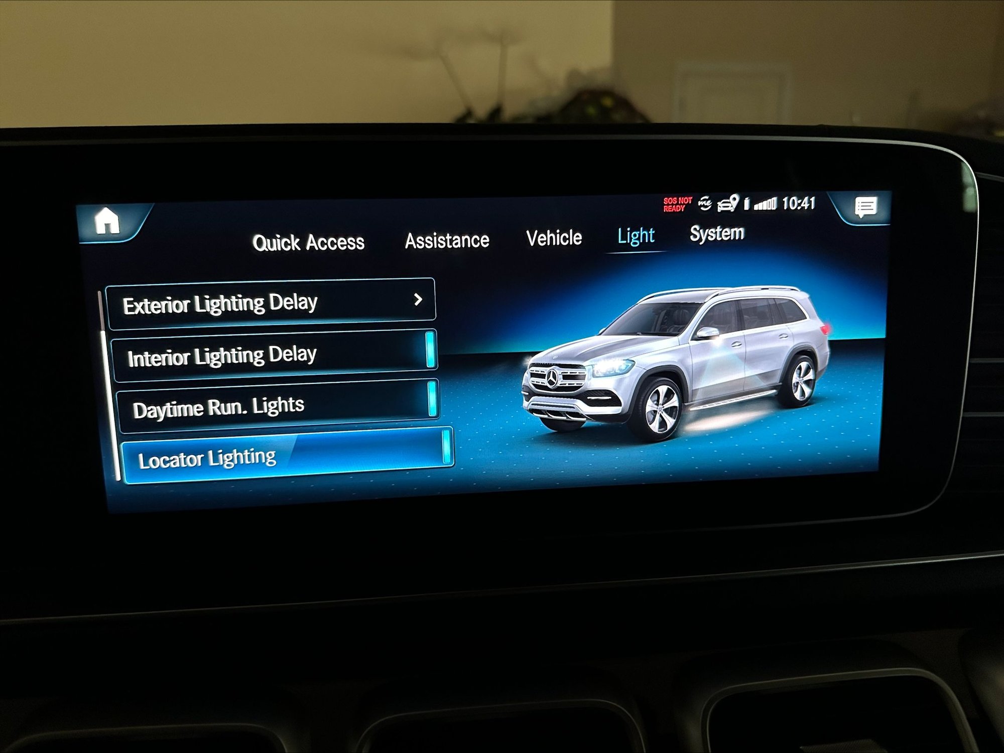

This is how it looks in my dash. The side mirrors are tucked in the garage but they're not tucked in all the time, especially when the car is unlocked! Projection should be on day or night, right?
Old Oct 6, 2023 | 10:57 AM
wildta's Avatar
Joined: Jan 2023
Posts: 3,142
Likes: 1,205
GLE 580
I know they turn on when unlocking the vehicle and after you park, turn off the engine, and exit... but I'm not sure if this is all the time or based on ambient light.
