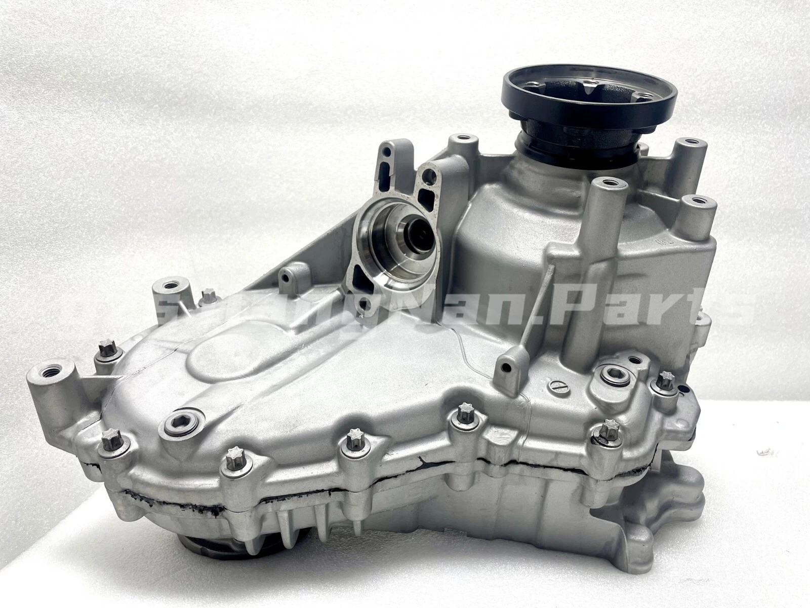

These are baby transfer case lite units, similar to “sedan type” t/cases used for years on C-, E-, and S-Class 4MATIC. Not a proper chain-sprocket device like G-Wagen, 166, 164, 163, F-150, etc. Porsche uses the same junk design concept. Clear cost cutting by the carmakers.
BMW for whatever reason has been successful with a lighter duty t/case in xDrive. The design details are different than the junk MB and Porsche are using.
The MB and Porsche baby lite t/cases are not up to the task of a medium sized SUV. The units use wet multiplate clutch devices wherein the clutch plates are slipping against each other 100% of the time. Terrible design. It’s another throwaway component.

I rolled into the dealer back in August with exactly 50k miles on the odo. To their credit they honored the warranty and I paid nothing. The transfer case can be bought from any of the wholesale dealers for around $4100.
Ya strange OP's transfer case failed already but I wonder if it is was defective in the first place and progressively got worse, the replacement should last a long time a result.

Self contained oil supply, same principle of operation as Porsche/Audi on the MLBevo platform.
