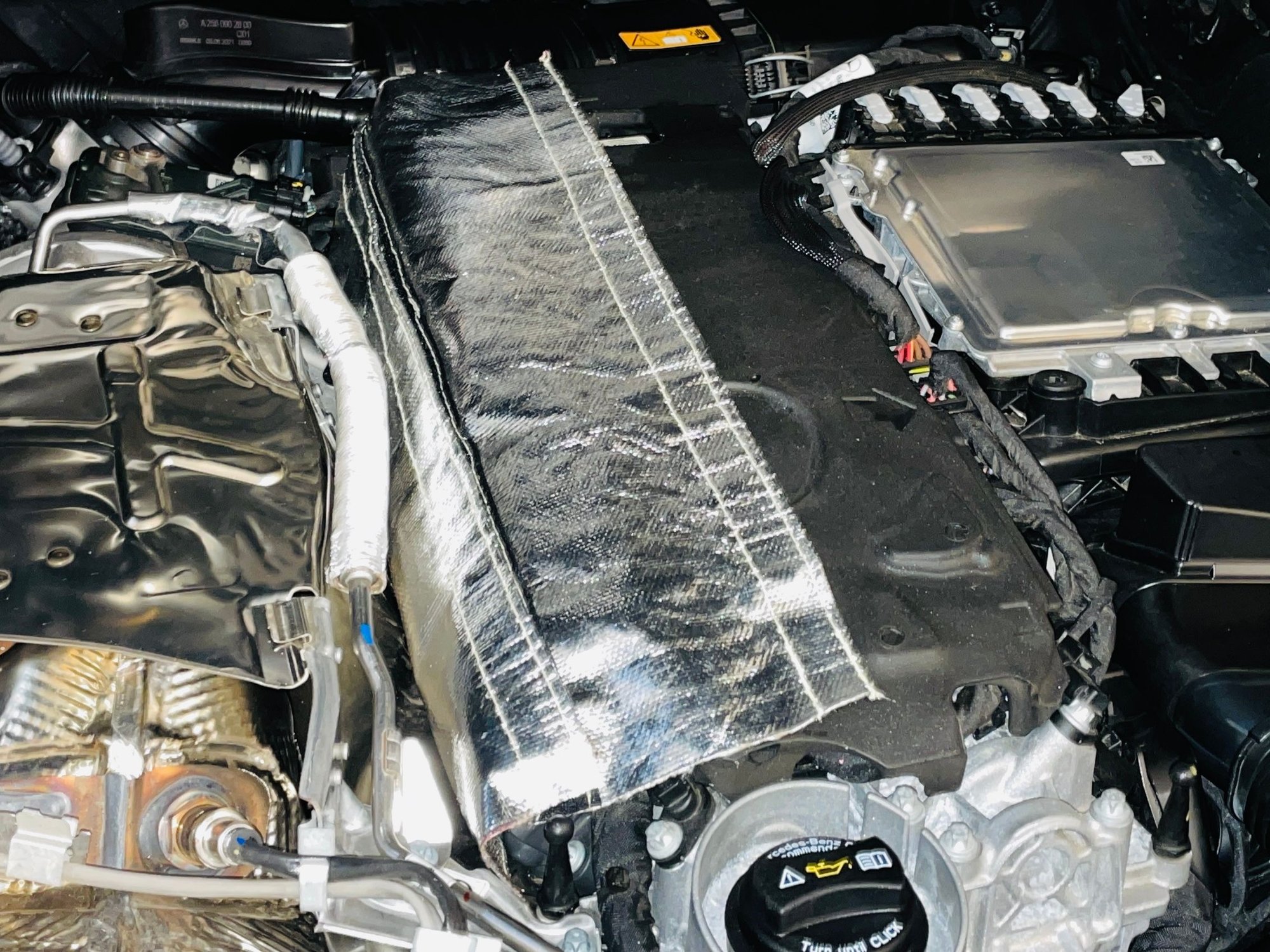

I installed this shield fabric to prevent burning the wires and connectors from the hot turbocharger while idling. This will happen over time and for owners intending to keep the vehicle beyond the factory warranty, wire harness replacement is expensive. This is a $10 preventative measure.
Old Nov 7, 2024 | 11:22 AM
BenzNinja's Avatar
Former Vendor
iTrader: (5)
Posts: 2,973
Likes: 958
Option 2 is
Turbo Heat Shield
Many models available. Used it a lot on th V12's BT
