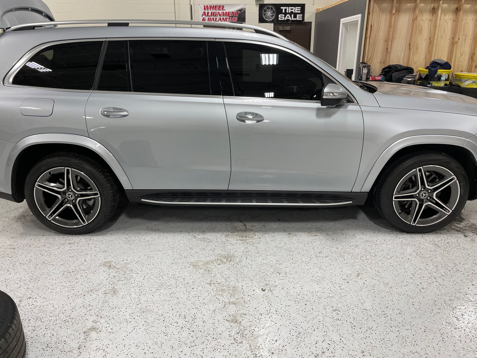

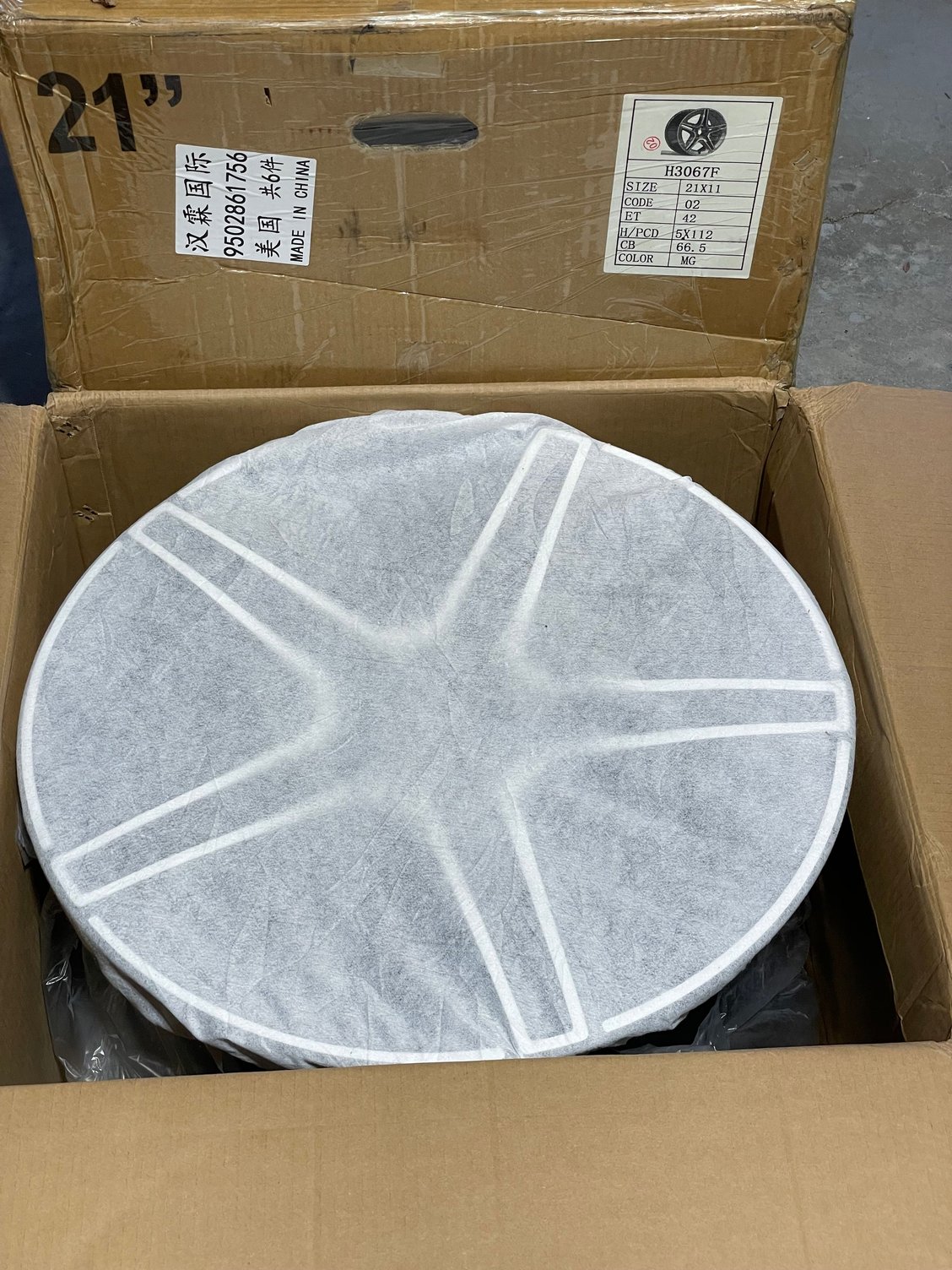

I can't help you with OE wheels but this is my winter setup I just got installed today. I ordered wheels direct from a MFG in China they are basically 1:1 replica's of the 5 spoke 21" AMG wheels you are looking for (without the AMG engraving of course). I got 6 total, 3 front and 3 rear so I had a spare of each. Sourced a set of Pirelli MO all seasons from eBay with about 9/32 all the way around as well as TPMS sensors from eBay. All told with freight, the sensors, balancing and mounting I am into these for less than $2000 total and since I only plan on running them from Dec-Mar they will probably outlast my ownership of the car. If you or anyone else were interested in more details just let me know. Here are the wheel specs
front wheel : 21*10J ET 44
rear wheel : 21*11 ET 42
CB : 66.6
PCD: 5*112
Old Dec 2, 2024 | 12:30 PM
wildta's Avatar
Joined: Jan 2023
Posts: 3,125
Likes: 1,203
GLE 580
CB : 66.6
PCD: 5*112
