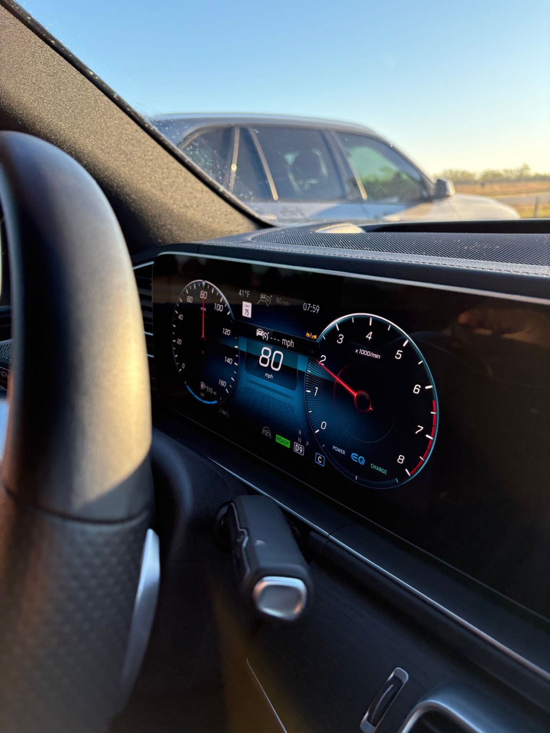

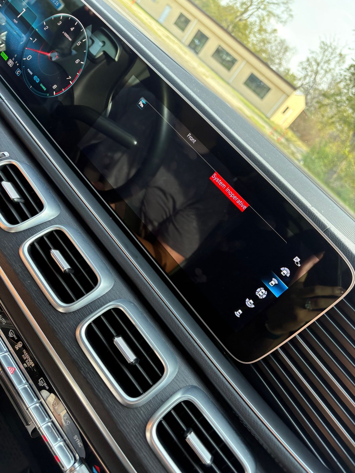

2023 GLS450 randomly throw 6 error codes listing multiple advanced systems as inoperative. The cruise control will not work either as seen in the attached pictures. Stopping the car will reset the code and buy about 30 minutes of driving before repeating the cycle. This error is also indicated by the yellow cars looking like they are about to hit on the dash.
The 360 camera system also goes inoperative at different and similar times. Picture attached. Any commonality between the 2 issues? Thinking the head unit.
Patience is starting to wear thin, not having cruise control at random times especially on recent roadtrips has been crazy.

The head unit just displays information, it has nothing to do with any of the advance safety features, the cameras nor the alerts. The camera is the nucleus around all of these issues. It could be defective, it could be dirty, your windshield could be dirty, your glass could have a chip/crack or other defect.
A physical piece of hardware on your car is seeing (or not seeing) something it doesn't like and is telling the software that it is not safe to use these features and displaying the errors to you, the end user.

Restarting MBUX usually fixes that red system error message. Hold TEL and 🌟 STAR buttons until the screen goes blank. It takes about 4s for reverse cameras to show again and 10s for entire system to work again. It's a pretty quick restart.

I hear what you’re saying but if the camera is faulty the system will refuse to show any image, including other cameras? And cruise control, a basic system that has been around for decades, shuts down and prefers the driver to use their foot?
These are the things that don’t make sense to me. I believe 1 control module was already replaced.

It's possible that all your sensors and cameras need to be calibrated but first I'd just wipe your camera lenses clean (and the outside windshield area where you see the camera hoods) and make sure the big distronic sensor at the front is clean (although I don't think dirt affects that like the cameras). It's also possible that the lenses directly on the front cameras behind the rearview mirror needs to be wiped clean, in previous model years a film builds up on the lenses from off-gassing of the heating element that prevents fogging. You're still under warranty so push for those things to be performed.

Just had this. It required a software update. No issues since.

An even easier solution. Thanks for chiming in. Yes and oftentimes a software update will fix the issue(s).

I had a couple similar, kind of random events, on consecutive days, then a week later another, and again in a week.
First, my cameras all went off and I got the display you showed. I drove for 30 minutes to an appointment and it seemed to correct itself. I came out from the appointment, my seat and steering wheel were way back and up, in the Exit position. Drove a quarter mile (no more because I didn't feel like I was safe). Waited a half hour and I had control of my seat again.
In both cases I did the "turn off the car, open and close door, restart" procedure but to no avail.
A week later I got the camera malfunction again.
Documented the incidents, wrote a succinct description for the shop and took it in.
I took it in in person because I wanted to converse with the SA and service manager, instead of having them pick up the car as they usually do - I'm a hundred miles away.
I also mentioned some concerns that others have had on the Forum, as a kind of "wonder if I have" statement. Rear clunk (no, I don't have) front suspension rattles (no, I didn't really have either).
They worked on the car for a day and a half.
