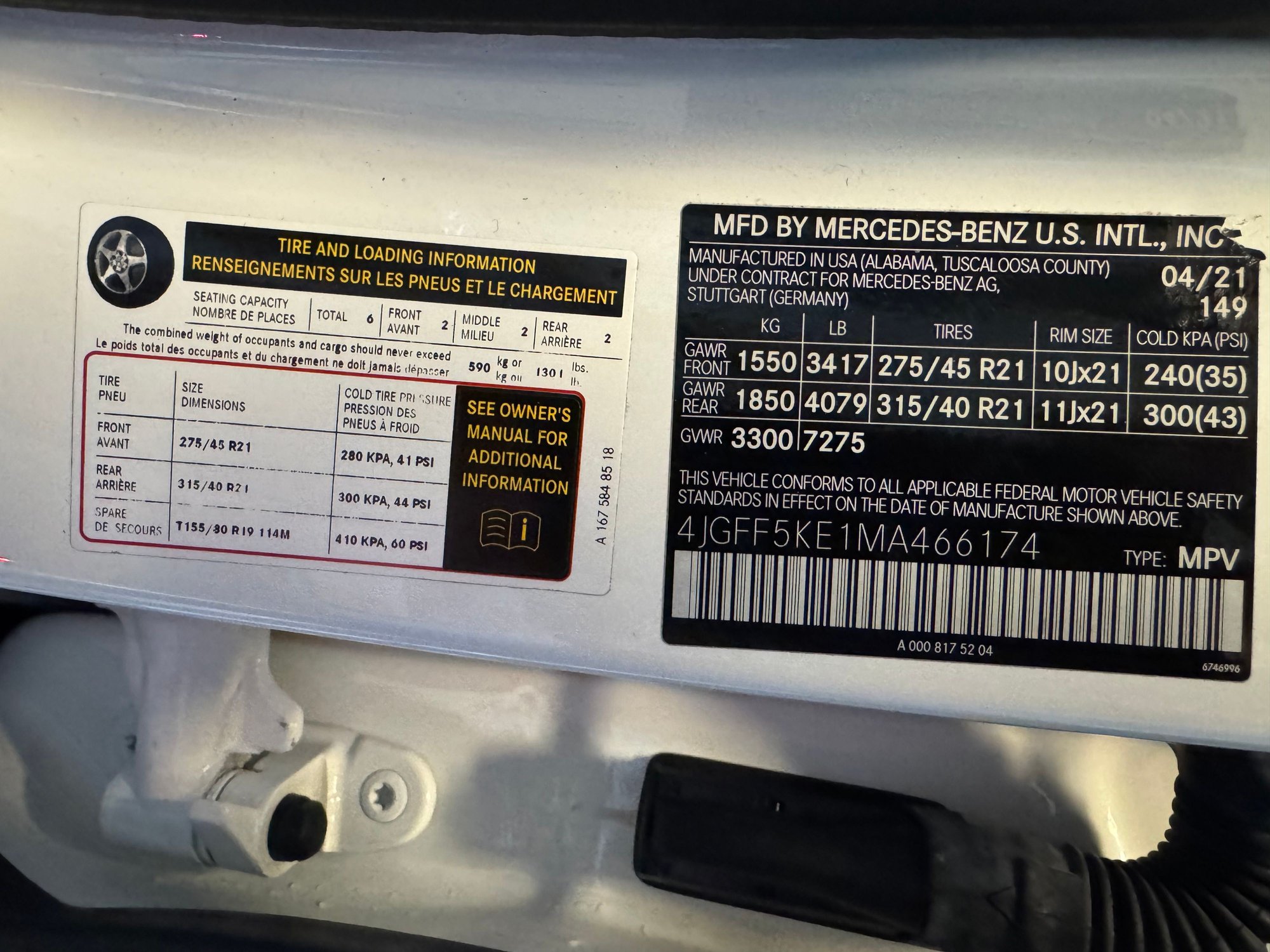

I've got two different tire pressure labels on my 2021 450: one with the VIN and GVWR information and another factory label with slightly different pressure values. Which set of pressure values should I use?

The right one because the right one is always right... alright jokes aside, there should be another sticker further up the pillar, that is usually the sticker that is found on the gas fuel cap door on ICE models.

The left sticker is the NHTSA one which is required by law but shows the gross weight load pressures.

Here, this is the type of sticker you should use it is further up the pillar, do not use the pressures shown in this image (this image is as a reference), find the similar style pressure sticker as it is different for each vehicle: https://mbworld.org/forums/eqe-suv-x...ml#post9081157

Um, I just realized I am replying to an ICE vehicle thread, I thought I read EQS. Sorry for the senior moment, if so, ICE vehicles have that sticker in the fuel door cap, use those pressures, ignore the two stickers you posted.

Here is an example on a GLE: https://mbworld.org/forums/gle-class...-what-use.html

Gas flap.

Make sure to measure the tire pressure and adjust when cold not after driven, account for temperature differences say in a garage and outside and the coming temperatures based on the forecast, take the average. Adjust according to driving style and load. As you know, tires heat up to 3 or 4 psi higher when driven.
