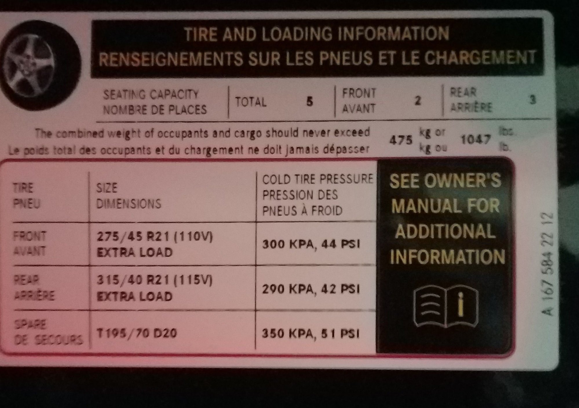

Working backwards from a 7,600 lb GVW Airstream (everybody loads their trailer to at least the GVW) you'll need at least 10% tongue weight to prevent sway, (I travel at 12%) or 760-910#. Add the weight of the WDH which will be 100 to 200 lb, and you've eaten up 860 to 1,100 lb of your payload.
And then there are passengers and internal cargo, at least a sandwich.
The payload of my 2021 GLE is 1,047#, so I've limited my RV to 6,000# GVW, and I'm still overloaded, but I still have about 250# leeway if I only pay attention to the GAWR, (Axle weight ratings). With my 6K RV.
To me, what you can tow is not limited by your power, wheelbase, or rated towing capacity. It's limited by the tow vehicle payload.
I don't know the payload of a new GLS 450, but you'll be pushing it, or over, with a 7,600 lb Airstream.
Is the payload of a 450e lower? If so that would rule out the 450e.
Payload varies by equipment, so you need to read the actual label on the door post. Don't rely on an internet search.
BTW the largest payload I've had was my 2015 Cayenne diesel, at 1,600 lb.
I know Can-Am RV tows some heavy trailers with some underrated vehicles, and they show them doing the moose test and other slaloms. As much as I trust them, I'm still cautious about payload.
You might get the payload information from an actual 450e door post sticker, then call Can-Am and ask them their opinion.

Yes, I went to the dealership and took down some door jamb numbers of GLS and GLE450 with similar equipment:
GLS - 3505 GAWR front, 4079 GAWR rear, 7341 GVWR..but with an extra 243lbs with WD hitch setup properly. - curb weight of 5489 leaves me with a "real"payload of 2095lbs, which should be plenty for wife and stuff. We don't have dogs, bikes, kids, or anything else really heavy. As long as tires are 109 load index or above (and they all looked like that), should be within specs.
The GLE450E is a bit more on edge..due to the heavy battery. 3131 front, 4343 rear, 7099 GVWR, extra 375lbs with WD hitch, curb weight 5754. That leaves me with 1720lbs. GLS also has a longer wheelbase and similar rear overhang, about 36%, vs 34% for GLE. Tire sticker is low on the GLE, 1004lbs, but that also depends on tires. I'd need to make sure to use an XL load rating, vs the SL some come with.
