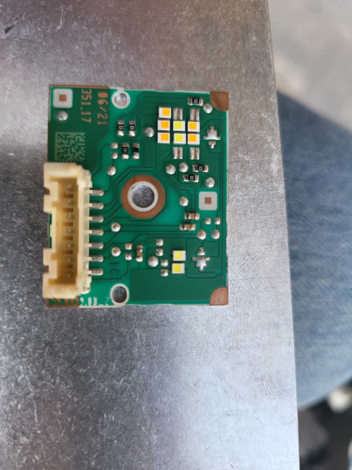

I got the headlight unit out and I find there's two modules One was on the bottom I didn't know about so I don't know which one controls the daytime running lights. And to make matters worse the replacement module I got didn't fit either of them.

These are the two modules on the headlight assembly

Well I replaced the Pixel 2 module today and coded it and it did not fix my problem the daytime running light still glows a dim amber when it should be white. Ugh. Now what to do?

Well both modules have been replaced and I still have the dim amber glow from my daytime running light. I guess this is a sign the headlight housing is bad. Any opinions?

It's most likely this, the PCB in the lamp assembly and not the modules.
