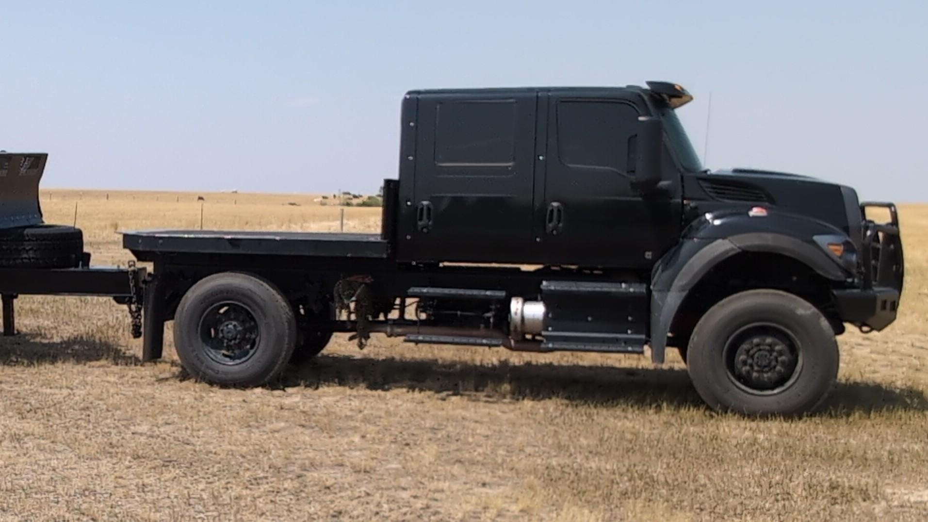

For heavier towing I use an International HV506 good for 55K lbs, but only because an F-550 / 5500 (typically known as a ton and a half or Class 5) would be bumping the GCWR when towing the heavier stuff. I prefer a bit of capability breathing room when towing. Could have gotten an F650 or F750, but FORD doesn't make that chassis with a proper 4x4 configuration.
The heaviest thing I tow weighs ~18,5xx lbs. Call it 19K with the extra crap in it. Put that onto a 12,000 lb trailer and you're at 31K lbs worth of a load. Add the power unit, and the total GCVW gets to around 45K lbs... plus crap in the cab. All that weight acts against you going both uphill and downhill, and a Class 5 wouldn't last long with those weight numbers.

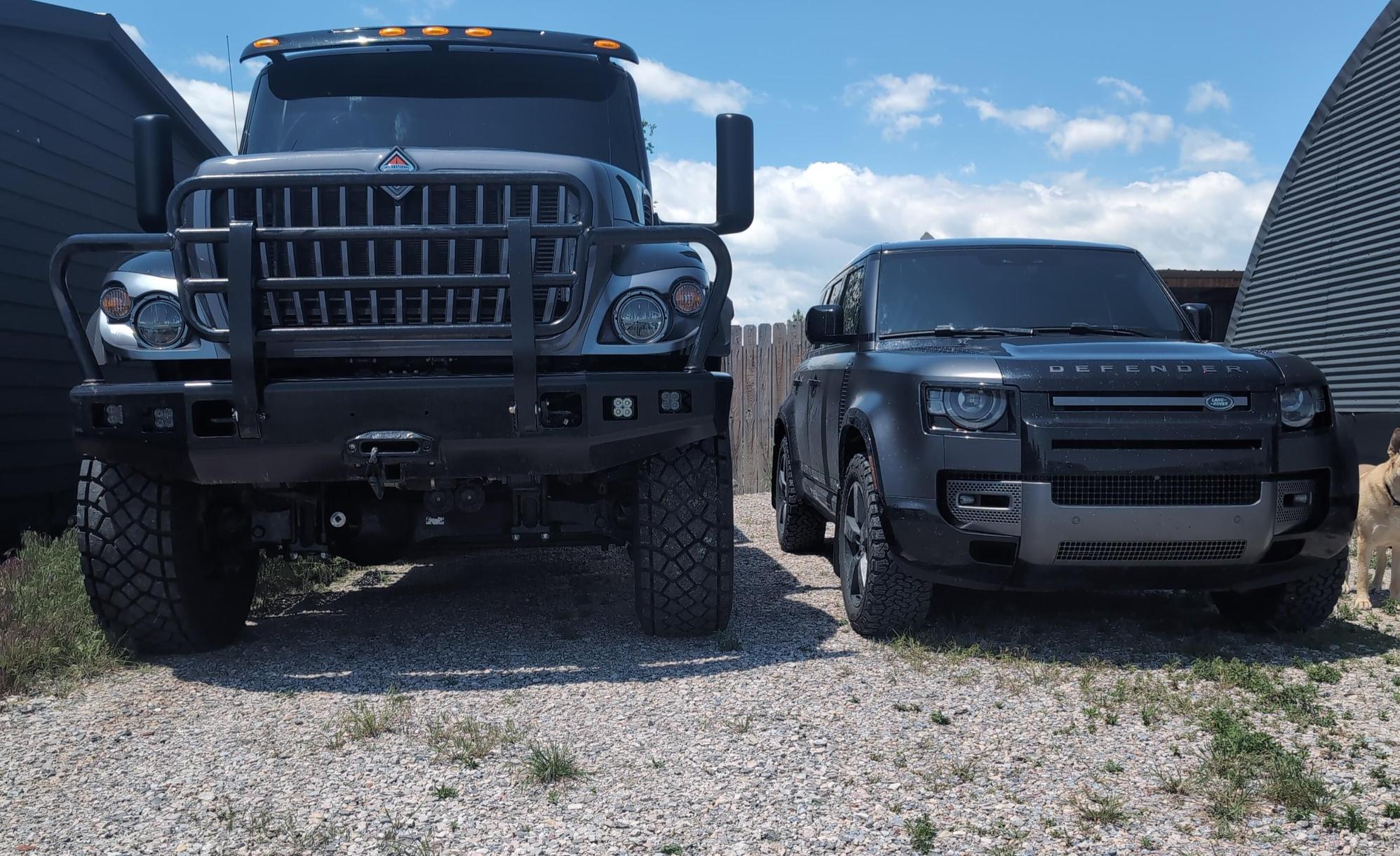

This is the aforementioned towing rig.
To put the size in perspective:

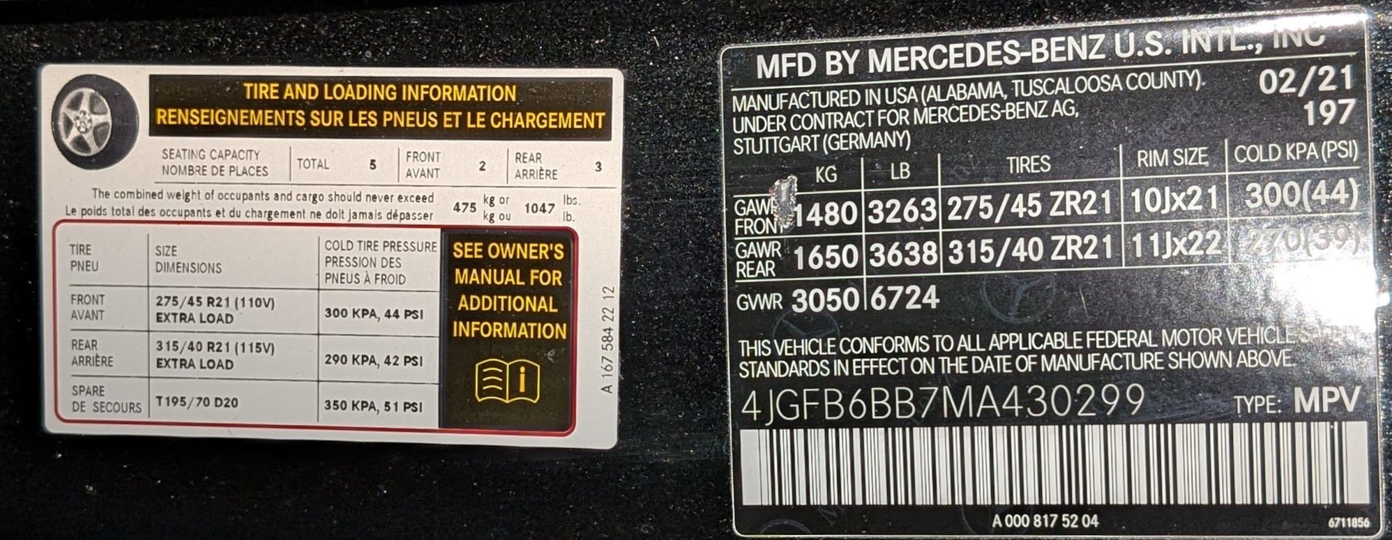

While some pickups with HD tow options have an advertised cargo capacity of 2,400#, that's the max with <zero> equipment. Read the door post sticker. It'll be closer to 1,800#, I'll bet.
Defenders have an advertised empty, no option cargo capacity of 1,900# (internet search, not verified), similar to a GLS.
In practice, a GLS is likely to have a door post rating of 1,000 to 1,250#. I'd expect the Defender to be similar.
That would put your 7,500# trailer in the "overloaded" category by my calculations. I'd expect it to be less than optimal.
Your calculations are wrong, so let's go to school:
There are several numbers you must take into account:
GVW - Gross Vehicle Weight - This is the max the vehicle can weigh. Vehicle, fuel, passengers and all of their crap. This is not the same as max allowed weight on the axles.
GCVW - Gross Combined Vehicle Weight - This is the max weight a vehicle and trailer combo can be.
Tow Rating - This is the max weight the vehicle can tow.
Now, in my Defender's case, the GVW is 7,120 lbs. This is the max weight the user should load in the vehicle. The front and rear axles are actually rated for 3,505 and 3,965 respectively. But that would put the vehicle over its GVW by what, 350 lbs. So, let's not be dumb, and only load it to 7,120 lbs.
The tow rating is for a max trailer weight, which for my variant is 8,201 lbs.
Now, the manufacturer listed GCWR (or as the Europeans call it, GTW - Gross Train Weight) is 15,320 lbs.
So yeah, you can have the vehicle loaded to its max GVW rating and still pull 8,201 lbs worth of a trailer. But I wouldn't advise it unless you know WTF you're doing, and of course, unless you have the skill to balance the cargo in the vehicle and the trailer, else you'll have too much weight on one axle or another... or tongue.

Actually it's the max weight of the entire rig including cargo, not the load.
The front and rear axles are actually rated for 3,505 and 3,965 respectively.But that would put the vehicle over its GVW by what, 350 lbs. So, let's not be dumb, and only load it to 7,120 lbs.
Now, the manufacturer listed GCWR (or as the Europeans call it, GTW - Gross Train Weight) is 15,320 lbs. 3263, 3638, 6724
That's pretty much what I posted above. My GLE 3,263F, 3,638R. GVWR 6,724, dry weight about 5,100.
Except there's no GCWR on any German SUV I've seen. Where is your British combined weight found? (Oops I see it in your charts. Had to get a magnifying glass to see.)
No matter - that would be far above my margin of safety. My individual car's actual sticker (posted above, now posted below)
Its NOT the advertised weights. It's the ACTUAL for my car, as equipped.
So yeah, you can have the vehicle loaded to its max GVW rating and still pull 8,201 lbs worth of a trailer. But I wouldn't advise it me neither, unless you know WTF you're doing, not even then and of course, unless you have the skill to balance the cargo in the vehicle and the trailer, else you'll have too much weight on one axle or another... or tongue.
That's why I go to the scales, as posted above. I verify, not guess. I have about 250# leeway for each axles GAWR. And about 700# under GVWR. I'm conservative. I know my weights.
Now I see them. I've never seen GCVR for any of my German SUVs, but I'll bet my total combined weight of 11,000 lbs is OK.

Seems to me you think the 1 ton pick-up truck is the only truck worth towing with. And that's fine, I suppose. Your money and all that.
I keep saying if I have to tow more than I'm towing now, it wouldn't be a half ton, it wouldn't be a 3/4 ton. It would be, reluctantly, a 1 ton. The overall length can be similar, but the strength is there. I'd go way out of my way to avoid having to use such a beast, though. My longest rig was a 147" wheelbase Club cab. It was only good on the open road. I don't like taking up three lanes when turning, in a town with only two lanes. That eliminates many destinations.
And I dislike having the rig walk sideways on washboards because the chassis is jumping around. It's called loss of control.
I still think 7,500 lb is too much trailer for your Defender, based on the numbers you've posted. If you have sufficient tongue weight, you'd likely be above your cargo capacity.
