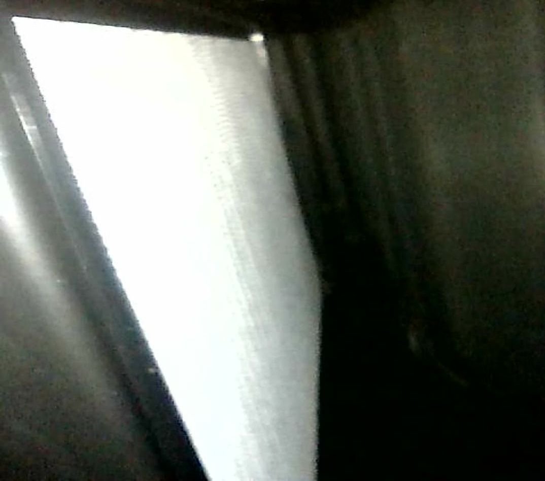

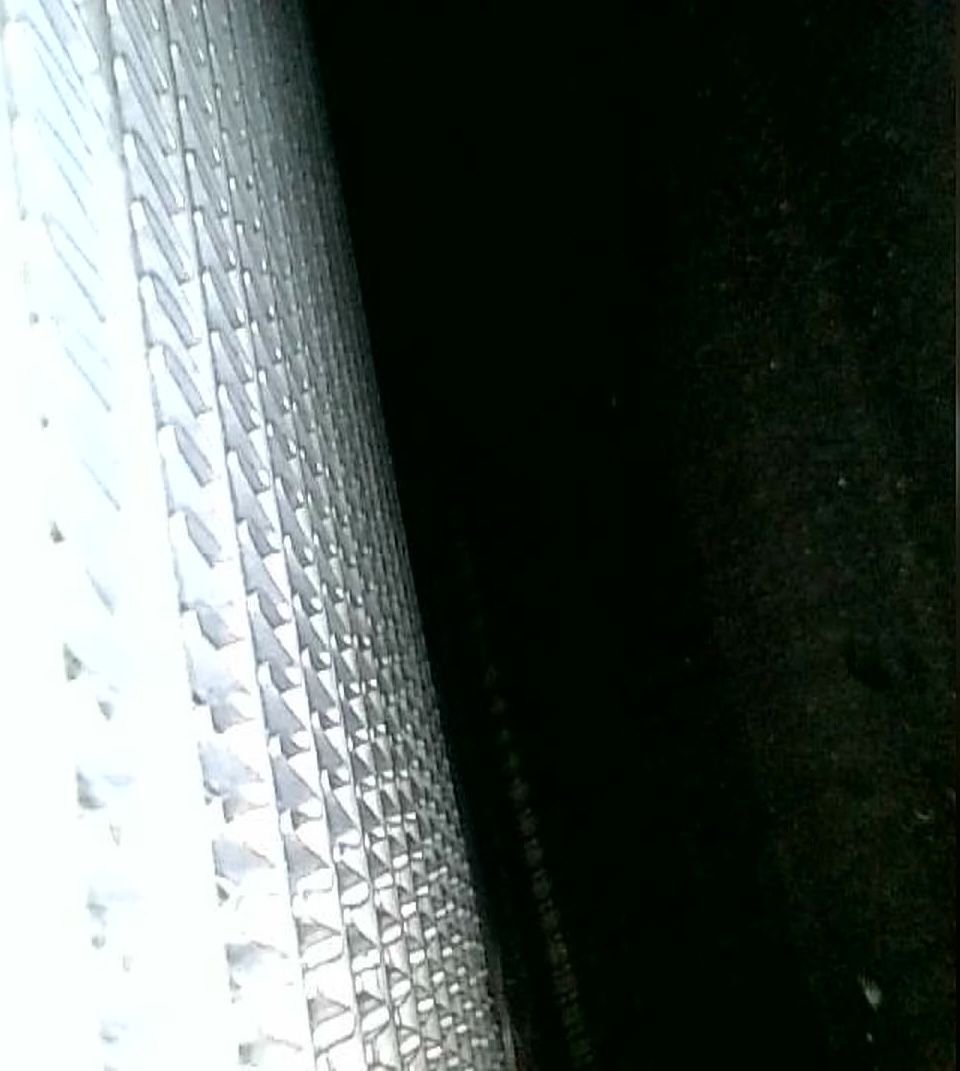

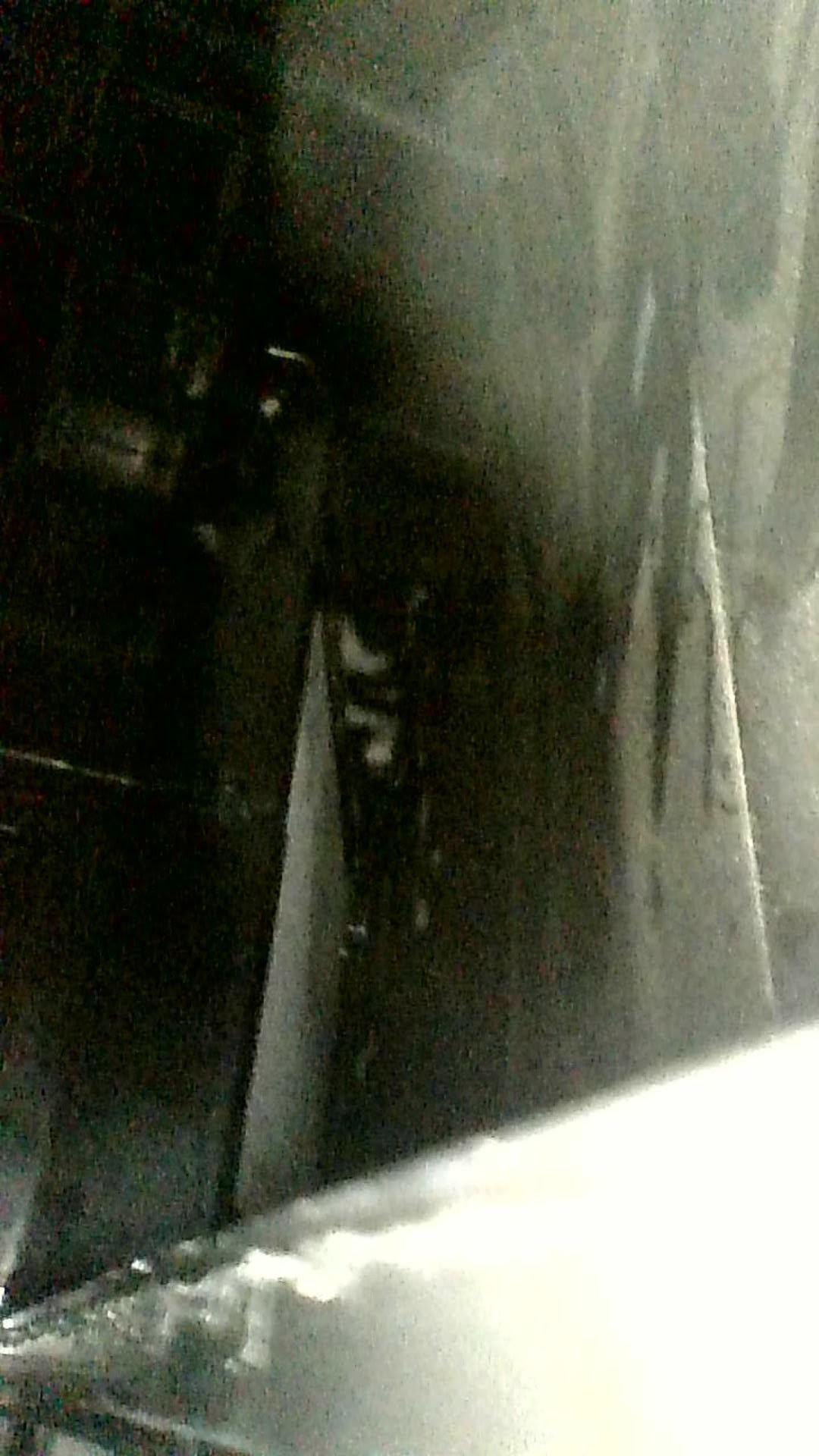

I have no idea why my descriptions for these photos did not post with them. That sucks!!!
my point…
you can’t wash the hvac coil because it’s installed vertically instead of horizontally.
you can’t get to it via dash vents because the duct work is above the vents.
you can’t get to it via the cabin filter chamber. Lives next to the filter, directly behind the hvac control buttons. Think of it is two pictures hanging on the wall next to eachother (filter / hvac coil).
best think to do to prevent odor, when changing cabin filter, spray heavy on the Lysol into the filter chamber towards the center stack of the car before installing the new filter. At least that will give some disinfectant effect for mold/mildew.
ours is 5 years old, 90k miles, many many months in hot humid climate of DC summers and NC coastline. It looks fine, we don’t have too much “gym sock” syndrome. Today fixed what we did have.

Edit: you CAN get to it via the cabin air filter housing.

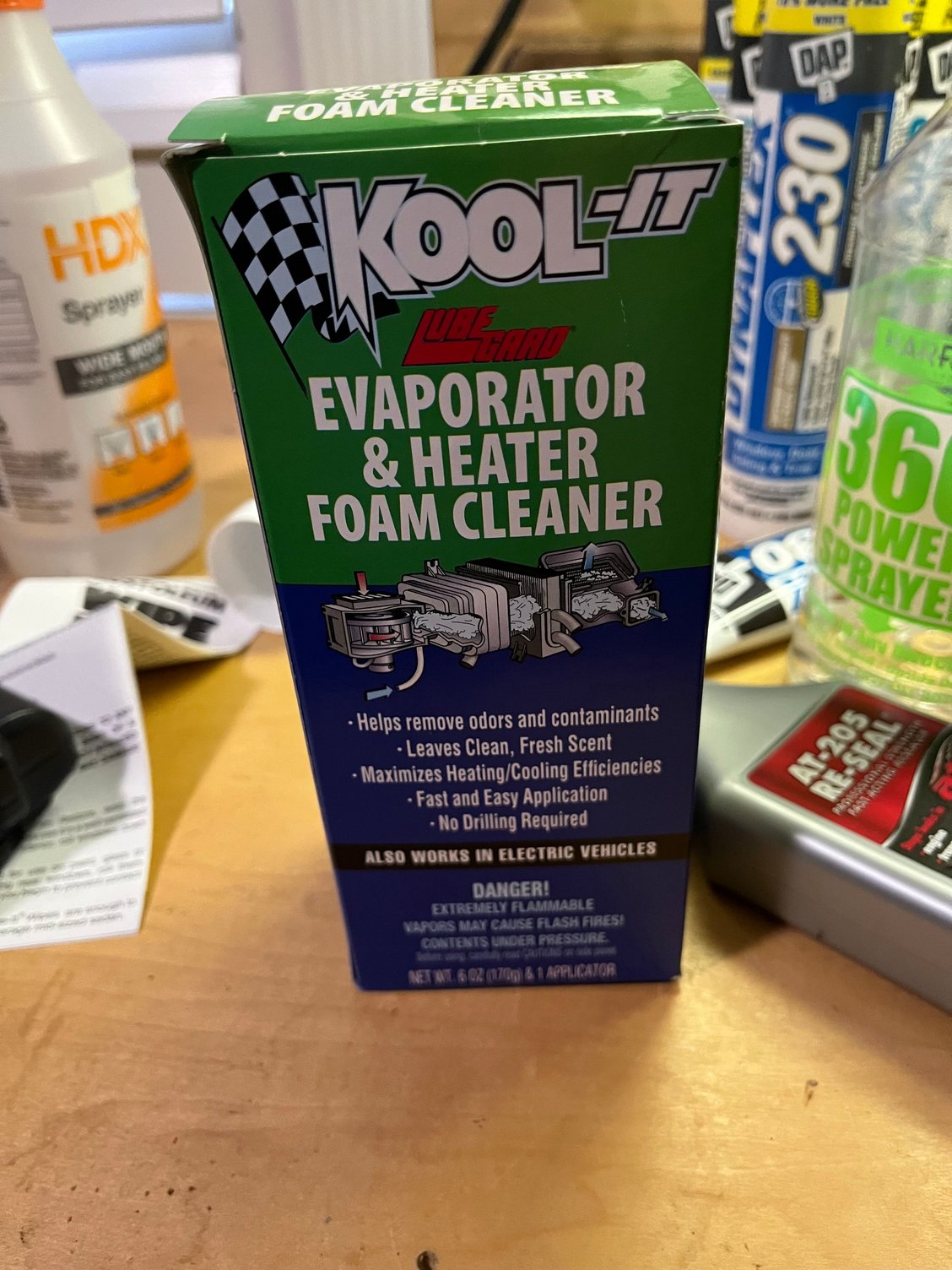

Are you spraying Lysol or Kool It?

The Kool It doesn’t work very well because the coil is vertical and it’s literally impossible to see the coil without a scope camera. Very difficult to do the camera and the hose of the Kool It. So I unloaded a can of Lysol into the opening instead, which too k care of it. Granted not as effective as a wash of the coil that the Kool It does, but also since the coil is vertical, it drains down well and doesn’t get quite as moldy as other cars typically do.
