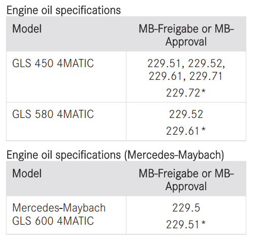

Originally Posted by S_W222
I just checked my Service A visit in July, and I paid $279 for everything...
Sorry if you have stated this before, but what car and engine did you have serviced? 5W-30 seems a little "light", especially if you have a turbo engine. I would want 0W-40 or 5W-40 API SP rated and MB 229.5* approved oil. I've never heard of Mercedes Benz GEO oil.
Anyway, just make sure the oil is appropriate. You can find the specifications for your engine here:
https://operatingfluids.mercedes-benz.com/sheet/223.2
*see link for confirmation

Originally Posted by lungs414
@s w222 What is part 167959A(C) for $89.50
That 89.5 USD is the labor part of it for the X167 engine.
X167 inline-6 is NOT MB 229.5 and this should not be used in the X167 450 (not even for the 580).X167 in-line 6 must use MB 229.51 (or other options below). They are two different specs.
MBenz GEO 5W30 is the MB-Approval 229.52 specification in a 5W-30 viscosity. Looks like they put the right oil. In fact, 0W-40 or 5W-40 that u suggested are very rare for 229.51 modern applications, and even if they are acceptable, Mbenz X167 manual clearly says that it is recommended to use ("lowest SAE viscosity class in each case"). Hence 5W-30 is the best option for the engine in this case for MB 229.51 specs. 0W-40 or 5W-40 are recommended for the GLS 600 but not mentioned for the 450.
Another acceptable option is 0W-20 but only for the 229.72 specification case (but I would only go this route if I live somewhere dominated by 12 months of cold months). 229.51 with 5W-30 has the best balance and well within what the X167 manual recommends.

I can't find my work order right now, but Mercedes changed oil recommendations based on new LSPI concerns.
My shop used the new spec when they changed my AMG53 oil in July '25.
The new spec made many of the old charts obsolete. Mine went from the previous "5WXX" to "0WXX."
Yes, this is why in my post above I was against 0W-40 or 5W-40. I would not go that route no matter what. Also, LSPI is that reason Mercedes has stopped recommending MB 229.5 for its newer 4-cylinder and Inline-6 turbo engines. MB 229.51 is the one recommended now because of LSPI among other options depending on the engine. These newer ones like MB 229.51 and 229.72 all have LSPI-resistant chemical formulas. The recommended viscosity for each should not change. If you go with 229.51 simply take 5W-30, and if u go with 229.72 then 0W-20 is the best option.
Most dealers/techs would go with 0W-20 229.72 cause it is always safe and matches what the manual clearly recommends the thinnest oil that is still within the acceptable specs. If u don't want to be on either extremes (which is my strategy), 229.51 with 5W-30 has the nice balance for those who live in a mixed weather with a few months of warm weather combined with cold months. it is not the absolute thinnest and not the thickest approved oil option for this engine. Both of these are post LSPI dilema and are LSPI-proof

Good info about the newer engines. WRT LSPI, API SP or above is the new formulation to address LSPI risks. Of course, Mercedes may have their own approval code for similar formulations.
I do wonder what is the motivation to move to a 0W-20 oil. We know it should improve gas mileage, etc., but is it good for our engines? Just because it is recommended or specified does not mean it is necessarily the best choice for our engines. There are manufacturers in the US (i.e., GM) that are backing away from 0W-20 due to a higher number of catastrophic engine failures and are now recommending 5W-30. The craziness with low viscosity oils appears to be driven by politics rather than good engineering.
HOWEVER, staying with the recommended viscosities while under warranty is probably prudent, especially if you stay with genuine/OE oil filters and shorter change intervals. My cars are no longer under warranty, so I don't need to worry about that.
Old Dec 8, 2025 | 11:54 AM
  #50
S_W222's Avatar
Joined: Sep 2019
Posts: 3,179
Likes: 1,547
From: U.S.
Current/Last 5-years:GLS;G70;Alpina B8;X7;Accord. Sold:X7,TeslaS;S560;S550,X5;530e;L.Navigator;LS460
One example is the MB (229.51). It is the new designation they use for LSPI (instead of the old MB 229.5).
I agree. This is similar to tire PSI. Manufacturers push for the maximum allowed/safe limit to inflate claimed MPG (especially EVs or V8 ICE cars, it gets crazy and not comfy at all at the recommended limit!). The same applies to oil.. better MPG is achieved with the thinnest allowable oil viscosity. That's why I sometimes run my tires 3-4 PSI lower than recommended (to get the best comfort level possible without damaging the tire), and also prefer an engine oil viscosity that isn't the absolute thinnest or thickest. The 5W-30 is in the sweet spot within the recommended range, not the thinnest allowable oil prioritizing fuel efficiency over wear, and not the thickest either. I still think 5W-40 is out of range though.
