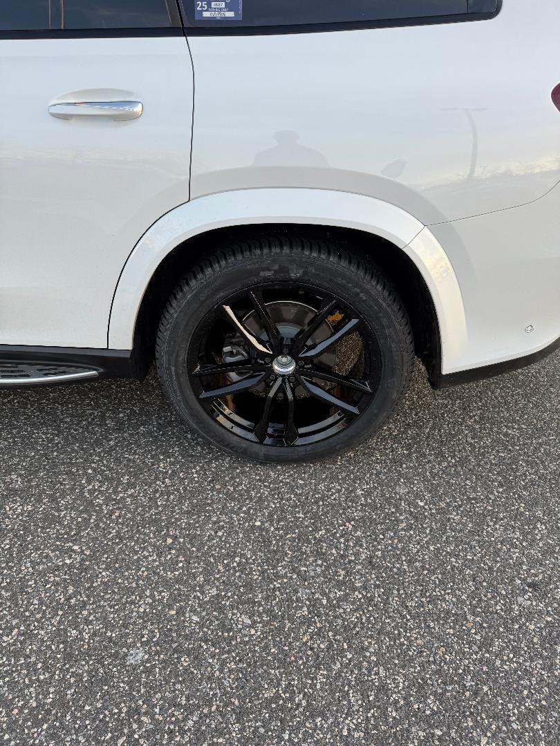

All-season are surely fine even at much lower temperatures. I’ve had all-season on our GLS last winter, and the car was unbelievably stable (so much better than our X7) at temperatures as low as 0 degF, including snow and dry-ice conditions. I also coded Snow mode and it works great on roundabouts and acceleration, and does smooth engine braking. I didn’t see the need for Snow winter with the GLS like other SUVs I had.
I just bought a set of 21” all-season Michelin Primacy Tour A/S tires for our GLS and installed them on Saturday. The SUV tire treads look great! Michelin comfort and noise level are great; I also got a set for the 7-series a few weeks ago.

oh I see. The ones in my picture above are 21”.

I had the 23's. I got new "squared" wheels in 22 x 9.5 45 offset. They are a forged copy of the AMG OEM. Just yesterday had 285/45/22 Michelin Cross climate II put on. I can only say what a difference. Awesome tires. I explained what I did to the Costco installer and he said he put the wheels on the balancing machine before he mounted the tires and told me they were absolutely perfect. That was a relief. Now the rears are tucked in more than I would like but on a recommendation from @Scttq I will be ordering the H&R B46556655 TRAK+® Wheel Spacers.
Huge difference in the ride, so much so that I will be selling the OEM 23's with just under 3K miles. They are in perfect condition if anyone is interested. I had planned on swapping the OEM in spring but I really don't see any need to do so now
