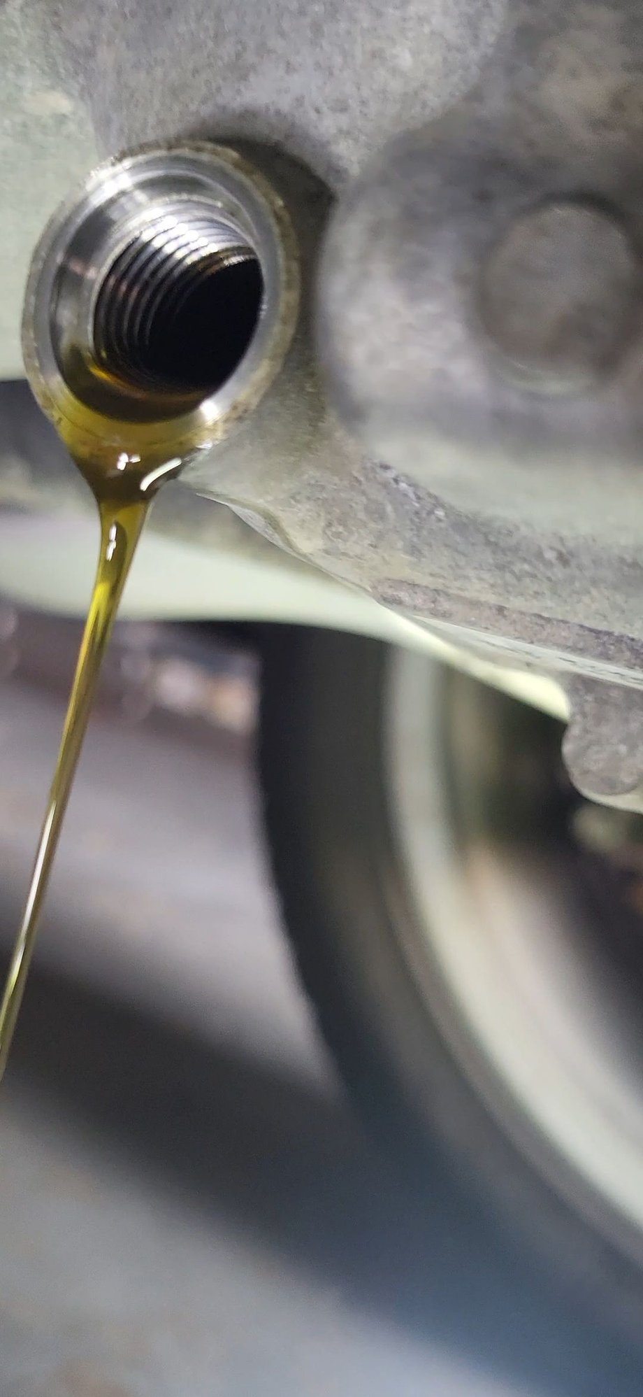

Not looking too bad coming out.

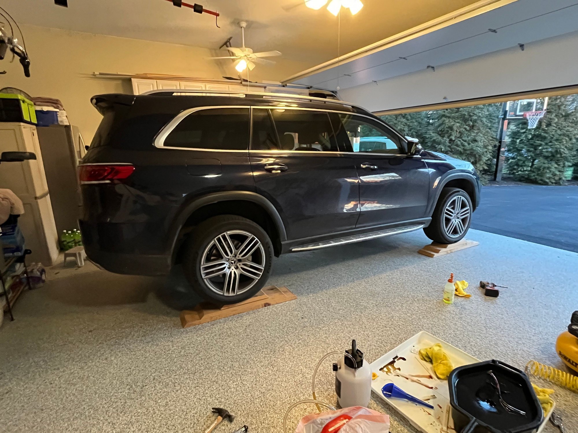

As my best says - “only you, would buy a Benz and put it on blocks”! That all started with an old Lexus LS400 I had 20 years ago. I enjoy it though, but won’t argue against the fact that I’m getting a bit too old for the floor. I don’t bounce up on my feet quite as fast, and usually have to finish it off with a few Advil!
I tried to unseat the 14 Allen from its socket for the rear, but wouldn’t budge. Thankfully the matching 14 crescent was able to do the job via the exposed part of the socket.
Photo was when I was doing the transfer case. Leaned it to the driver’s side, access via the passenger side.
Only time I’ve ever used “off road” mode too! Helps with lifting it up a couple more inches for my fat as$ to get under it!
Gave it a bath today to get all of the dried road salt off it (tons)! Which reminds me - I saw not a spec of flash rust anywhere underneath. Thing still looks brand new under there from front to back. Pretty impressive! Even the original brake rotor hats still look new!

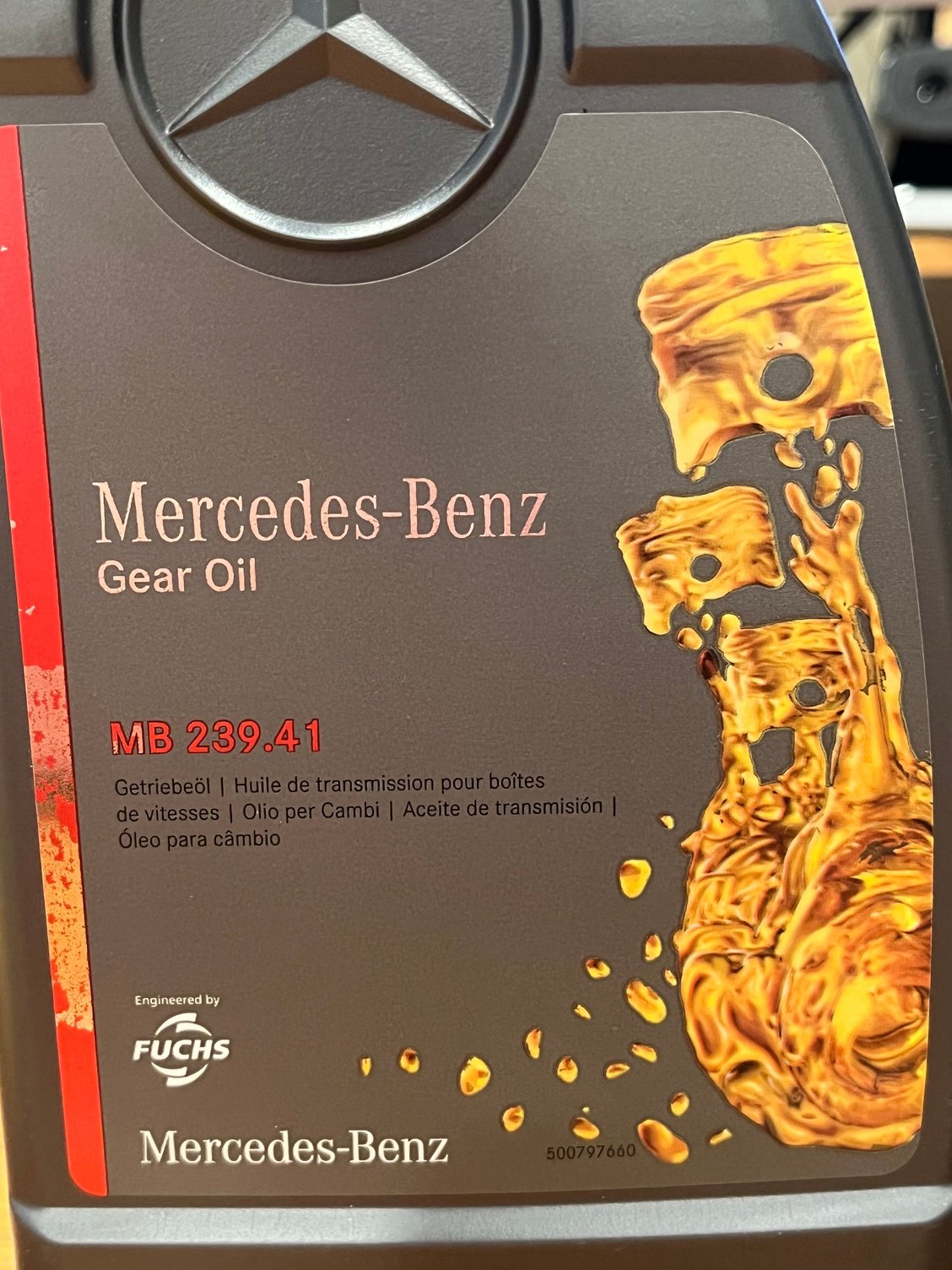

Hi, I have same problem on my GLC Coupe after I replaced factory oil by Fuchs Titan Sintopoid FE 75W-85 which has 235.7 and 235.74 aprovals by MB for front differential, but it is just RECOMMENDED for rear differential by Fuchs (239.71). One forum member had same problem after using Fuchs oil and solved it by replacing it with genuine oil 239.71. Some members let it work and noise disappeared. Do you have this problem after replacing oil (which oil) or with genuine factory oil?

I'm thinking I just have the wrong fluids somewhere. I went back to those YouTube videos I posted further up in this thread. I paused on the fluid he's using - Redline 75w-85 FOR LIMITED SLIP. Me adding the Liqui Moly would make the problem worse, as it's specifically not for Limited Slip.
I pulled up the Fuchs site on the bottle I used, and have some questions on it. It too says it can be used for limited slip. But Mercedes Benz tells me I do not have a limited slip rear differential. So. Something is wrong here. Lost in the confusion. Time to throw in the towel. GD Mercedes and their overly complicated BS.
