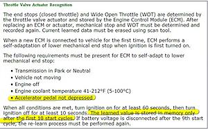

The first thing you should do is have someone stand behind the truck and while in drive release the brake pedal and have the person tell you if the brake lights go off exactly when you release the pedal. Do this a number of times to make sure. If the brake lights remain on then the Traction Control Module senses that the truck should not be moving and the delay will occur until the brake lights go off.
If that is not the problem then try this relearn procedure for the throttle. If that doesn't work then you will have to see if there are any codes stored, regardless if the CEL is not illuminated.
