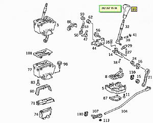

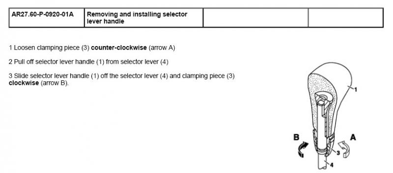

Here is the part #202 267 15 10 and how to remove it.
