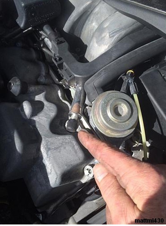

The problem is fuel pressure leak down. You will need a fuel pressure gauge. With the gauge attached, run the eng. for a minute and turn off eng.
Then monitor the gauge following the PDF instructions.
Attached Thumbnails Hard start after hard driving-fuel-pressure-gauge.jpg   Hard start after hard driving-fuel-pressure-test-port.jpg
