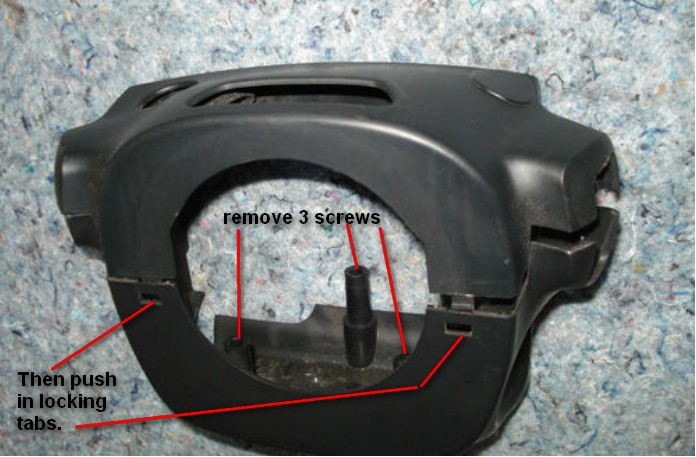

I strongly urge you to get a new lock cylinder from a M/B dealer ASAP. The new cyl. will be coded to your present remote key and your valet key. So what you should do right now is to turn the key to pos. #1, leave it in that position and disconnect the NEGATIVE battery cable until after the cyl. is installed.
The registered owner must appear at the dealer with registration, title and license and fill out a form. It will take approx. 5 days for the cyl. to be sent to the dealer, and the dealer might insist on installing it. Lie to him and state that the cyl. will only turn very little but cannot be started.
Again, if you do not turn the cyl. to pos. #1 NOW, you might not get another opportunity to do so.
Attached Thumbnails 99 ml 430 ignition sticking & truck not starting from security shut off-r-i-steering-column-covers.jpg
