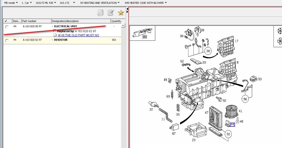

I could use some help with an issue I have with my 1999 ML430 Heating/Cooling Fan. It works just fine on setting 3 & 4 the faster speeds, but won't run on setting 1 & 2 the slower speeds. I'm guessing it may be a issue with resistors? Dundee has offered to assist, and I thank him in advance. I'm just getting back onto the forum after a few years away, Thanks, Lonn'e

The problem is with the blower resistor.
Attached Thumbnails Heater/Cooling Fan Issues...-2017-05-06_034136.jpg
