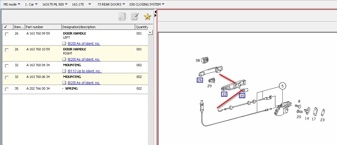

On my 2005 ML500 SE, rear door on passenger side, I can't open it from outside door handle but only from the inside door latch. Does anyone know what's the problem?

Obviously there is something broken with the outside door handle opening mechanism. You will have to remove the door panel and see which part needs replacing.
