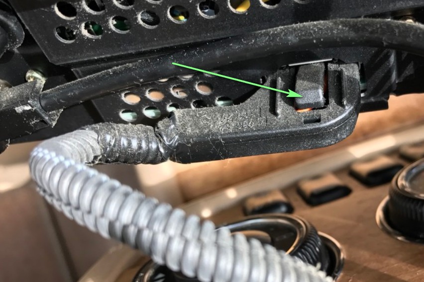

After some quick research I learned that some years of the W163 come with a fiber optic system that makes it a bit more difficult to install an aftermarket radio.
Can you guys take a look at the back of my radio ( pictures below ) and tell me if this is the fiber optic one? There is a fiber cable plugged into the back of it, but my 2001 E430 had a cable just like that for the CD changer only
Here is the back of my radio
My goal here is to remove the CD changer and factory head unit, and install an Apple car play head unit. I'd like to integrate with the factory bose amp if possible. My w210 e430 could do that easily, but I understand that if I have the fiber system that will not be possible.

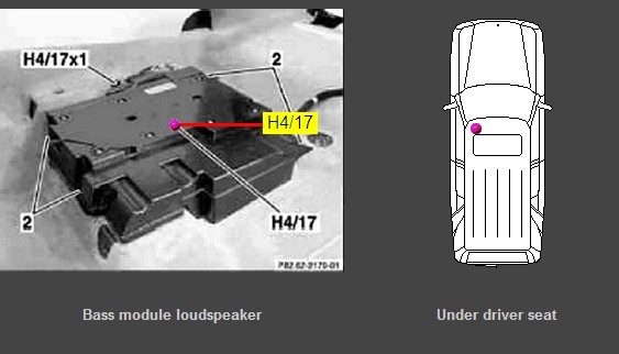

Second question- My factory bose system works great, except I have no sound coming from the subwoofer, which I was told is under one of the front seats. All other speakers work properly. I have what seems to be an air vent on the side of the lower plastic trim on the front passenger seat. I assume the subwoofer is under there.
Is this a common issue with these bose systems? Is it as simple as a blown fuse?
Third question for now- What is the actual location of the bose amp? I've read conflicting opinions that it is located either up under the driver side dashboard, or under one of the front seats.

Good looking ML congrats! Your radio system is a fiber optic unit. I just replaced my radio with a new head unit and just ran wires from the new radio to the speakers. There are some adapters that will allow you to use your Bose amp, however I did not use one.

Fiber optic connection (photo).
Sub-woofer is under the driver's seat.
Amp is high-up under the driver's firewall.
