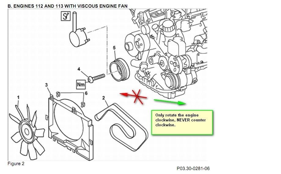

The counterholder tool is necessary for two reasons, #1 so you may remove the bolt which is torqued at 200 Nm and #2 so you do not turn the engine counter clockwise. Eng. should only be turned in the clockwise position or else there will be eng. damage.
