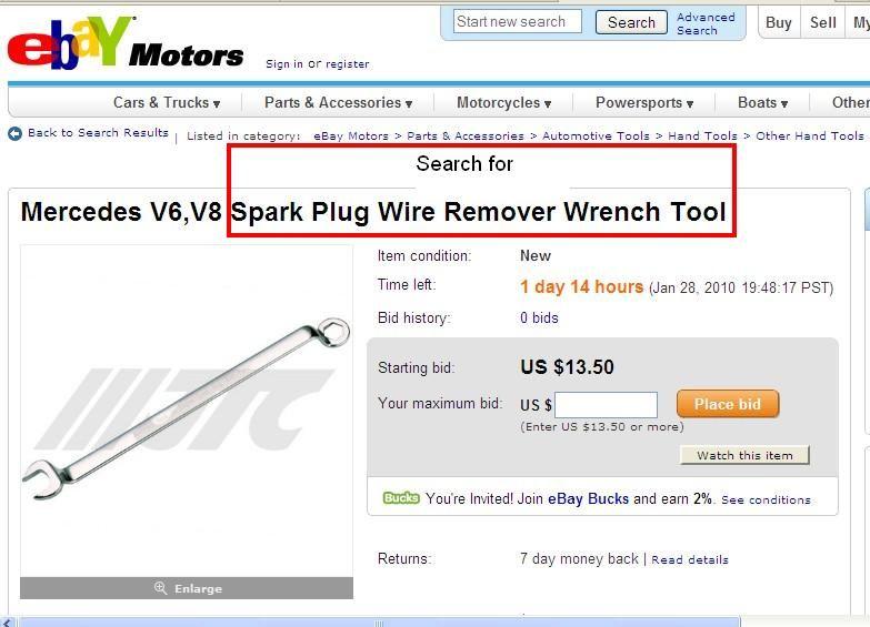

Here are the procedures. Also, purchase spark plug wire removal tool.
