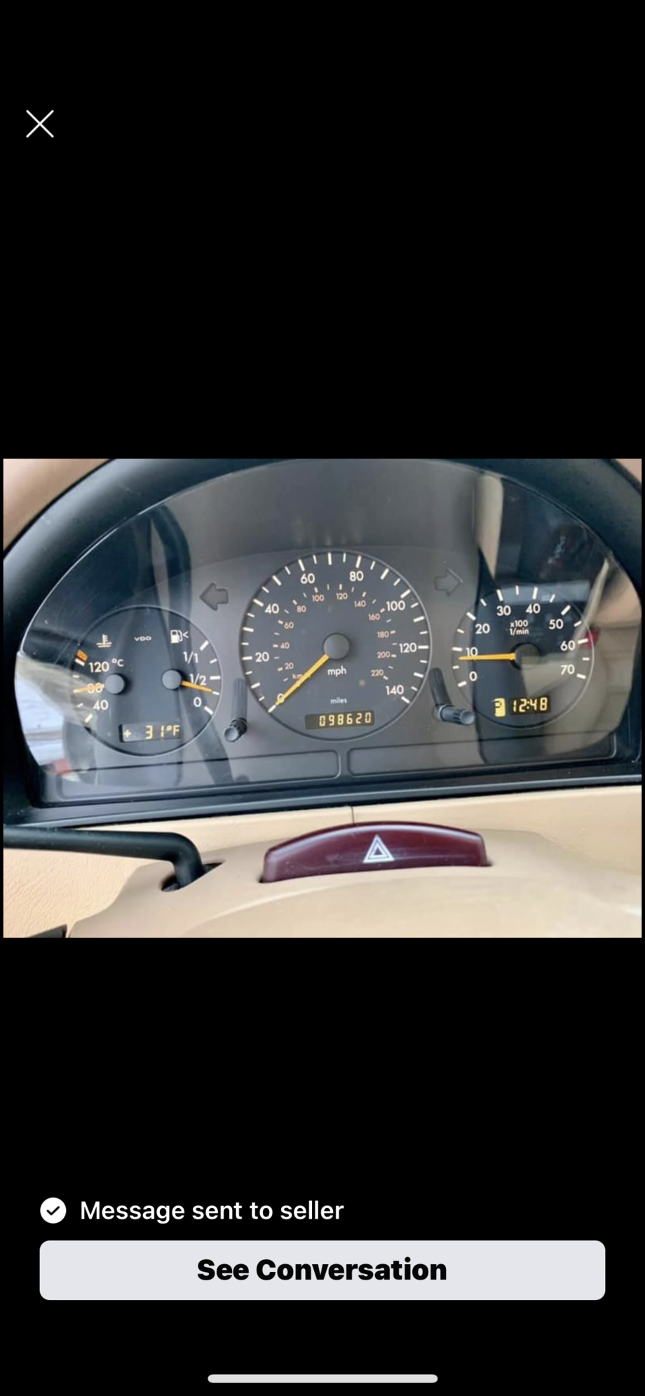

I am now looking for a winter car for work and have found a 2001 ML320 leather with nav from a private owner and he's asking $4400 but got him down to possibly $3600. Needs tires no dash lights, car came from California and a dime sized rust spot rear quarter just bubble under paint. Car has 98,000 original miles. Has some scratches and nicks in paint and key fobs have seen better days. Should I try and make this deal or maybe go lower? Don't know much about the 320 so that's why I'm posting here. Any input appreciated! Here are couple pics.

Low miles for the age.
It's a 20 year old vehicle, caveat emptor. Are you extremely handy with DIY car repairs? Or do you have a deep wallet to spend at an indy repair shop or dealer?
The 3.2L inline 6 was widely used in its day. It seems average or above-average reliable, for a Mercedes. Mercedes are generally far below average in the reliability arena.
Rust on turn of the century Mercedes is/was common. Rust on 20 year old vehicles is more common than on 10 year old vehicles. There is likely alot of rust under the vehicle, which doesn't mean to say all of it is critical. Just be aware.
Do you intend to use the ML as a daily driver, or a fun/weekend/farm/project car?
Depending on the answers to the questions above, and the results of a complete and thorough inspection, it could be a beneficial transaction or it could be a trail of tears.
