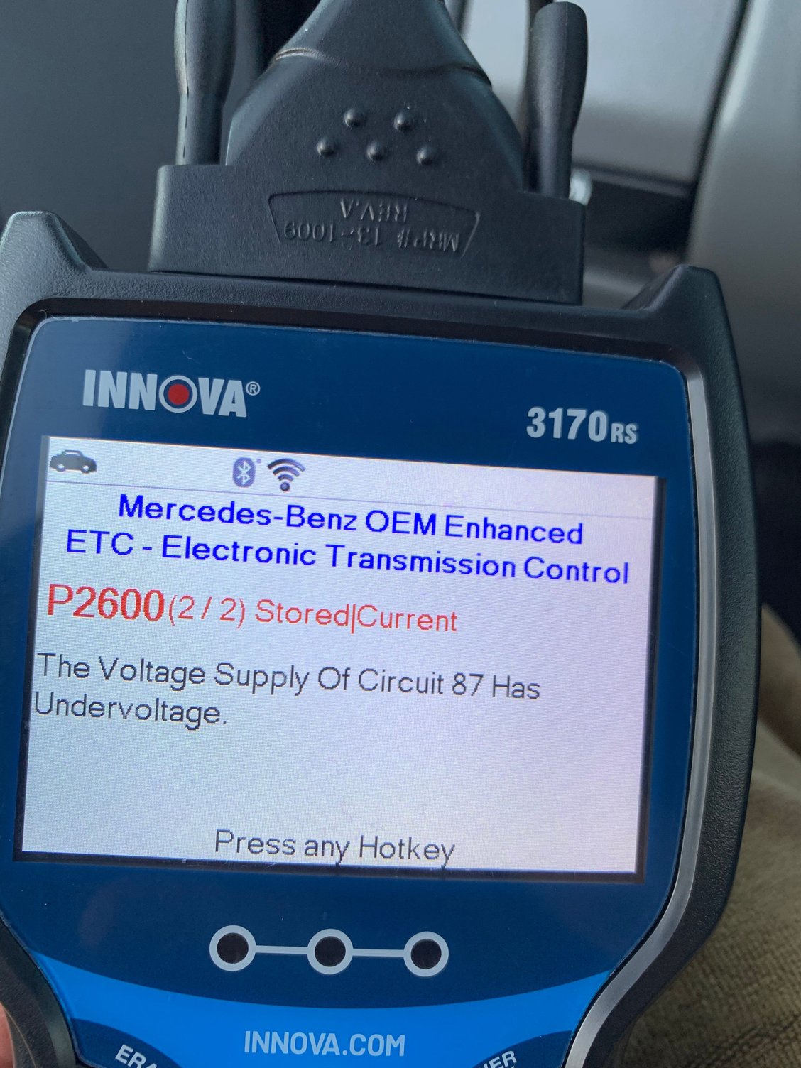

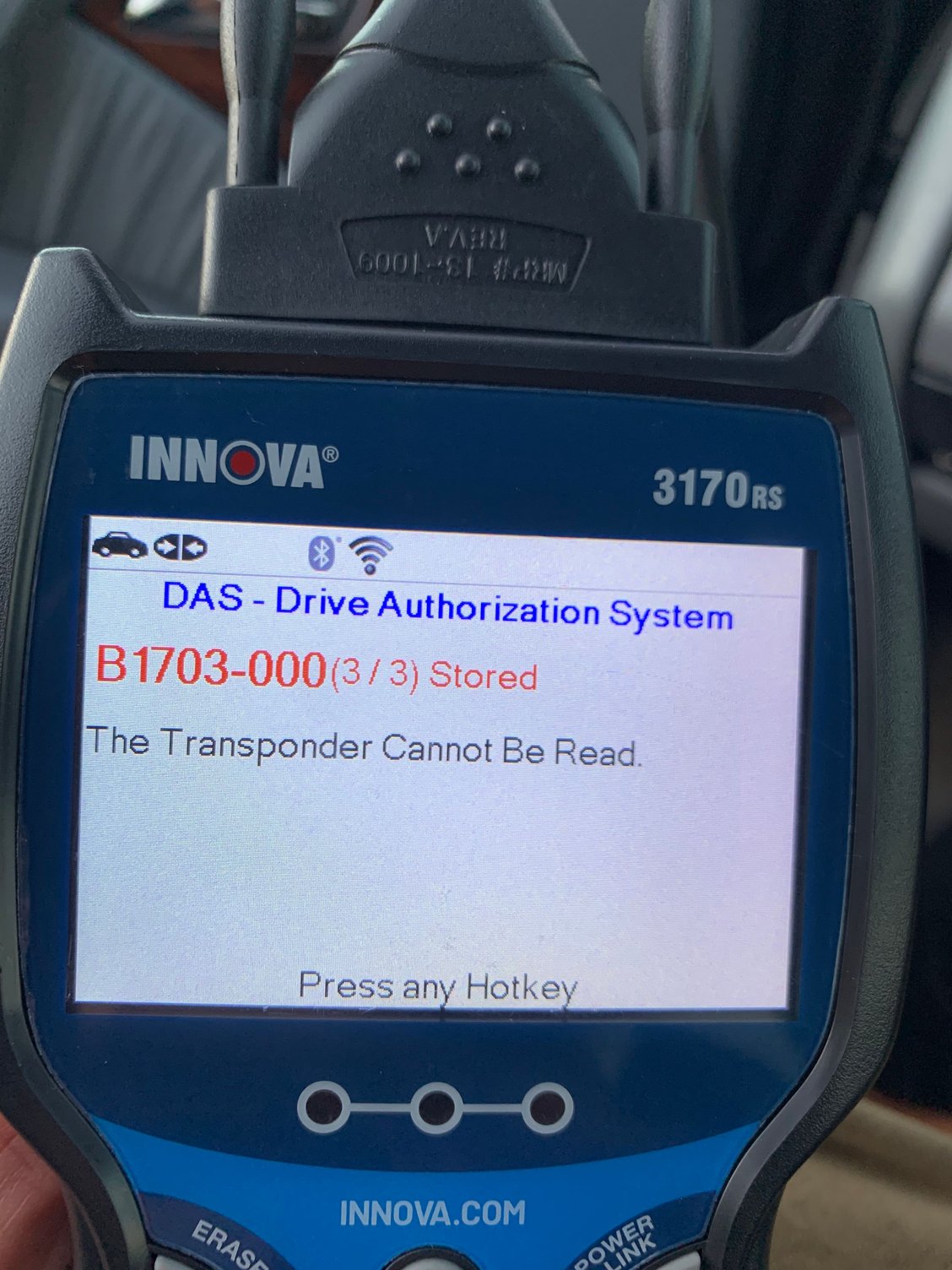

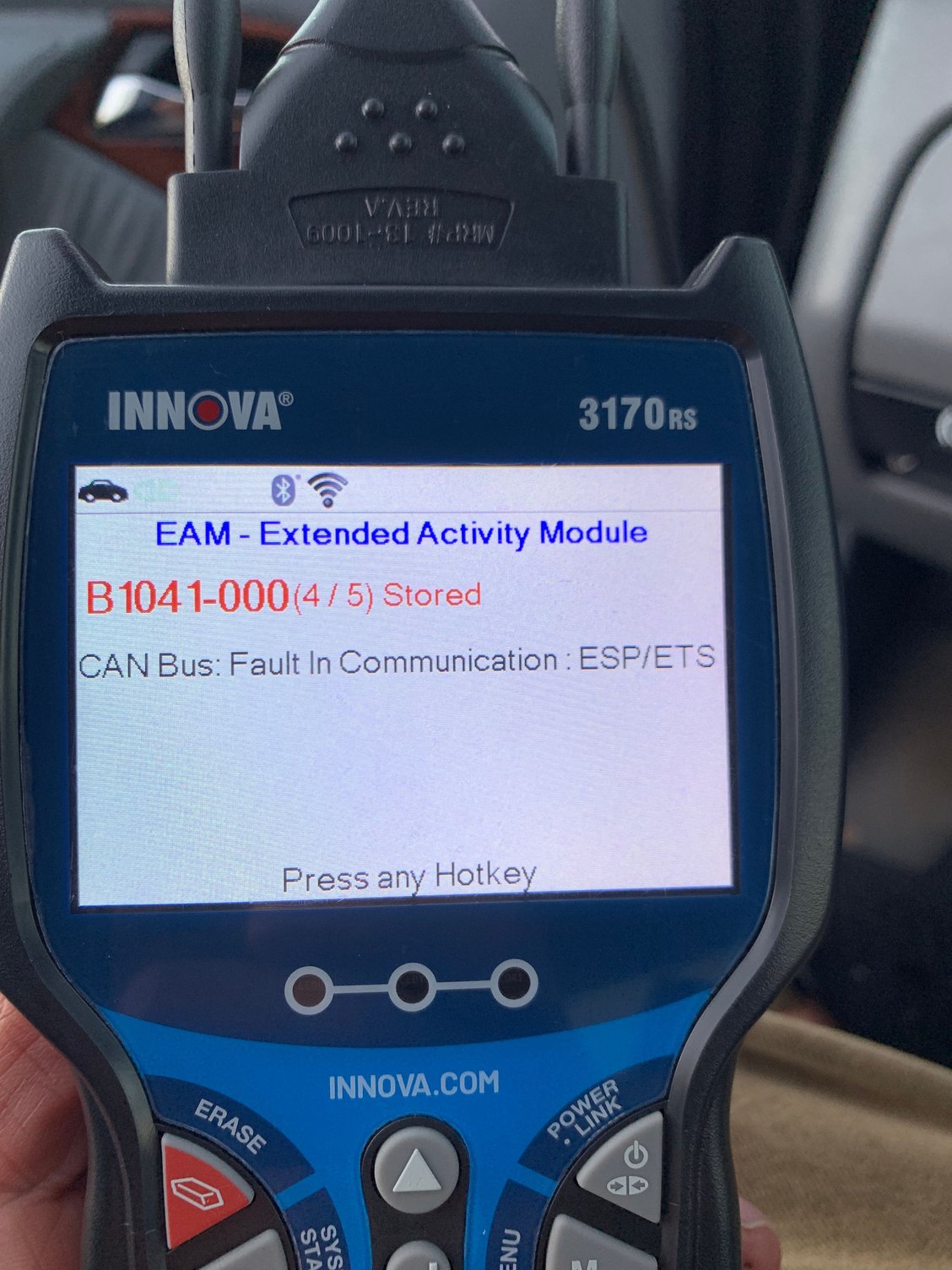

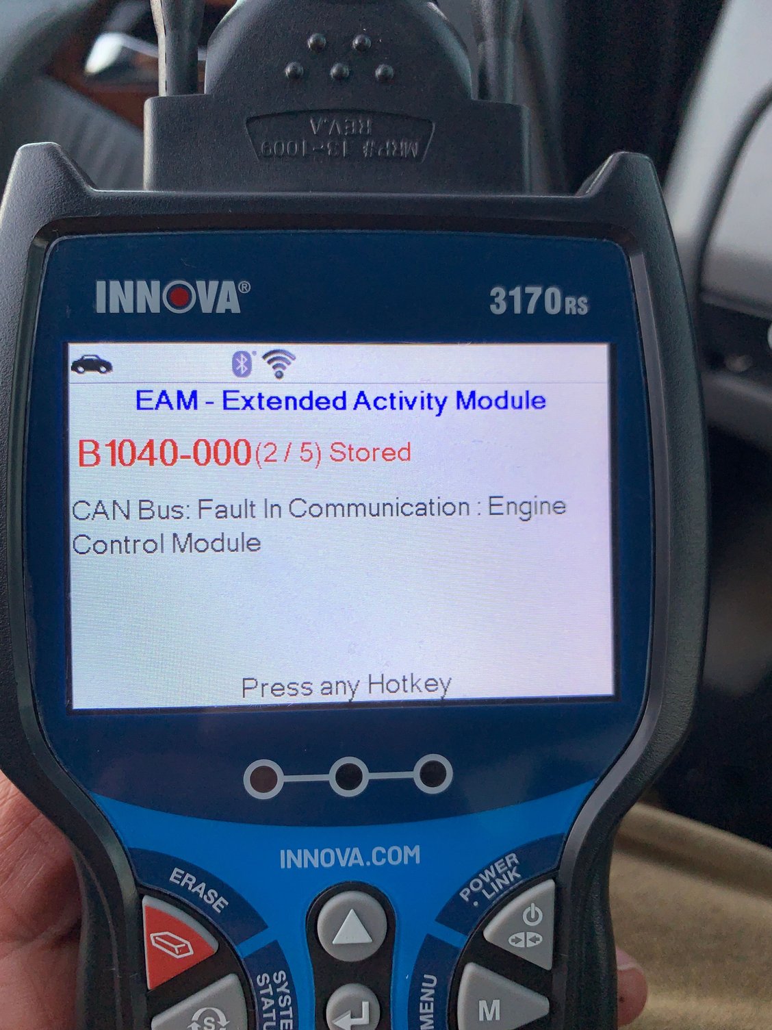

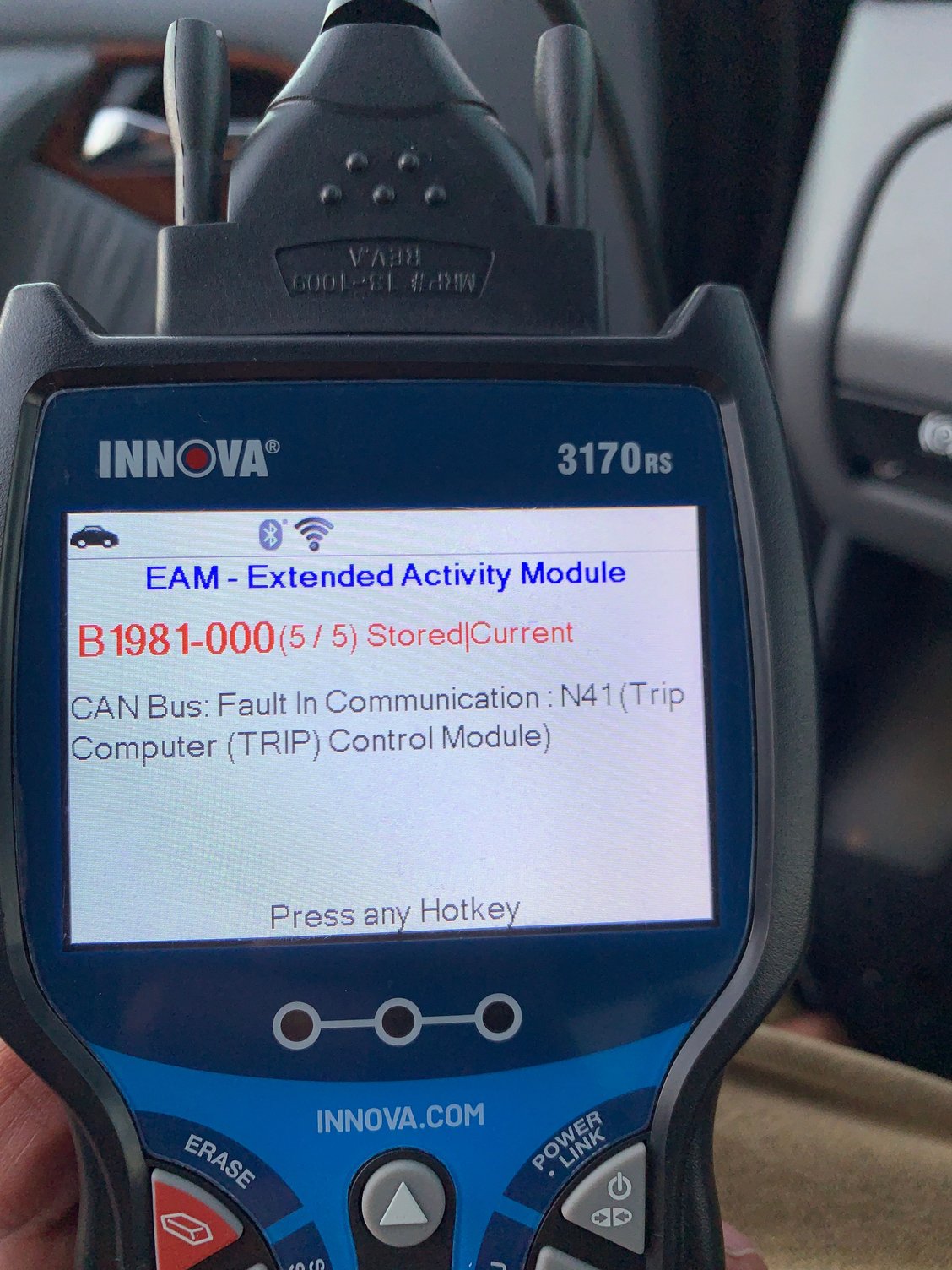

I have a 2002 ml320 just reached 180k. A couple of days ago I installed new downstream 02 sensor. The install was easy but I might have made a rookie mistake trying to test the old 02 sensor with multimeter and key in position 2. It had no charge so I took the key out and took the old sensor off and replaced it with the new one.
When trying to start the car it just clicked and instead of the battery icon on the dash I got the srs light.. I then tried to do the ecu reset using the gas pedal technique a few times but it didn’t work, my aftermarket radio comes on in position 1 then it starts blinking in and out. I tried charging the battery then the car started but after a few minutes the radio went out and abs, srs, esp, and bas lights all came on smh. When I turned the truck off it wouldn’t start again and now the instrument cluster only shows the battery icon and srs light.
I went out and purchased a $300 scanner but of course it wasn’t the srs scan wouldn’t work. Any suggestions, I’m really trying to avoid the dealership.
I disconnected the battery to see if the computer will remember things but I think that made it worse. Windows don’t work, locks don’t work, but inside lights still come on. Here are some of the codes I got. I’m lost in the sauce.
