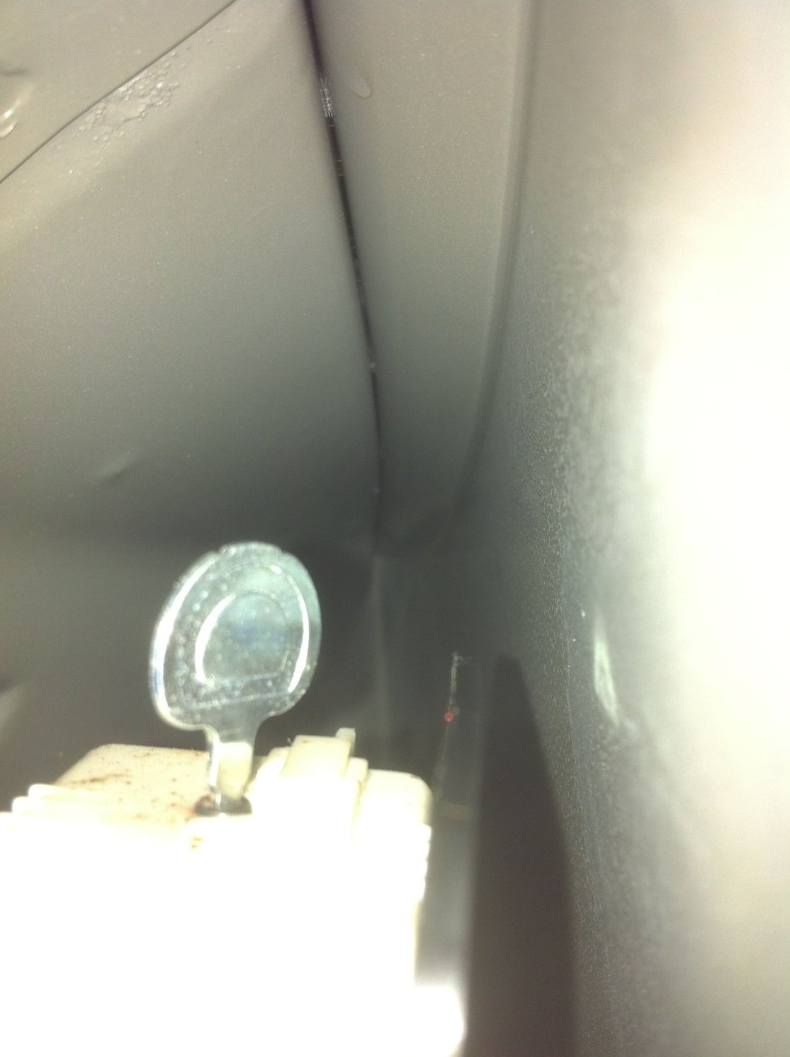

2004 ML350 fuel door release
For the sake of people in future who may have a similar problem, here is a photo of the manual release tab on the fuel door actuator. It seems quite lightweight, and as such I was reluctant to use much pressure until I knew what movement (clockwise) was required.
