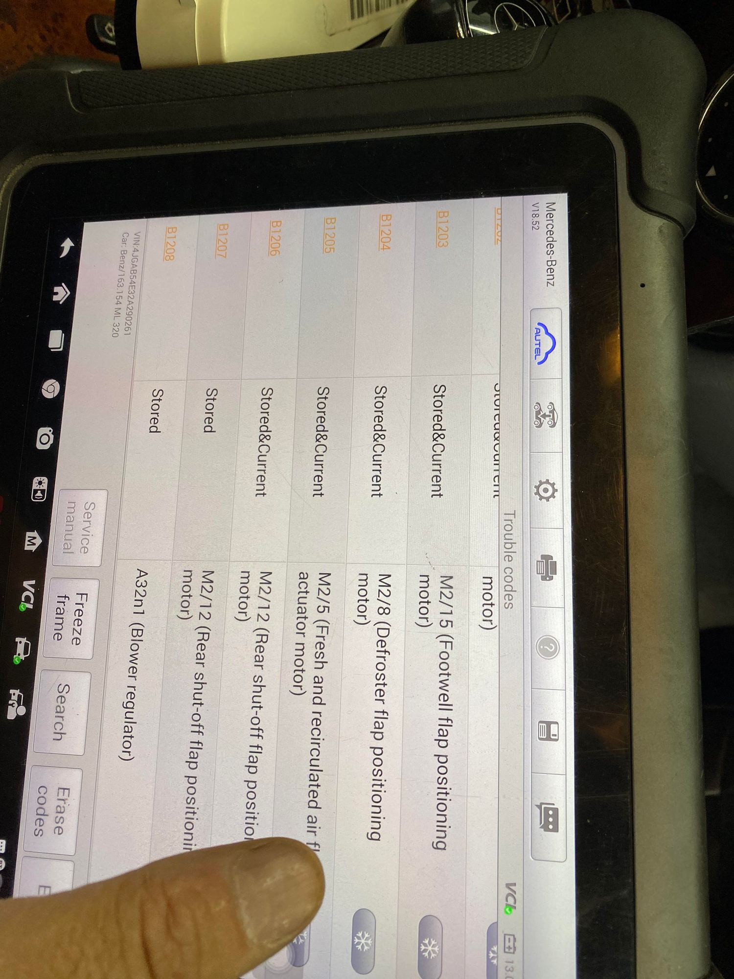

  1. My AC quit working on me a few months ago. Took it to my mechanic who hooked up a code reader & among other errors he could see an "AC compressor" error code.
  2. So, he changed the AC compressor and recharged the gas, but no AC
  3. He recommended I take it to an electrical expert who sent 12V through the compressor line directly (back of the AAC panel) and the compressor clicked on, but the AAC panel would not send 12v.
  4. So, the electrical expert suggested that I get a new AAC panel, which I did from Ebay.
  5. New AAC panel wouldn't turn on the AC either - so I gave up for the time being.
  6. Electrical guy took screenshots of the error codes & gave them to me (attached to this post)

  9. Then it clicked to my thick skull that it was one of the errors that was on my photos from the electrical guy (B1108)

Error codes screenshot 1
Error codes screenshot 2
