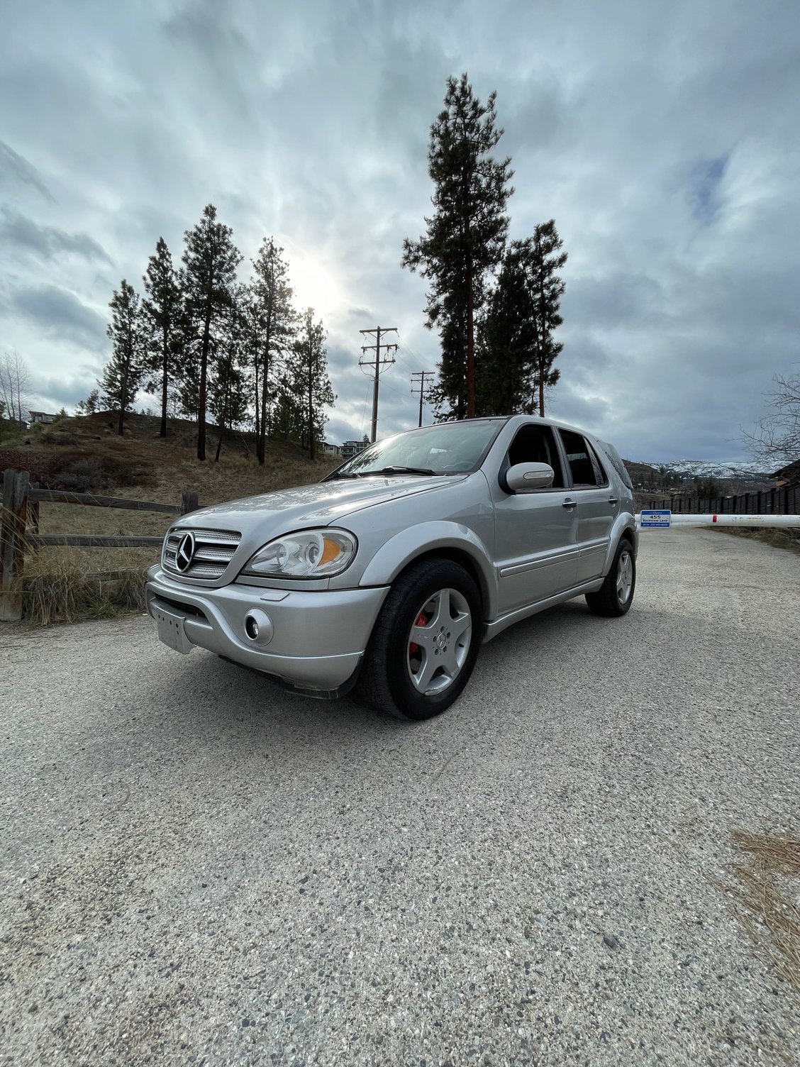

Hello all,
i am the recent owner of a 2002 ML55 and I’ve been having a few issues with water leakage and angry electronics. Every time it rains, I have water sitting in the passenger side floor mat. Was simply wondering if anyone else has had this issue and how to fix it.
Secondly, and it may be connected to the water leak the instrument cluster displays the esp and bas, ets, airbag off, srs, and parking brake light while driving. Sometimes the lights will turn off and I can test that the parking brake sensor is working properly. So it has moments of the angry electrical where the lights are on, and the moments of working properly. I pulled the codes for the all activity module with no fault codes being read and the codes for the extended activity module with a bad can bus connection for the instrument cluster and trip computer. I’ve tried looking for where the eam is located with no luck.
any help is appreciated
So pretty
